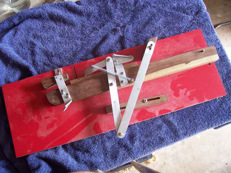

Post by DarwinStrings » Fri Jan 02, 2009 11:49 am
What do you do when you can not glue.
The Ksled looked great to me but as my Band Saw doesn't have a mitre slot I needed another way to get it to work and swinging it seemed to be the way to go. The radius of the swing is 330mm so you don't notice a curve in the Kerf.
May you never get RSI while Kerfing your Linings

Very cool work around Jim, well done M8. 8)

Nice one! How about a YouTube video to show it in action?

Brilliant Jim!!!!
