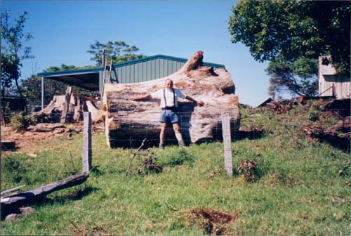

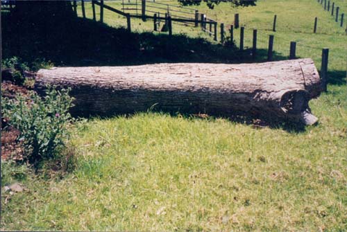

After the response for the Camphor Ukuleles I thought I would post a few Pics to show where it came from.This tree was planted by my friends Grandfather 80 years ago.It had to be removed to make way for a new shed that some large limbs would overhang.The branch in the photo was 4.2m long and 900mm diameter at the butt end.The branch was milled into stair making sizes for a planned extension into the huge roof space of the original farmhouse.This included 300x50 (12x2)for step treads and stringers and 125x125 (5x5) for newell posts.The log itself was 5.5m circumference at shoulder height and it was cut at about 3m (10ft)It was milled into mostly 200x100 (8x4)and 200x50 (8x2) boards.I used to think it would make a lot of furniture but that was before I discovered Instrument building.Now I wonder how many ukes and guitars it will yield.

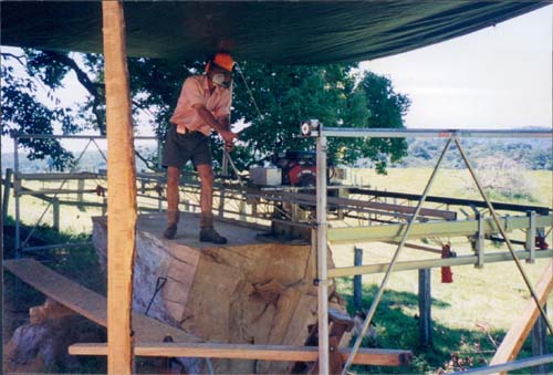

For the first cuts Nicholas had to walk along the plank between 2 saw stools with the mill handle at head height.That was after we set the mill up on blocks to reach over the log.

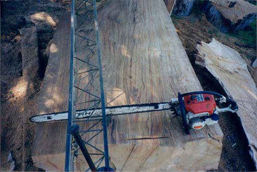

The bar on the chainsaw is 1220mm (4ft)long.Plus the motor.

Arent those mobile mills marvelous, I saw one at the Sydney WWW shows a few years ago, makes a lot of timber availible that would either feed termites of slow cookers.

the brute strength of the man..
thats amazing how he's taking the weight of that trunk and stopping it rolling down the hill.

That's really amazing for 80 years growth. Looks like it could be 300 years old from the size. Does everything in Oz grow to such huge proportions? If so, remind me never to get into a pissing contest with an Aussie! :lol:
