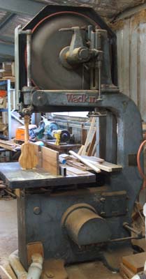

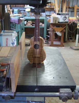

I have a secondhand bandsaw now. The best $85 I have ever sent!! I have achieved over the past three days what usually would take me three weekends. I'm a happy man. :D

What a big jump forward on 3 days, looks great. It is amazing just how helpful a bandsaw can be and the GMC looks just right for a Ksled Kerfing Jig :D

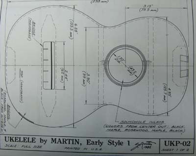

Nice job Alan.The 2mm top is no worries.Not sure what plan you have but for my last sopranos I deleted the fan braces and just went with a longish bridge patch.The sound is louder and rings nicely.Early Mahogany Martins were braced that way.
As Crocodile Dundee would say "That's not a bandsaw THIS is a BANDSAW"

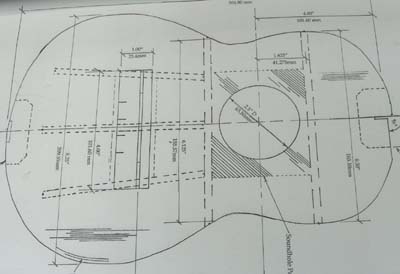

Yep I noticed you did away with the fan braces. Did you laminate the bridge patch and what thichness was yours? BTW i'm following the Scott Antes plan.

That is the Exact same Bandsaw that I use to resaw any wood I collect locally Micheal, Except that my mates one has a new motor and yours looks like it is the original motor. A thing of beauty if you ask me. He was going to buy a bigger one that was up for auction here but the expense of digging a hole in his floor for the bottom wheel and then re-concreting convinced him that his Wadkin is big enough.

Alan ,The first plan is a Tenor and the Martin is a soprano.Even in my original builds I did away with the sound hole patch.The bridge patch is 2.5mm and follows the tapered shape on the plan.

Micheal, you might want to re-visit the soundhole patch issue. I've seen literally dozens of Kamaka ukuleles with cracks at the soundhole edges because they had no patch...

Would you also put a sound hole patch on a soprano uke David?

Yes, Allen, I put a soundhole patch in all ukulele sizes including sopranos. My goodnes, you've just put a great hole in a rather thin top, haven't you? Why shouldn't it crack when you have a change of weather?
Hip, you could use the graphite carbon, but I like to make a curved edge to the soundhole, so a little thickness makes it easier. Sharp edges aren't beloved of air movement...

The top and back braced. The top may need the two fan braces because it dosen't feel stiff enough to me? What do you all reckon?

In what direction do you think the sound board isn't stiff enough? Across the lower bout, or top to bottom?

Allen it's top to bottom, along the grain that worries me. This set of Bunya was never nice and stiff as I would have prefered. I have another uke set that is stiff from the same guitar top. I don't have the experience using wood either so now is the time to learn aye!

I think a bunch of us that are building ukes right now are on a steep learning curve. But it seems to me that with such a small sound board and low tension, we can get away with a much more flexible soundboard.

The top needs to be stiffened up. I thought maybe a rosewood seam patch maybe enough to do the trick. I also thought maybe two sound hole flat braces say 2mm by 5mm wide like we use you see on most guitar top designs would work too! The top has a good tap tone now even with the braces un-carved.
