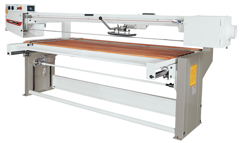

While I was looking to see if there was an interesting used alternative on ebay, I came across this table sander? I looked at the photos and couldn’t figure it out, I tried turning my monitor on its side, didn’t help. So if you’re tool curious and think you can figure it out here is description and then the link. It was at a cool $10 but a week to go. If anyone knows how it works… please explain.
UP FOR ACTION I HAVE THIS TABLE SANDER. I BOUGHT IT TO RESUFACE A COUPLE HUNDRED DAMAGED HARD WOOD TABLES BACK TO BARE TIMBER TO BE BOUGHT BACKTO BRAND NEW. IVE SANDED DOORS AND OTHER FURNITURE I MADE . NOTHING ELSE LEFT TO SAND SO ITS GOT TO GO I HAVE OWNED IT FOR20 YEARS & ITS NEVER LET ME DOWN I HAVE APROX 8 BELTS 40 80 120 GRADE SOME USED SOME NEW THE SET UP I HAD WITH THESE BELTS COULD SAND 2100X 1800MM WITH LONGER BELTS YOU COULD EASLY SAND 2400 EVEN 3000mm. THE WORK TABLE IS FULLY AJUSTABLE AND THE WHOLE THING IS VERY EASY TO USE ,IT ALSO HAS A DUST EXTRACTION UNIT THAT RUNS OF A PULLEY FROM THE MAIN MOTOR YOU CAN STOP THE FAN BY REMOVING THE BELT ITS A SIMPLE DESIGN THAT WORKS WELL I NEVER USED A DUST BAG & I DONT HAVE ONE

It looks like a stroke sander to me. The belt is very long and rotates at a slower speed. The belt sits over the table with the grit to the outside. You place the item to be sanded on the table, then use a wooden caul to gently press the rotating belt down onto the piece you want to sand. Good for a cabinet maker, but pretty well useless for luthier.

This might help with a Stroke Sander description James.

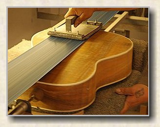

I also found this Allen and your comment came to mind, I guess this guy had made an error while making the back for his guitar and needed to remove it to put a new one on.
I suppose if it was some micromesh belt, and some very deft use of the caul, it should work on the flat surfaces. It looks like he's got some sheep skin for an interface pad on the sanding caul. But damn, you could do a lot of damage quick smart.
