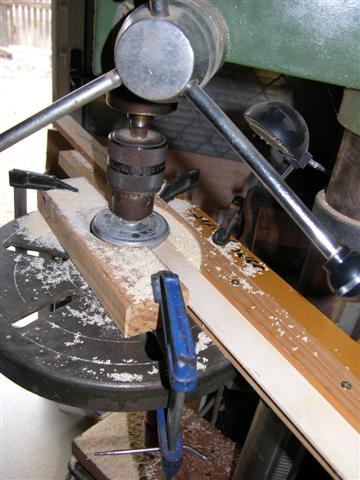

I like the concept Hip . Thanks for posting this . Which do you move/swing ,, the table or the drill head ? A truly flat surface isn't easy to achieve. This looks like it may do the job . As the proof is in the pudding , how flat did it end up ?

The idea is to swivel the drill head. Loosening the table drops it down slightly, which probably also tilts it. Soon as I get the machine level and stable I can do the job.

Hip, I see your set-up as more a virtual milling machine rather than CNC. You'd want to hope the drill head swivels in a very parallel way ,and very smoothly. I have my doubts somehow.
You may be better off fixing a reliably flat table to you drill press. Check that the table is at a true 90 degree to the machine. Rather than move the drill head ,have the neck make passes under the fixed cutter by sliding it along the flat table.
Here's my fixture which I'm hoping may help
The table is made from 1 " pattern makers ply ( as mentioned earlier) ,topped with MDF, and finally a durable thin work surface. This flush bolts to the press table with wing nuts underneath
Have the chuck locked up in the fixed position to avoid any play in the quil. For the final fine cut , adjust the hieght of the material by placing a sheet/s of paper beneath the wood to be thicknessed.

It turns out the drill head on my machine has more play in it than the table. In fact I'm rather disappointed with it. The user's manual is a joke.

Craig is spot on, you really do want to concentrate on setting up a level auxiliary table that can be quickly and easily fitted on to on you drill press table. It is worth the effort as it will come in handy for much more than just the Wagner Finger Dicer (just kidding, I love the Wagners).
I have a hole in my auxiliary table so a drum sanding arbor can be fed into it. Because I know the table is level and at right angles to the quill, I can be confident that anything I sand will have a square edge. Here is an image of how my auxiliary table clamps to the drill press. If you look careful you will see the locating dowels in the table, these ensure the table goes back exactly where it belongs when re-positioning. It can be fitted in around 10 seconds which means even a slack bugger like me will take the time to use it when needed.

Post by Hippety Hop » Sun Dec 14, 2008 10:22 pm
No sooner said than done. Thanks for that picture Kim. I spent $75 at Bunnings when I went to get the dowel. I only wanted 6". Oh well, it's Christmas. I already had the toggle clamps. Bought them off ebay @ $22.90 a pair.
As you can probably see, the drill press is a little unsteady on it's feet. Especially on that saggy floor. I'll look around for a hardwood pallet, and make something more solid.

Neck #2. Now I'm getting the hang of it.
Just a slight burn mark. Smooth as silk.

Post by Craig » Fri Jan 09, 2009 10:42 pm
Looking bloody good now Hip ! . Your table set-up looks to be the 'Bees Knees " The possibilities seem endless with a drillpress . Mine also doubles as a verticle lathe at times , a drum sander too . Sometimes it actually drills holes :lol:
