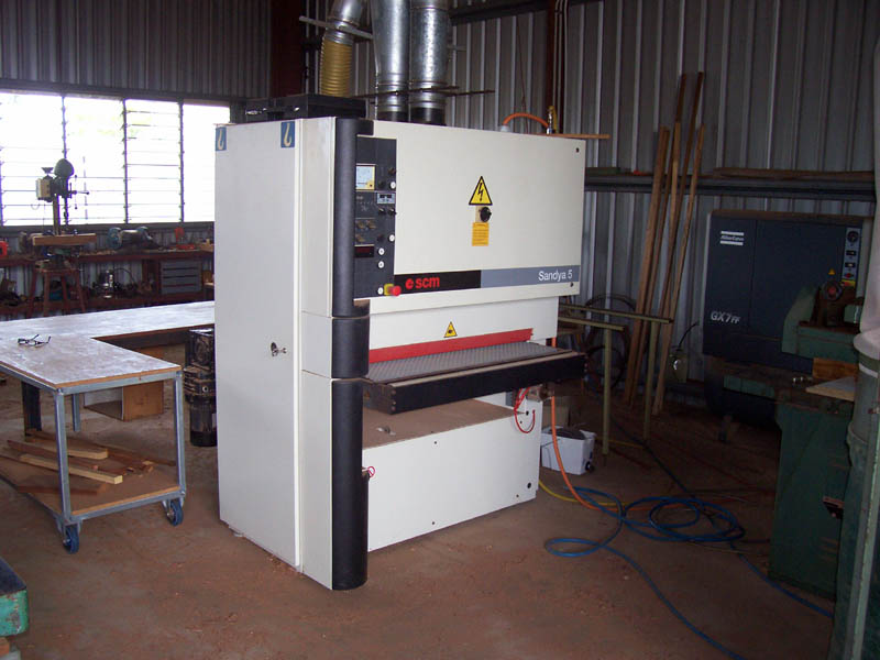

Post by DarwinStrings » Thu Dec 04, 2008 3:27 pm
After hearing these, not so good reports I thought maybe I shouldn't buy a Performax but after looking and hearing some other opinions it seems this may still be the best value for money sander.
Tracking problems sound like a pain in the proverbial but they also sound standard for power fed sanders of any type.
The sander I use at the moment (picture below) belongs to a friend and he has had his share of feed belt tracking trouble too. Also he is only in during works hours and sometime is on site all week so I need to work out ahead of time when I want to sand.
So maybe it is the performax in the end
