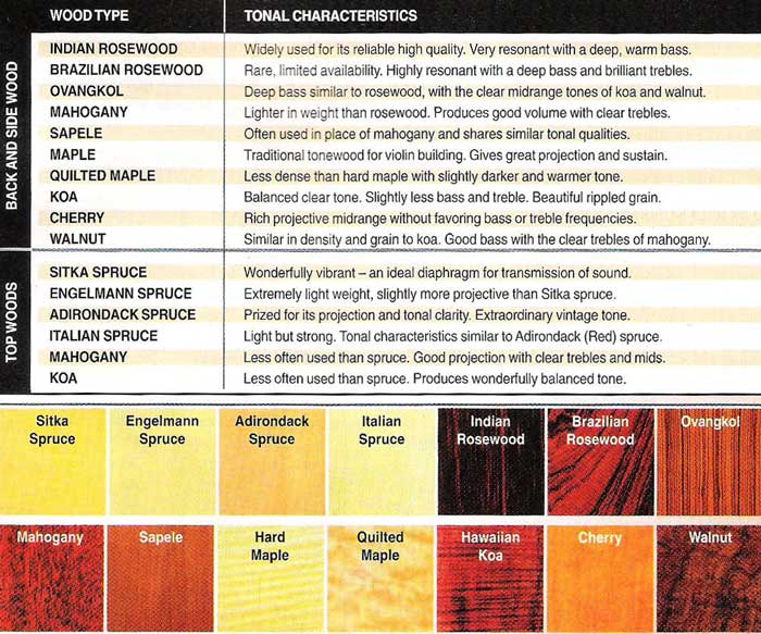

hi guys, i need a little help putting together my project folio at the moment. i need to fudge an investigation i didn't really do, to justify my timber selection for my guitar. tim s has data of all sorts of timbers on his site, but i was wondering if anyone could interpret that for me. what make good tonewoods for different parts and why? and what make bad tonewoods just to throw a few in?

Here is a chart that Martin dealers use to explain some of the more commonly used woods in guitar building:

Good tonewoods go
Boooooooooooooooooiiiiiiiiiiiiiiiiiiiiiiiiinnnnnnnnnnnnnnnnnnnnnnnng
Not so good tonewoods go
Thunk
Or so we are lead to believe due to the tradition of building guitars from resonant rosewoods.
However Tiger Myrtle goes Thunk but you can still build a nice guitar from it. It just doesn't impart as much influence on the sound of the instrument as, say, Brazilian or Honduran Rosewood.
Tops need to be light and stiff and do the Booooooooooooiiiiiiiiiiiiing thing and it's probably more important that you get a top that has these qualities and also sustains when you tap it. The top will be the predominant tone influence on the instrument
This of course is a gross oversimplfication as the instrument has to be built as a system and a whole lot of small details will also determine with the instrument will be grouse or shouse.
Here's an article by Dana Bourgeois with his thoughts on a variety of tonewoods.
http://www.pantheonguitars.com/tonewoods.htm
