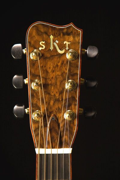

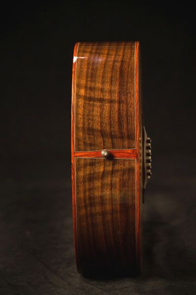

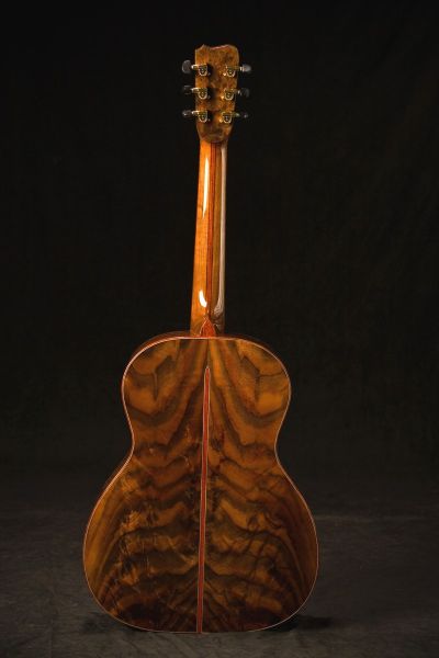

I really run the risk of trying your patience, but as you see I'm taking the risk!
Here's the "sister" guitar to the Coco / Engelmann posted last week.
They left the shop at the same time, and were bought by the same customer. (I love customers like that.)
Claro Walnut from Larry Davis, WR Cedar from Shane Neifer, red Cocobolo trim from local hardwood store. Burled walnut headplates and rosette, Brazilian rosewood bridge.

Gosh, that is some Claro... :shock:

I like the back inlay. Trying to think how you go about getting that nice tapered point on it kind of alludes me though. It is just past 5:30 am and I haven't had the first cuppa, so I might be a bit slow on the uptake.

I really love your headstock shape .

I have some widely banded figured claro similar to what you have used in this guitar out in the shed. It is obviously crotch wood and naturally enough with this kind of figure comes short grain and with short grain comes it's own problems, such as floppiness and what I imagine would be a certain amount of instability.
How do you address this if apparent in the wood you have chosen or does it just not get chosen for this reason in the first place? I need to ask this question because 2 of my sets have great figure but tap like a serial box. We don't see too much claro walnut growing around AU so local knowledge is about as scant on the ground as the trees are.

Allen, the fine point is simply carved/sanded to suit. What's a bit tricky is wrapping the purfling around the point. It's a pretty severe angle on each piece, and what one wants is for the joint line not to show. Routing the trough is not too hard, but that last little bit of carving to fit the point is sort of a pain. The upside is that you don't have to do two miters up near the heel cap.

Kim, those are good questions. Highly-figured wood is both it's own reward as well as it's own challenge. You gotta pay for all that sparkle. Some of it just won't make a guitar. For instance, I'd be nervous about crotch wood, unless used for smaller areas like pegheads or rosettes. This piece isn't crotch wood, though at the moment I can't say just where from the trunk it came. Several things you can do--leave a crazy wild back a little thicker. Brace it a little differently. Laminate a supporting veneer on the inside to stabilize it. (Several possibilities.)
But don't let an un-lively piece of wood discourage you. I've used some rather dull-sounding (but eye-popping) woods before to great effect. A piece of Ambrosia maple from Uncle Bob made a wonderfully rich and warm guitar, though the set tapped like cardboard.

Steve , Another winner completed ! The burl grabs my attention . Always seem to add an elegant touch , and in this case , well suited to the overall design . Could you post a close up of the rosette for us ?
I admire the backstrip also Steve . Is it to become a Kinnaird signature ?
I've noticed you've used it before I think . Very cool .

The burl is the same piece as the headstock, but the lighting makes it look a bit darker.
And this back seam dart is only standard if 1) the grain looks like it would support it and 2) the customer wants to support it (i.e. $$$)
It is extra tedium, afterall.

Great way to breath life into that walnut, Steve!! That's the set you got a GAL 2 times ago?? It is indeed crotch wood as crotch figures and grain orientations vary greatly.
I have been blessed with good advice from Mario Proulx and Jeffery Elliot on using crotch wood. I had some crotch BRW at GAL and Jeffrey was kind enough to describe how it should be orientated for best center strengh...long fibers as opposed to end grain which means sacrificing bling sometimes. The BRW sets I showed Jeffrey had some potato chipping going on and he dismissed it non-problematic. Proper bracing would take care of it and keep it stable. I've e shipped many sets of Hondo mahogany crotch wood to Mario and he has made a lot of fantastic guitars with it. I was preparing another 10 sets for him when the mahogany ban came about and we scrapped the shipment. Both guys advise butting the center joint with long grain instead of the end grain. Mario could relieve a lot of fears of using crotch wood so long as it's GOOD crotch wood.
Crotch wood should be chosen only after many years of being cut so that all tension has released from the wood...well...as much as possible and any stress fractures that might occur have. Steve, your set was cut at least seven years before you used it.
Hi Kim....by "short grain" do you mean "end grain" Short grain is wood fiber that has been cut thru at an angle not parallel to the tree pith...run out?
