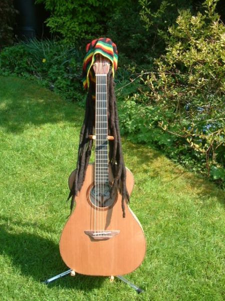

Hesh,
I don't necessarily agree - it depends on the piece of wood. The two cedar topped guitars I made were around 3mm in the centre bridge area thinned to around 2.5-2.8mm at the lower bout edges. They are fine. One is my cedar/maple "dread" that is nearly two and a half years old now, stable and sounds better by the day:

Dave mon that is a very cool guitar and it's clear to me that it's no rasta impasta...... :D
