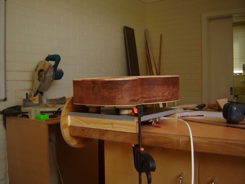

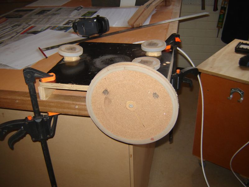

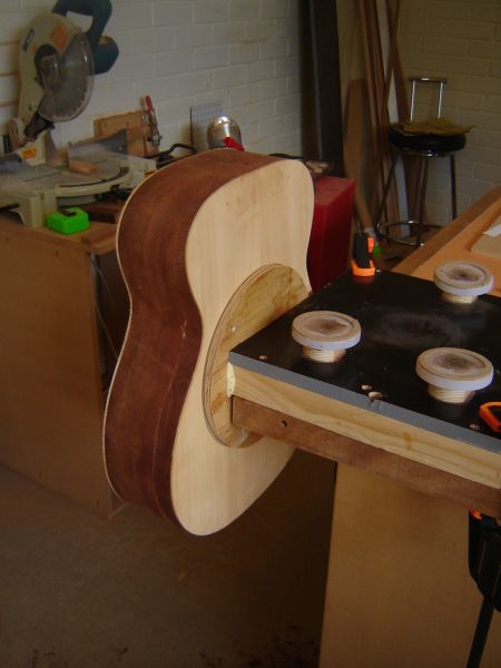

Here is my holding jig. The large disk holds the back for working on the sides. This is very powerful grip. You would break the guitar before you ripped it off so long as the vacuum seal is good.
Taps let you back off the pressure and turn the guitar before the vacuum fully lets go to get to a different section. It works very smoothly.
And the small disks are flexible and will conform to the shape of either the top or the back.

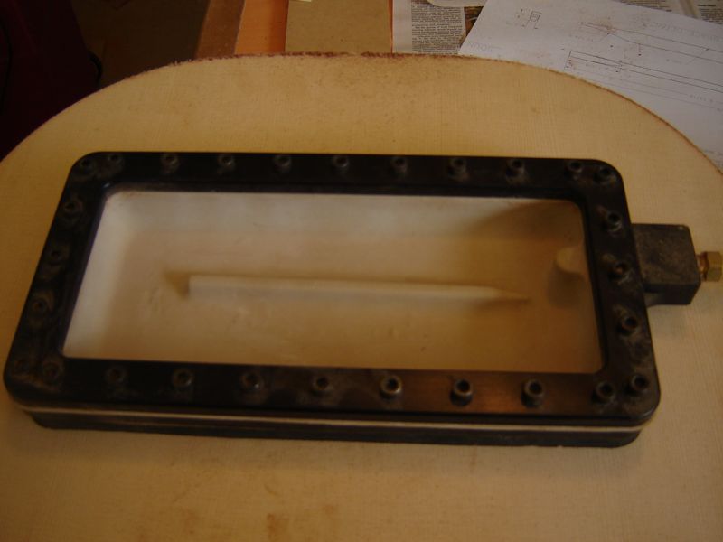

And I have an LMI bridge clamp jig. Here it is with a pencil to show you how it conforms and places even pressure on every sq mm.
To make the large and small disk I first made a ply positive form in my 15 ft radius dish. I covered that with sand paper and used that to make a smaller copy of the 15 ft dish. You need to match it your back radius because it will distort your back if it is a different radius. The large one is covered in cork with closed cell foam in a small groove around the edge and routed grooves so the vacuum can get out to the edge so the whole surface is working.
The small disks are white chopping board plastic also with closed cell foam also in grooves. The grooves give the foam somewhere to retreat to under compression without totally crushing. Check out Charles' article if you can.

I'd be very nervous about using that large disk as vertical back clamp though. What if the vacuum lets go? What's the failsafe??

All, there is plenty of stored vacuum in the buffer tanks in case the pump stops but it would be easy to put a shelf or as Craig says a bit foam on the floor if you are worried. My confidence has grown the more I use it.
