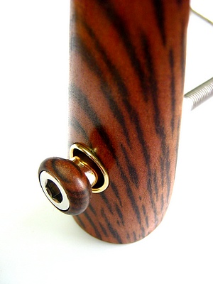

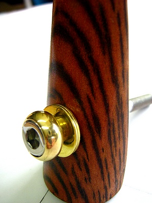

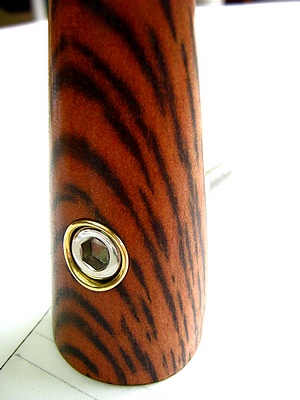

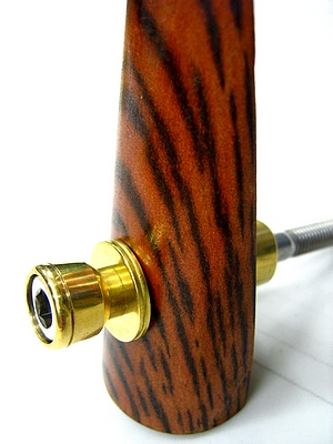

After seeing Jeff's Adj. neck strap pin , I've come up with a few versions of my own for my T. Myrtle project using my verticle lathe ( drillpress :lol: ). Trouble is , I can't decide which one I like best , so I would really appreciate your opinion here .
You'll have to ignore the rear washers in these pics. I intend to have a solid round brass plate of similar dimensions , but radiused at the rear to suit the heel's profile.
And last , with no strap pin at all.
Whatdoyareckon ??

Post by kiwigeo » Fri Oct 31, 2008 5:04 pm
The last one lights my fire.
Post by jeffhigh » Fri Oct 31, 2008 5:59 pm
I really dig 2 and 3.
4 is fine too
1 doesn't float my boat
You are inspiring me to do something a bit nore stylish with mine
Post by Kim » Fri Oct 31, 2008 6:00 pm
Last one for me to Craig. 8)
James Mc
Posts: 245
Post by James Mc » Fri Oct 31, 2008 6:27 pm
I like 5 but if you were going to have a strap pin then 3 does it for me.
Dominic
Posts: 1098
Post by Dominic » Fri Oct 31, 2008 6:32 pm
I like number 3. But they are all very cool.
Post by Allen » Fri Oct 31, 2008 6:34 pm
I suppose if you want or need a strap button then 2, 3 and 4 are my choices. I'd have to see how much of the Tiger Myrtle there is going to be on the rest of the instrument before I committed to more in the strap button though. If you were going with gold tuners and perhaps gold fret wire, then the brass button on #4 would probably look the best, but if you were going with black knobs on your tuners then the black button may do the trick. All of this probably doesn't help a bit though eh?
My favorite is no strap button at all. as in your last one.

Post by gratay » Fri Oct 31, 2008 10:03 pm
I like 2 and 3..
I also like the last one but if you had to have a strap button as well it may look to busy..
So 2 & 3 for the kill 2 birds w/one stone approach.

Post by Dennis Leahy » Sat Nov 01, 2008 2:06 am
Wow, what a nice collection of alternates! I think you could sell all of them to builders.
For me, I like the rounded (torus?) shape of 2, 3, and 4, better than #1, for those instruments with a strap button, and your external adjuster with no strap button is a class act.
Your aesthetic for the one with no strap button is so well-executed that it has demonstrated to me an effective alternative approach to internal adjustment of an adjustable neck. However, the ones with the integrated strap button, effectively disguising the external neck adjuster as "just" a strap button, elevates the concept to a new plateau.
Brilliant, beautiful work!
Due to the relative neutrality of Ebony, I'd say make some up in Ebony, with matching rear strap buttons (offering an alternative for a 1/4" jack), and take these to market. I know I'd buy some.

Post by Stephen Kinnaird » Sat Nov 01, 2008 4:21 am
Tiger Myrtle button, Craig, if it'll be on a Tiger Myrtle heel.
You don't want to get too many different colors going on there.
Great stuff, amigo.

Post by Sam Price » Sat Nov 01, 2008 4:21 am
The tiger myrtle button #3 looks stunning.

Post by Bob Connor » Sat Nov 01, 2008 7:52 am
It depends on the rest of your appointments.
I reckon the only bindings that suit Tiger Myrtle are Ebony or Tiger Myrtle itself, so I'd choose the button to match.

Dave , I have had similar thoughts . Too many colour /elements in there may tend to make them look a little 'busy' .
The problem is the thinner part of the shaft and the rear bearing surface have an important job which only metal can handle . I suppose I could coat the metal parts black to match the ebony knob , but I don't like that idea at all ( reckon the coating would come off over time and look disastrous )
The all brass one ( No.4 ) alleviates a busy look , but loses the "cool factor" of the matching Tiger or Ebony knob. ,,,,My dilemma :roll:

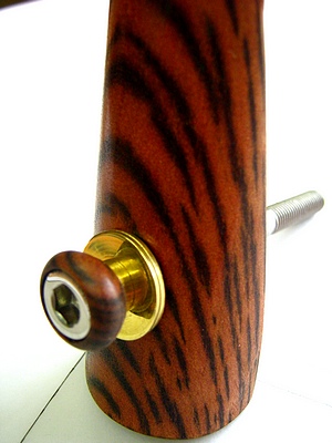

Post by Kim » Sat Nov 01, 2008 3:47 pm
Craig,
I think that you have done such classy job of the external neck adjustment as in number 5, that you could just stay with that to highlight the feature of your guitar having an adjustable neck. If you want a strap button as well, put it somewhere else such as on the side of the heel or into the side of the guitar where the upper bout meets the neck. To do this you only need add a small glue block to accommodate the screw to the inside surface of the side and the neck block itself.

Post by Lillian » Sun Nov 02, 2008 12:38 am
Craig, I like all of them except for the first one. My preference is for two or three, depending on the wood used for the body. If you aren't going to match the binding or the body wood, then I'd go with your basic black model. The all brass doesn't bother me, in fact if you hadn't shown the wooden ones, I would have thought it perfect. But, given a choice, I'd rather see the wood ones grace a guitar.
If someone wanted to go from five to a strap button style, is it possible to back the bolt out and replace it? I apologize, but I don't remember the details of your design. I'm assuming that it wouldn't be a two minute process, but still, would it not be worth the effort if you could switch them out if a strap button was wanted?

Post by Craig » Sun Nov 02, 2008 9:23 am
Lillian wrote:Craig,
Lillian !!!! You're a bloody Genius !!!!! ,, Jeff and Allen , you're nearly genius :lol: :lol:
That's a brilliant idea Lillian ,many many thanks for that and it's what I'll adopt.! You've solved my dilemma completley !!! ,,, PHEW !
Yes , I've worked out a way I can change from strap pin ( of your choice :D ) to no strap pin in a matter of minutes. I REALLY like this idea ! ,, very very cool !

Post by Craig » Sun Nov 02, 2008 1:28 pm
Here's what I've come up with.
From This :
To This :
All I've done is lengthen the collar on the strap pin model. It's merely a case of swapping screws if , or when required. Really simple !
