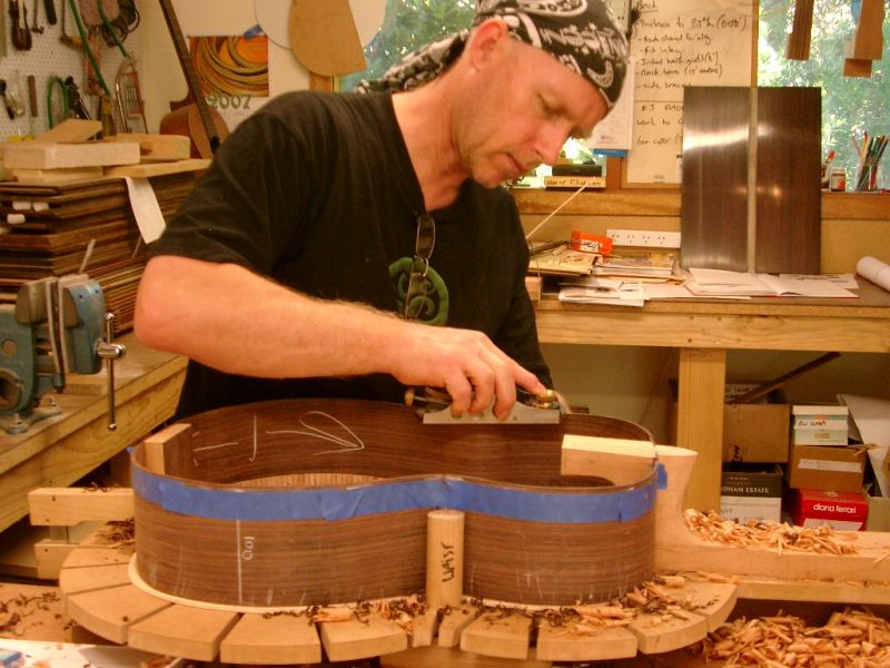

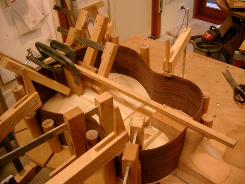

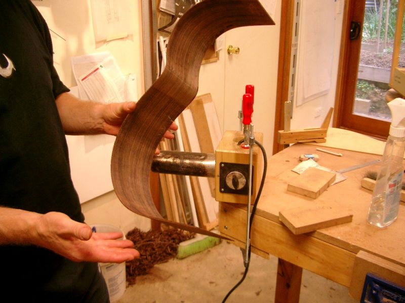

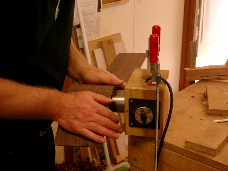

Made a bit of progress on the current build in between domestic duties and a long Geologists Lunch. Pics are of the right hand rib being bent....went alot easier than the left rib which started splitting around the waist.
A little bit here.....(pre lunch)
And a little bit here (also pre lunch)
Voila!!! And all without ze fancy thermal blanket! (this pic taken post lunch.....ze two bottles of red obviously helped).

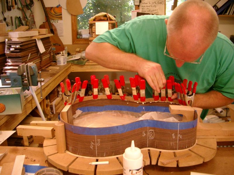

Post by kiwigeo » Thu Oct 30, 2008 8:27 pm

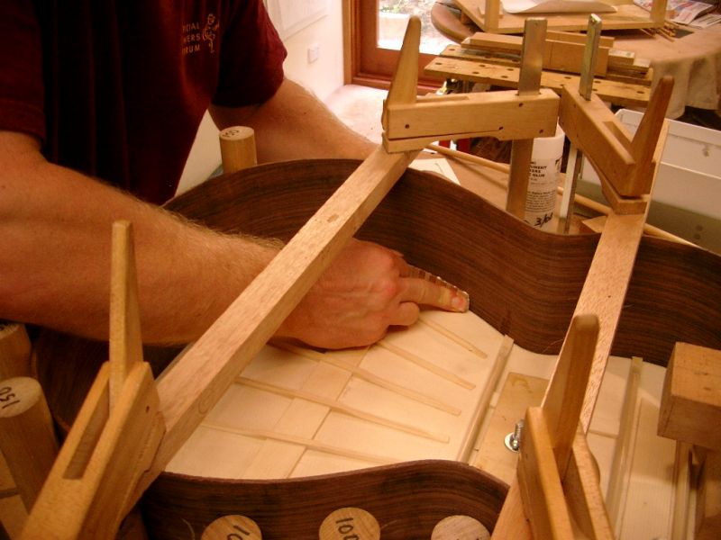

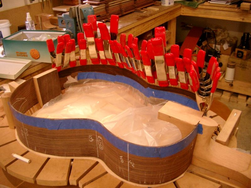

Got the ribs glued in today.....no major problems. I still think I could have stuck a few more clamps on that butt block. Tomorrow....I stick in ze tantellones!

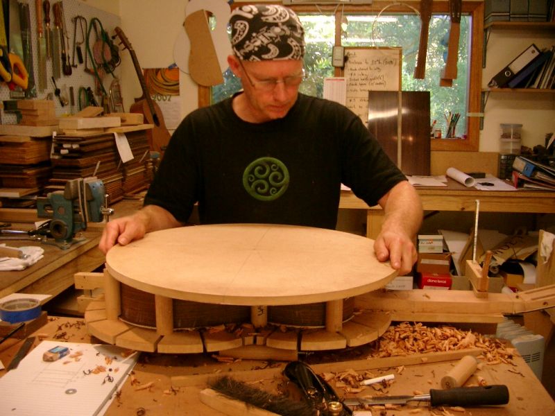

Post by kiwigeo » Sun Nov 02, 2008 11:09 am
Sides profiled for the back with 15' radius dished form. Right hand lining glued in.

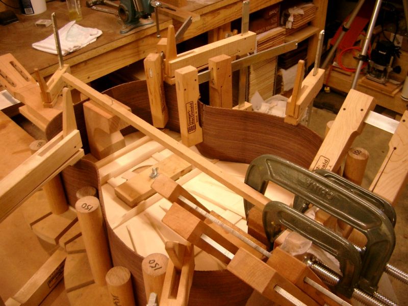

Post by kiwigeo » Tue Nov 04, 2008 6:30 pm

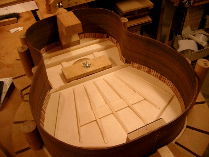

Side reinforcing in place. All that needs doing now is final cleaning up of the internals before I start on the back.

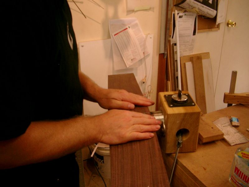

Post by kiwigeo » Fri Nov 07, 2008 5:04 pm

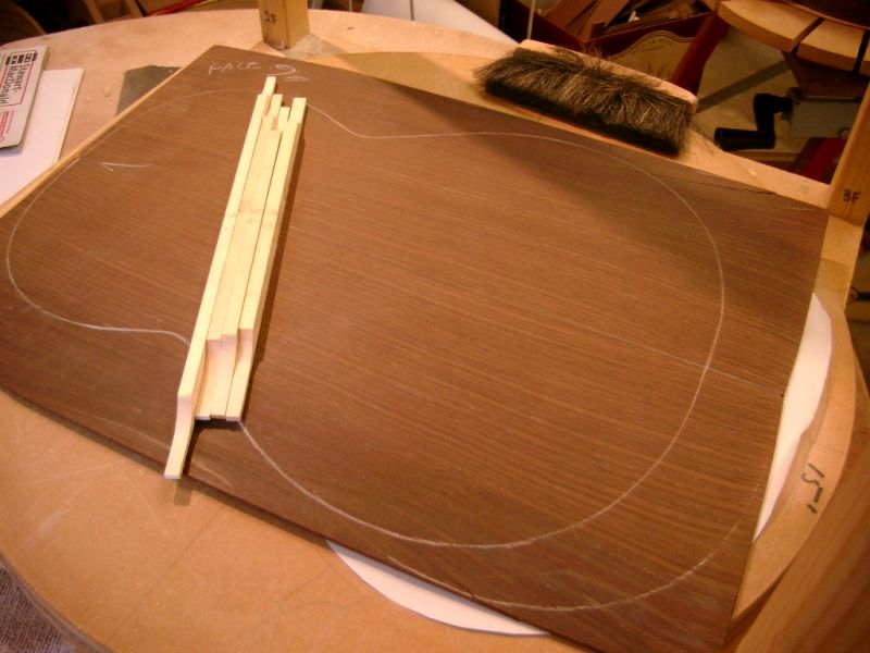

Waiting on purfling from LMI at present so not much happening on the classical. Got the back glued up and back braces have been rough shaped and profiled.
The back is opp grade IRW from Allied and it has alot of silica deposits. Im going to pumice fill prior to french polishing and Im hyoping enough colour will bleed out of the rosewood to stain up the silica deposits.

Post by Kim Strode » Fri Nov 07, 2008 6:12 pm
That's a good looking job so far Martin.
I noticed on the your submitted last image, that you have fairly substantial side braces at the same position as the two top braces running each side of the soundhole. I've never seen side bracing like this and am wondering why you've done it this way?
Kim Strode
Daylesford, Australia
Posts: 10873
Post by kiwigeo » Fri Nov 07, 2008 6:23 pm
The side bracing is a bit over the top in the upper bout. I looked at the view after installing the side struts at the end of the upper cross brace and decided that the UTB looked a bit strange without side braces so added them...purely asthetic.
