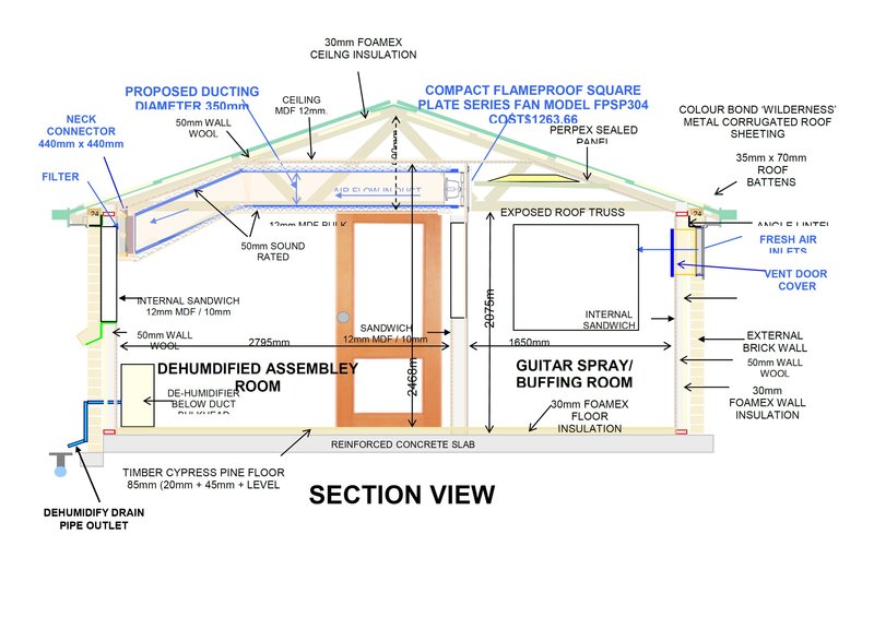

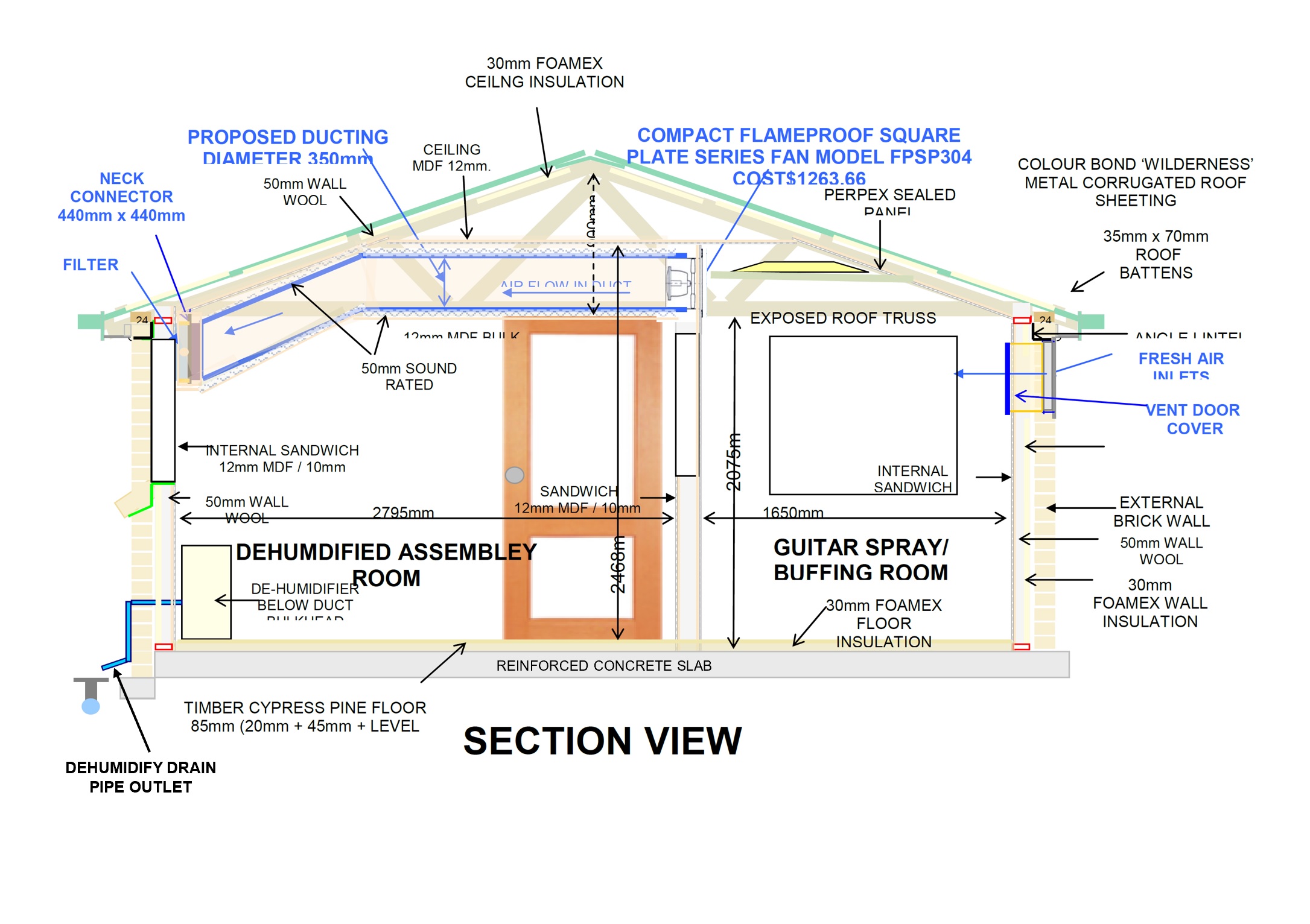

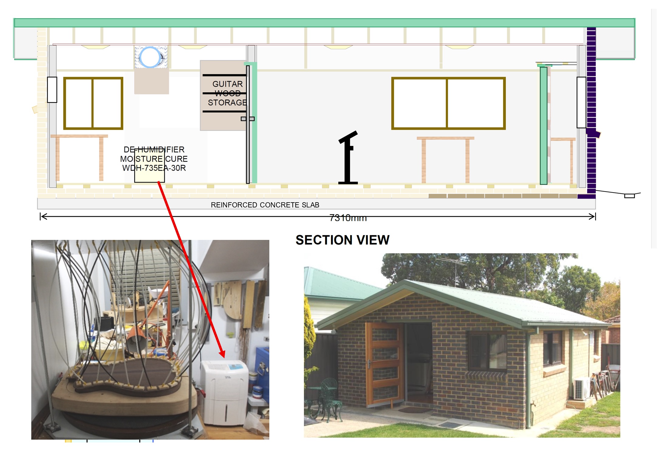

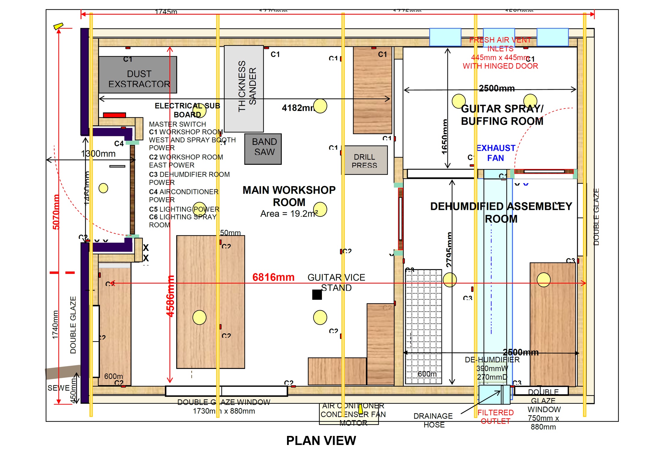

When I built my workshop I insulated the floor ceilings and walls. The workshop includes an assembly room with a dehumidify with a drain pipe outlet through the wall. See photos below.

Wayne writes up a detailed plan complete with full scale drawings before eating breakfast each morning
Love the attention to detail.

I think my partner would have a heart attack if I said that was my plan. So cool Wayne!
