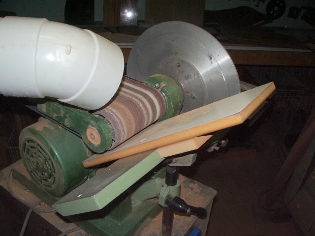

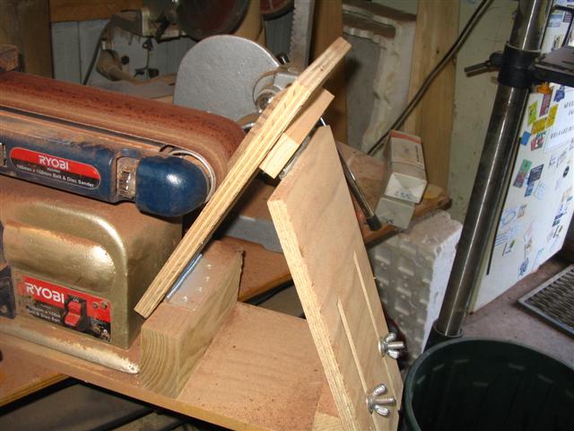

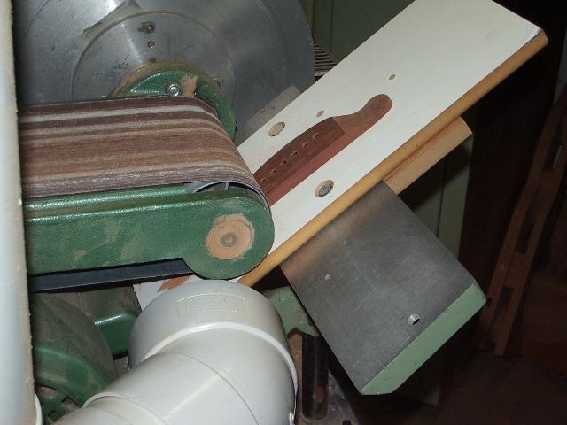

After seeing Bobs Tutorial on braces and preshaping I thought I would give it a go, and as I mentioned then it took all of ten minutes to set up my sander and do a couple of trial runs. I said I'd post some pics so here they are.
This is my take on shaping contours on the belt sander After Bobs tutorial on pre shaping braces I tried it for myself, and like I said I’m sold. I’ve posted photos of the before and after configuration. I will be modifying the table further
I find it more suitable to use the sander vertically for the many different sanding tasks used in doing my repairs and some building procedures, now I have a quick change machine.
The table shown came from a much larger machine [as did the sanding disc] and adapted for this machine possibly 15 years ago or so, and it’s the first time it’s been used like this. It’s adjustable up, down, in, out and can be angled. Maybe others will get some ideas from these photos.
Thanks for looking

I really like that Taffy, it's just perfect. You must surely be the Emperor of making useful things from what is at hand.

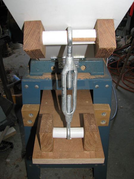

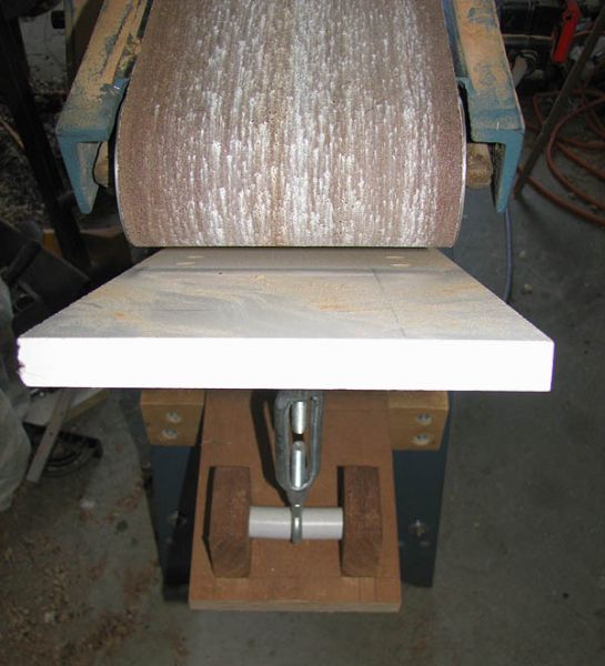

I have another take on a similar theme. As you will see I have used dowel I sized down by drilling a large bit into the end grain and then spinning in the drill press. The dowels are fed through the islets of a large turn buckle which I had laying around, and the ends are fitted into holes drilled with a close fitting forstner bit into blocks which in turn fastened to the platform and table.
I used PVC pipe which I slotted to slip over the dowel to act as spacers to keep the turnbuckle centralised. It has all worked out very well and cheap too. :D

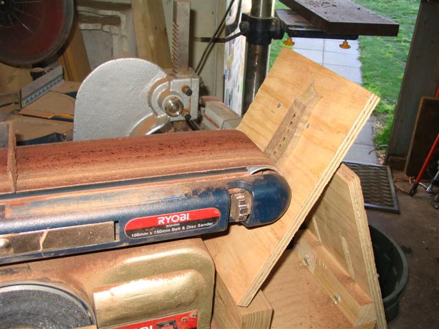

Mines a small Ryobi belt sander.
I like the look of your adjustment better Kim. The two wing nuts I use aren't that accurate.

Mine is a blatant rip off of Bob's design, as his was the only one I'd ever seen set up like that. I really need to work out something for dust extraction other than opening the front and back door to the shed and letting the wind carry it away though.
I've been pre-shaping the ends of my braces for the last year. I set it up so they are all consistently 3 mm thick where they meet the rims. It sure makes fitting the brace ends into the linings much more accurate and easy to do. Plus saves a lot of time.

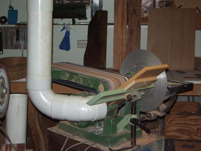

Here’s my finished effort with the table extended and held on with two bolts and wing nuts. I don’t know if I’m entirely happy with feeding in the work piece in the same direction as the belt, think I’d sooner push against it. It works OK but I’ll see if I can reverse the motor direction, if it could be switch operated, hmmmmm, wishful thinking.
Yes the table extension was also recycled material. I salvaged about thirty doors from my daughters kitchen upgrade. Good usable MDF bound for the tip, I’ve been living off of it [or dying from it] for about two years now. I peal the decorated plastic film off and use the hard laminate on the other side for the work surface.
Allen, heres two versions of the dust sytsem I'll be using
