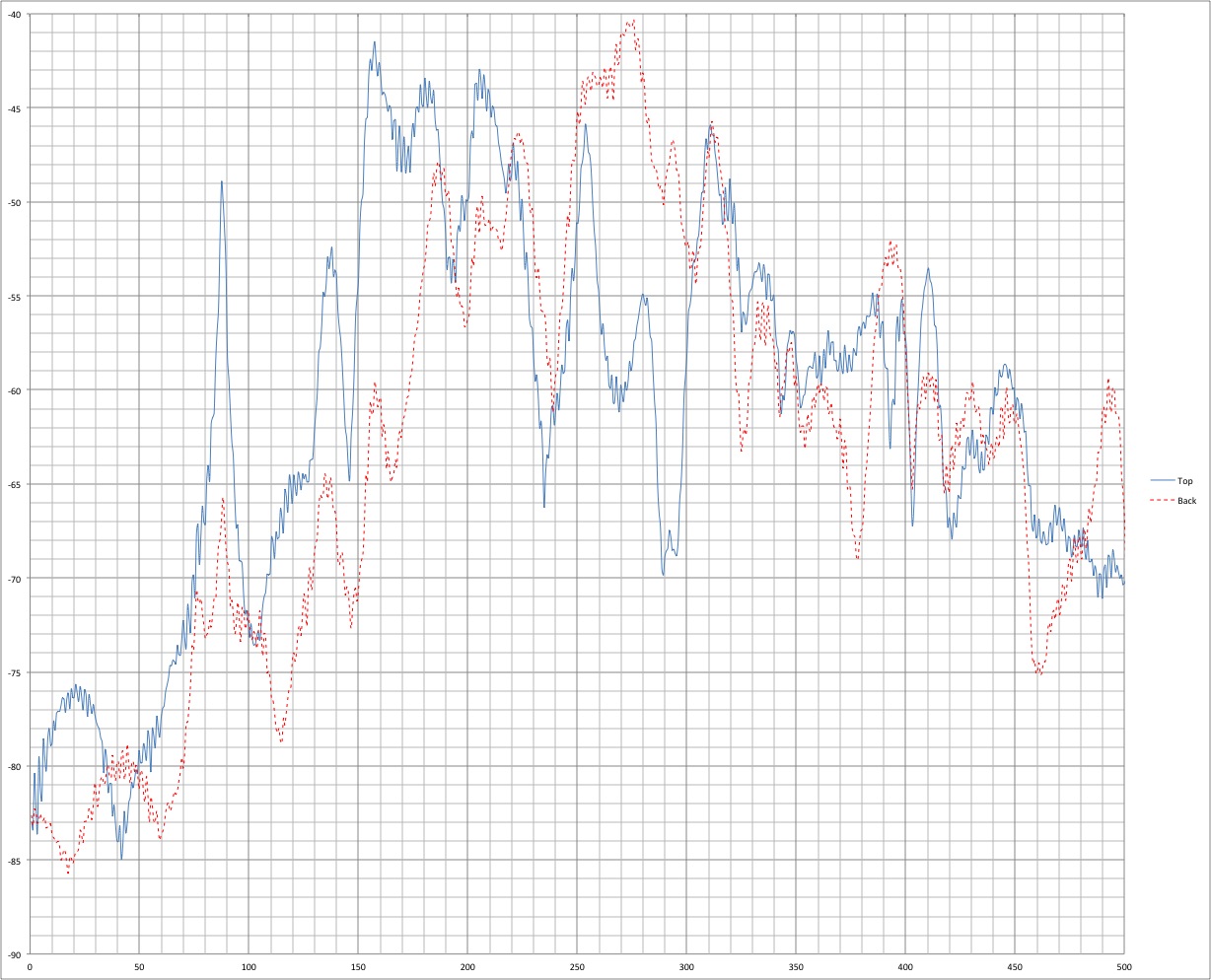

trevtheshed wrote:Martin, how are you doing your data gathering? (VA settings, type of mic etc.) There seems to be a lot of stuff going on that I don't normally see and I especially don't see the T(1,1)2 go up in frequency as the top is thinned around the periphery.
I normally glue the top and back on (which "seals" the box, bar the sound hole); get readings from a first set of taps, thin the top around the periphery and do more taps, which always produce a lower T(1,1)2, and when that is at target I cut the binding channels and bind etc. If you tap with the binding channels cut and no bindings, maybe with holes through to the kerfs, you can get all sorts of strange readings which can't be related to anything much.
Trev,
VA settings are as per guidelines in your book and Doms notes. Im running a Shure mic through a preamp and into line input on my Mac. The mic is 50-60mm from bridge centre and Im tapping on the bridge. Recording with the mic 50-60mm from soundhole doesn't make much difference to the peaks....just a bit of variation in amplitude.
I didn't do any tap tests while thinning the the top periphery....went straight to doing the bindings. The plot in my last post shows data recorded before thinning of top and cutting of binding channels and data recorded after glue in of binding channels....the only hole is the soundhole.
Note that prior to binding there were some extra peaks between T(1,1)1 and T(1,1)2 peaks...these have increased in amplitude with the thinning of top periphery.
Tomorrow I plan to do some serious Chladni testing. need to warn the neighbour first so they dont report aliens next door to the local cops.

Post by kiwigeo » Sun Sep 02, 2012 12:06 am
A clearer plot of bound top with back data also presented.

kiwigeo wrote: VA settings are as per guidelines in your book and Doms notes. Im running a Shure mic through a preamp and into line input on my Mac. The mic is 50-60mm from bridge centre and Im tapping on the bridge. Recording with the mic 50-60mm from soundhole doesn't make much difference to the peaks....just a bit of variation in amplitude.
That sound's all good Martin, though I've not tried this stuff on a Mac. You have a lot of peaks between 140Hz and 240Hz which are unusual, so it'll be good to identify those when you get the Chladni's going.
Not sure if a Mac allows you to do this, but:
When you save the tap file you should get both a text file and a picture file of some sort. On Windows its a .wmf file. I don't think the forum software will allow a direct upload of a .wmf file, but you can convert it to a .jpg (for example) using IrfanView (for example). IrfanView is a free download for Windows (don't know about Mac) and is a simple picture editor/file format converter. I use it heaps. That should save you pumping stuff through a spreadsheet to get a decent looking plot, but if you want composite plots, you will still need to use a spreadsheet. Also, make sure you only capture one tap per buffer update when recording the data. This gives you much cleaner plots with less "grass".
Have fun!
Have fun!
Trev,
VA works fine on the Mac....Im running it via Windows 7 running on Parallels emulator software. Im actually surprised at how seamlessly Windows is running on top of my Mac OS.
I've been using a spreadsheet to average dB readings taken over 5 sample runs (10 second runs). The spreadsheet also allows easier simultaneous plotting of more than one spectrum.
Frequency of taps is probably a bit greater than the 2 second buffer update so will try slower tap rate and see if that make any difference.
Note also I have been doing the recording with the guitar standing on its end on the bench and mic hanging from the ceiling. I note that you actually hold the guitar in a normal playing position during your testing.
After having a closer look at the data on the spreadsheet plot I've repicked the T(1,1)2 main top peak at 205Hz which isn't much different from the frequency I picked it at prior to thinning top periphery.
The main thing that has happened is the "extra" peaks between 140 and 250Hz have become significantly amplified. What issues does this present for the sound of the instrument?

kiwigeo wrote:Note also I have been doing the recording with the guitar standing on its end on the bench and mic hanging from the ceiling. I note that you actually hold the guitar in a normal playing position during your testing.
Ah, that could explain things. You may well be measuring the response of the guitar coupled with the bench.
kiwigeo wrote:The main thing that has happened is the "extra" peaks between 140 and 250Hz have become significantly amplified. What issues does this present for the sound of the instrument?
Well, if they're real, more peaks is generally good. But it's hard to think of a mode/modes that will produce peaks like that. So at the moment I'm still thinking they are an artefact of the way you're collecting the data. Coupling with the bench top etc. can also stuff up Chladni patterns. Working on a concrete floor will usually fix that, but it's hard on the knees!

Im currently in the workshop doing some extensive Chladni testing. Will take another hour or two to finish the testing and another few hours to collate the data and present same. Ill post up results tonight or tomorrow.
During tap testing the guitar was sitting on a carpet pad on top of the bench. Ill try sitting the guitar on a concrete tile or maybe I could hang the guitar from the ceiling and then it wont be coupled to anything.

Martin, just hold the guitar as you would if about to play it. No need to make things any more complicated. Tap with a small rubber tapper (a bit of eraser or super-ball on the end of a thin stick). My current tapper is a piece of super-ball on the end of a bamboo skewer. The natural frequency of the tapper is <5Hz, i.e. miles from anything you're likely to want to measure.
Online
Posts: 10888
Re: Falcate braced classical
Post by kiwigeo » Sun Sep 02, 2012 6:38 pm
For chaldni testing Ive had the guitar sitting in the carrier that I use on my binding channel cutting jig. This means the back is free to vibrate when doing top patterns and vice versa when doing the back.

kiwigeo wrote:For chaldni testing Ive had the guitar sitting in the carrier that I use on my binding channel cutting jig. This means the back is free to vibrate when doing top patterns and vice versa when doing the back.
... and possibly means the carriage is acting as side mass...
Foam wedges seem to work OK.

Ok Ive got a bit of tidying up work to do tomorrow with the Chladni testing and I need to re-do tap tests do make sure my testing method hasnt produced alot of the extra peaks. Here is a summary of todays top Chladni tests:
87.5Hz -strong monopole. T(1,1)1
136Hz - strong monopole.
157 and 178Hz - moderate monopoles.
205Hz - Strong monopole. Main Top Resonance. T(1,1)2
220Hz - Moderate monopole. Only other monopole present above 205Hz.
253Hz - Strong Cross-Dipole. This was my candidate for coupled back resonance but if so it should be a monopole?
279Hz - Weak Cross-Dipole. Closest top peak to peak at 272Hz recorded when tapping/micing back.
311Hz - Strong Long Dipole. The only long dipole I could see (tested up to 1000Hz)
385 and 409Hz - Strong Cross-tripoles.
445 and 567Hz - Strong Cross-Dipole.
592Hz - Strong Cross-Dipole
Nailing down the back coupled T(1,1)3 peak is a mystery. It should be a monopole but the only peaks close to the 272Hz back peak are cross dipoles at 253 and 279Hz. Can T(1,1)3 possibly ever be a cross dipole mode peak????

Just a few comments, I don't know what all of these extra peaks are but..
You don't have the bridge on yet do you ? that will make a difference.
Your main falcate braces are quite widely spaced. but you have a bridge plate so that is probably compensating.
Perhaps the back is too stiff without scalloping of the lower bout brace as yet, to couple with the top and show a T(1,1)3 response.

jeffhigh wrote:Just a few comments, I don't know what all of these extra peaks are but..
Jeff,
Thanks for the comments.
No bridge isn't on. Haven't even started making one yet. The aim will be to keep the bridge as light as possible.
Yes the primary and secondary braces are spaced wider than on the plans.
Not sure if back is too stiff......when I tap and do chladni testing on the top the back certainly feels very active. Today I Chladni tested all back tap test peaks. The lower bout is active at 270, 490, 520Hz while the upper bout is active at 445, 870 and 890Hz. Moderate to weak activity was detected at numerous other frequencies also. Playing with the lower transverse brace stiffness is certainly an option but Im wary of same changing main top resonance which is currently where I want it.
