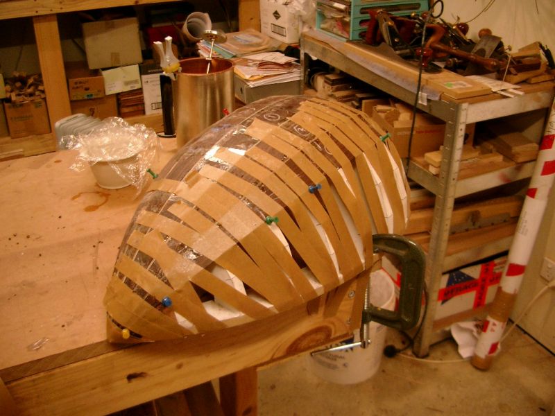

Post by kiwigeo » Mon Jul 06, 2009 5:02 pm
Another rib on today....thats 5 down 6 to go.
Behind is the new Dick glue pot that arrived today. I used it on the last rib and I cant say its much better than the leg wax warmer.
Post by Allen » Mon Jul 06, 2009 5:11 pm
Hope that you bought that tape by the case Martin, and got a discount on it.
I woke up last night thinking about this lute and carving the rosette. I'm really keen to see your progress on it. Is a lute soundboard something that you can take out on the rig, and whittle away at in your off duty time?
