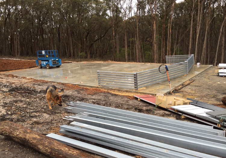

Re: Some news + designing a dream workshop?
Truss's and supports assembled ready to be stood up.

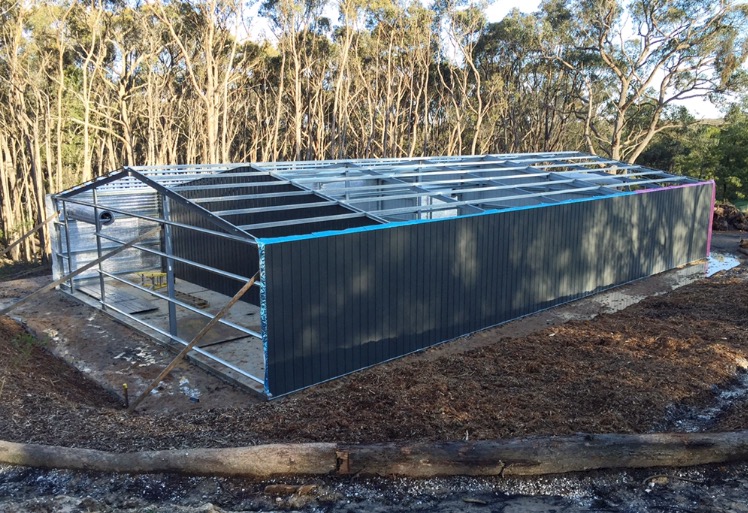

You're not wrong. It's just slush out there.kiwigeo wrote:Doesn't look like a good day for building........youve got a few more days of rain on the way
I have two other sheds at other locations and I was visiting one today only to discover in the recent downpour my old workshop had flooded. Luckily nothing was damaged that I am worried about as everything there is on stands or racks. All my machinery is in storage in another shed so it was safe. I appears that one of the gutters was blocked and all the stormwater redirected itself over the top of the cladding and into the shed. Not an ideal situation however nature will find a way to make things interesting.
I still haven't finished the drainage (rainwater redirection) for this new shed, things are progressing slowly as I have injuries in both arms, it's a bit of a running joke at the moment that I'm bloody useless, so things are progressing much slower than planned.
I'll get there in the end!

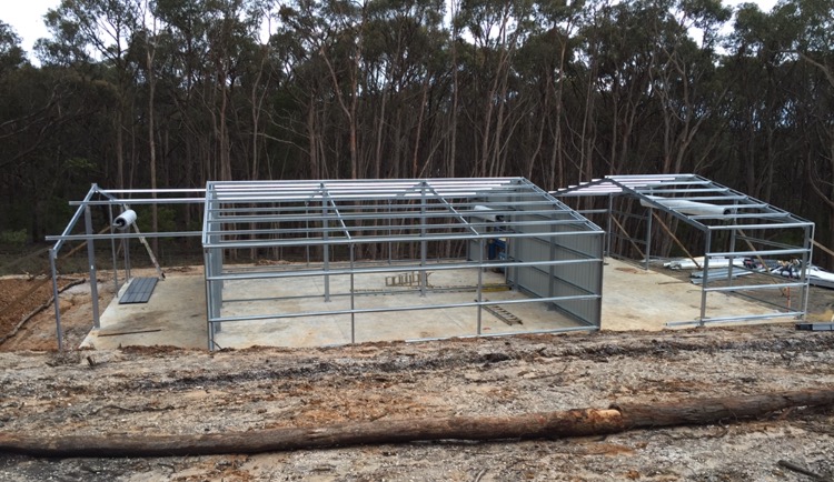

Bit of progress:
Nice! What are the two sections at each end for?
The frame is actually split up into four main rooms, later I'll be splitting that up a little more as per needed.Ormsby Guitars wrote:Nice! What are the two sections at each end for?
The reasoning behind the separation is that I want some rooms as clean air workspaces, some will be dirty, then I also want a couple rooms for working and timber storage which will be fully insulated like inside a house and will have dehumidifiers, although the entire shed is going to have thick (1cm ish) sizilation to all walls and ceiling.
I can be doing drum sanding and thicknessing in a dirty room, then walk into a clean room where the air is fresh and be doing hand work in there without dust floating through the air and into my lungs. Even though there will be large room air filters, it'll create a better working environment.
I noticed in the last workshop that the CNC room also was a "dirty" room, so again I'll have this separate to my main work area, however this time I'll have a room filter in there.
Also by separating the rooms, I can have roof lighting on separate switches, I found in the last workshop that lighting the entire place all day and running the room air filters was quite noticeable on the power bill, this time I can have my main work room lit while the others are dark if I'm not using those rooms, the air filters can be off etc. I'm also goin full "daylight" LED for this build to keep the lighting bill down, plus it has environmental benefits. It'll save money over the long run. There are 48 LED's going in.
Also by having a smaller workroom, I can have aircon and wood heater in there without trying to temp control the entire 252sqm and I can be quite comfortable, the other rooms don't need that.
It may seem bizarre having it all separated like this, however before I designed this shed, I drew up a layout of all my machinery and the order it's used in the build process so that I can create a smooth workflow and also control all the things I mentioned above. Then also room to expand.
For example, my large bandsaw, docking saw and those type tools only get used on raw materials, so they are stored near the pallet racks of raw timber storage. They don't need to be in my main workroom. Then once the raw timber is at the thicknessing/dressing stage I can move it across to the dirty room where it can be planed or drum sanded etc, those machines don't need to be in a temperature controlled room.
I've gone through every process and created a work station for each so there is a flow like in a factory, dedicated gluing stations, dedicated electrical stations, instead of using my couple of workbenches for everything like in the past, there will be a work bench for each process, including a separate area just for acoustics so I don't have to setup jigs etc just for that, as it'll already be setup. In my plan there is nearly forty lineal meters or work benches in the place, which should help with a workflow.
It will mean I can have a lot more builds running at once without having to move things out of the way, or I can have more people working in there at once without being in each other's way, which was a problem I had at the last workshop.
If I doesn't work out as planned, it's only metal sheet and top hat and can be pulled out and moved around.

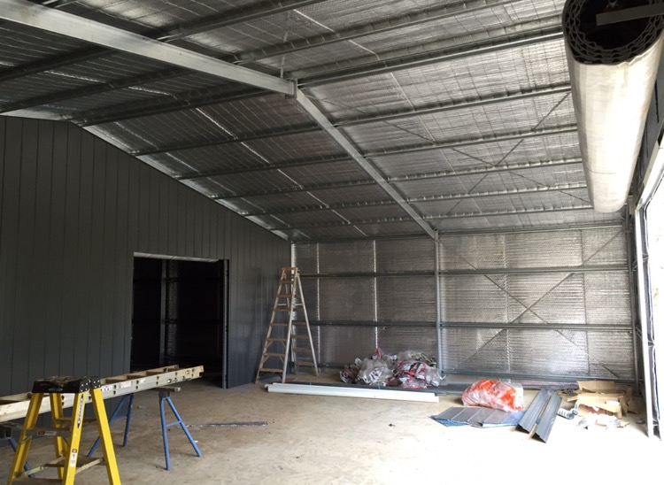

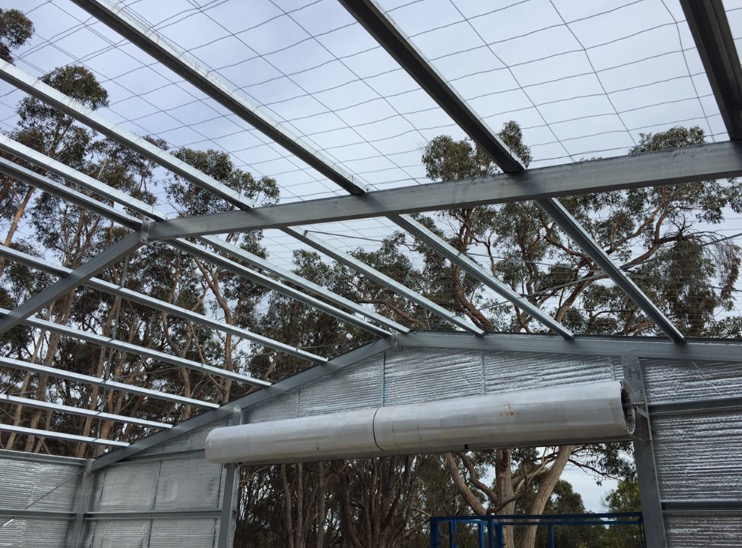

Monday progress.
The guys asking about the walls can see in this pic the sizilation is now going in.

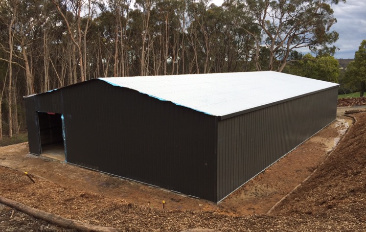

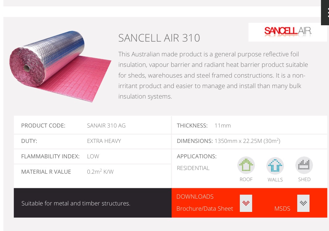

This is what's being used for the walls and roof. Apparently it's 11mm

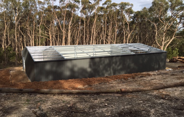

Tuesday progress:

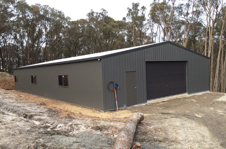

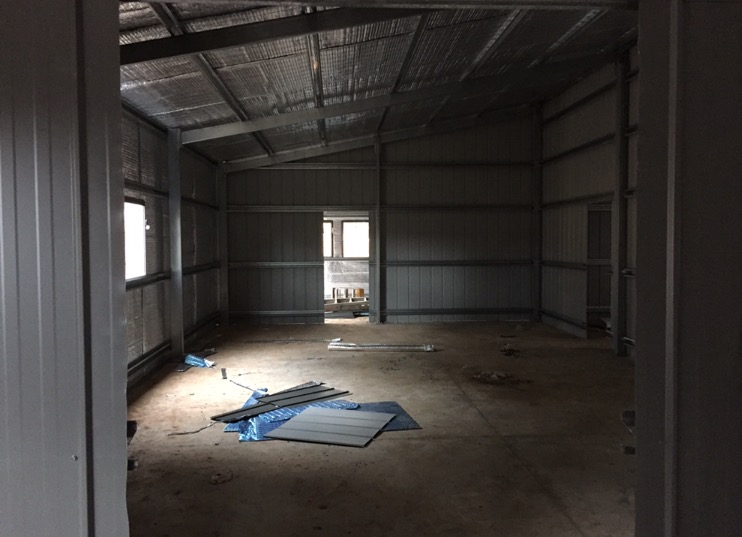

Thursday update:
Roof is finished, all outside flashing etc is done, rollers are done, motor on the main roller etc, some windows are in and the PA door holes are cut.
This pic is looking into my workroom through the doorway of the main "dirty" room. The door you see off to the right leads to the CNC room and the door to the rear leads to the electrical/setup room.
