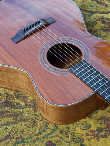

can you show me what you mean? I thought most soundboard material - except where it has bearclaw or similar - is typically bland and featureless, unlike side/back material. What topwood is exciting to look at?Graham McDonald wrote: it is at best boring to look at, and at times downright ugly
I'm interested - genuinely - in the concepts of boring and ugly!
Here's one I built with a Australian Red Cedar top. Black wood body, Red Cedar Neck. Not boring in my eyes.
This guitar I gave to a mate that is having a trying time with cancer. He plays the daylights out of it every day, and it's sounding better each time I get to hear it.
I've got another one ready to put strings on that has a Australia Red Cedar top, as well as an identical guitar with an Engelman Spruce top. I wanted to see what the differences in sound would be with the only thing different being the top wood. I should have both guitars complete before the end of the month, so stay tuned for the report.

I suppose what I like about spruce, or king billy is the elegant plainness of it. More or less the one colour and the regular, book-matched annual lines. As someone suggested before Bunya can look like a bit of formica. Just not very elegant, which is my basic criteria when I am looking at or designing an instrument. They have to good right before anyone even picks them up and Bunya just doesn't do it for me. That is not so say I am never going to use any again, but I would prefer a spruce of some kind
If Maton and Cole Calrk and whoever else can make then and sell them, good luck to 'em.

I guess gratay's pic is an example of why a bunya top does not appeal to me. First one I saw, my immediate reaction was -what is that flatsawn mismatched 4 piece top.
Sure the sound is the critical end result, but it really does have to be pleasing to the eye as well.
Fortunately everyone's take on appearance is different so some will like the bunya top that I dislike, good for them.
Jeff
Jeff
