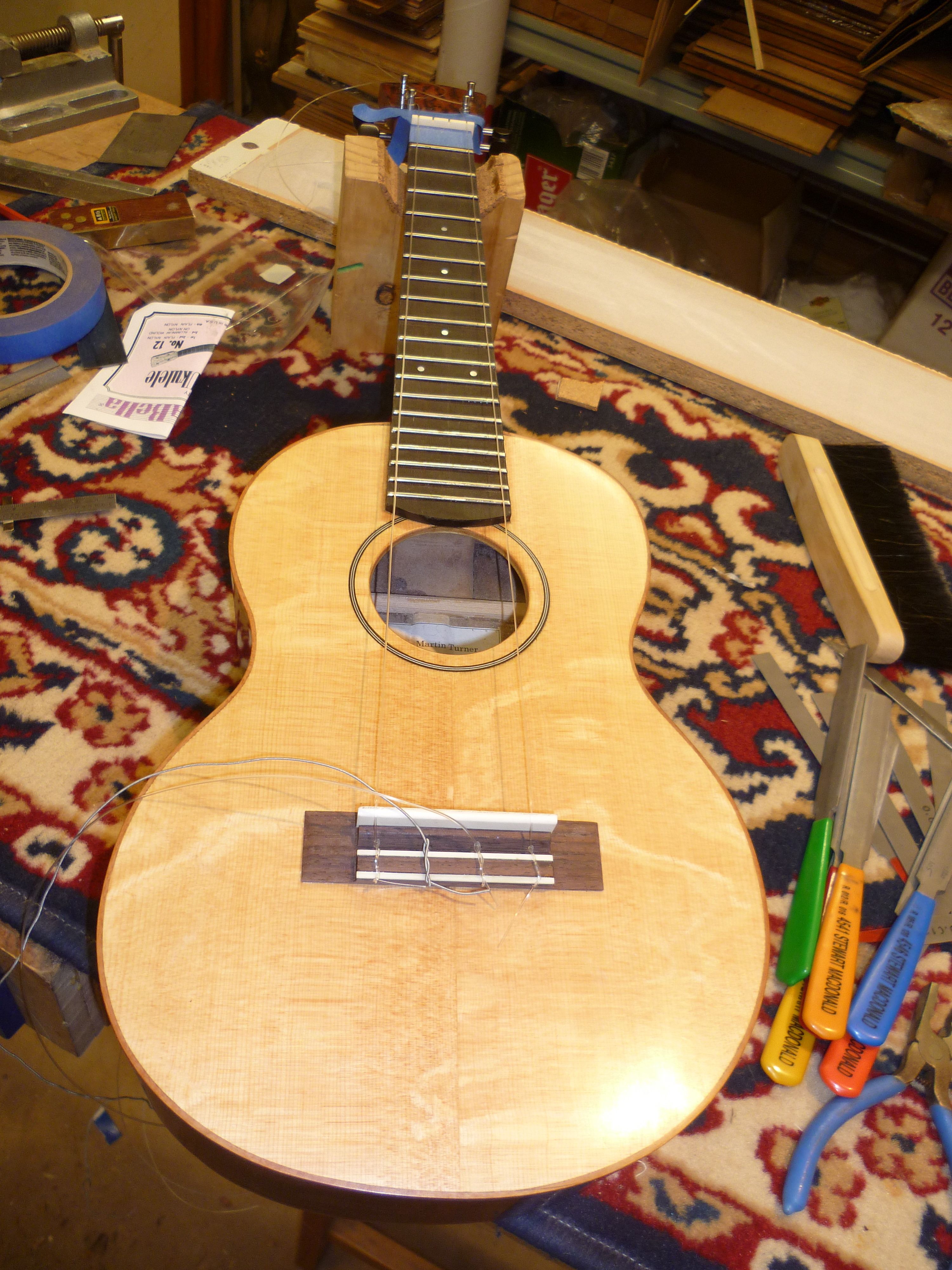

I add 2mm of compensation to the front of the nut. I've got a template that hooks over the nut end of the fret board and is the scale length plus 2mm. That way I can snug the bridge with the saddle in it up against the end of the template and drill some 1.5mm holes for locating pins (brads) into the bridge.

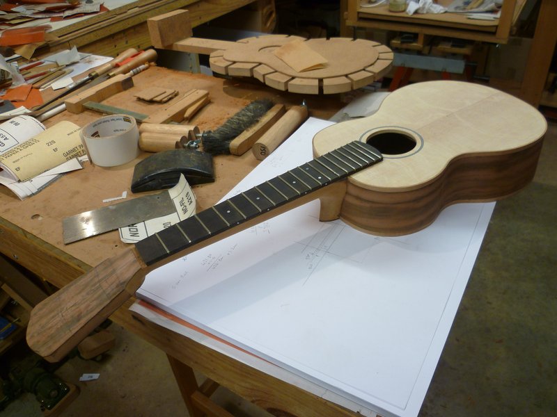

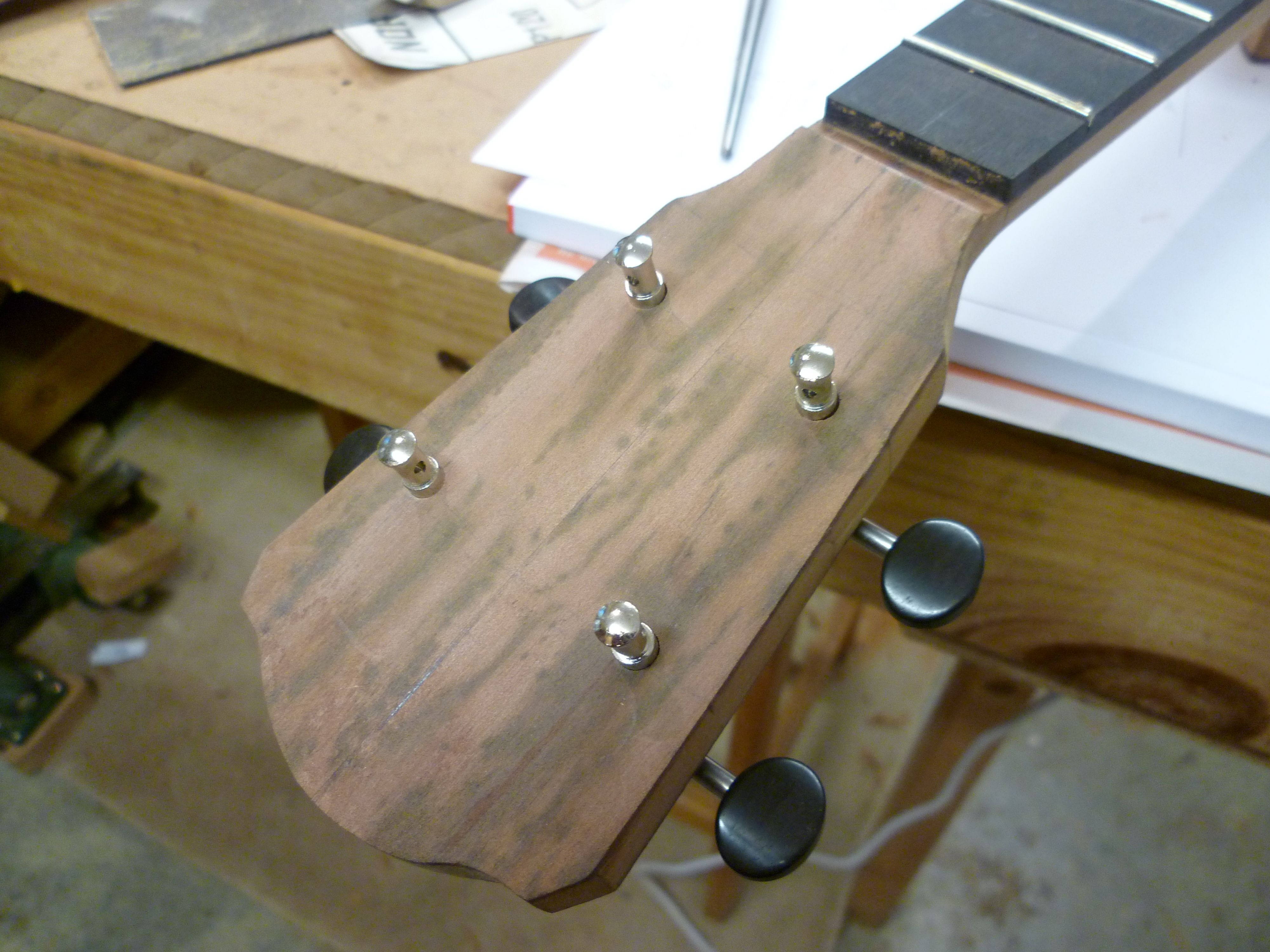

The Waverlys.....chosen because theyre nice tuners but also because they can be installed on a thicker than normal headstock. The neck on my uke was a failed neck from a steel string so I was stuck with a headstock that was around 14mm thick after Id applied the veneers.
The fret file is the vanilla flavoured one not the diamond file......the latter will be added to the tool arsenal with the next Stewmac order.

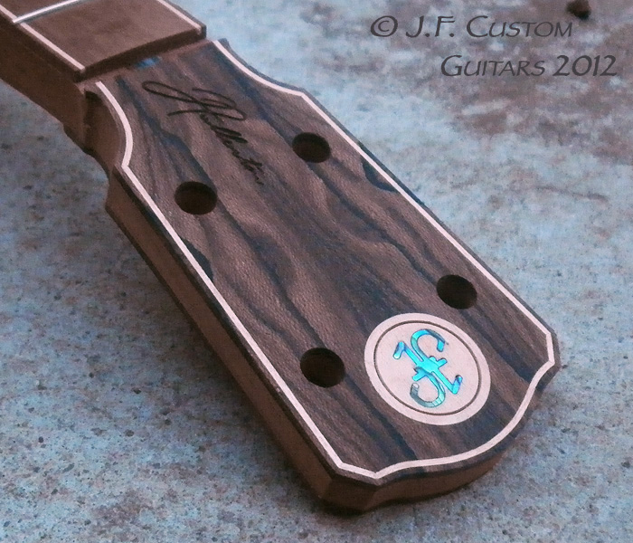

I was in fact, going to mention how specifically familiar that headstock was... But, in the interest of keeping the peace you know 8) Besides, much as I did design it myself, who am I to suggest no such design exists elsewhere? So I'll take it as a compliment then; I'm very fond of it, evidently you like it too. :D Here's another I did in the same style -

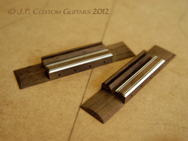

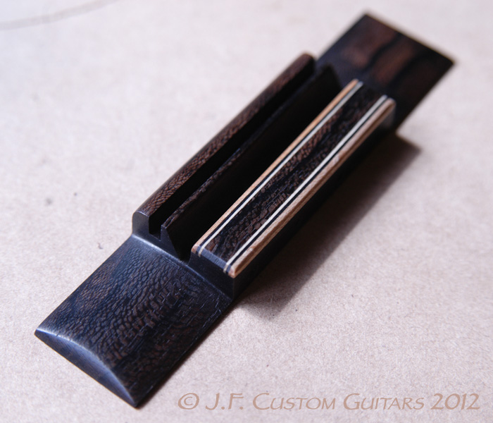

The bridge on mine is simply a mini classical style bridge. Much as they are fiddly to make at such a size, I really feel they look classy/quality/classic without being too over the top or "trying" to be different. Besides aesthetics though, they are also very functional - able to be crafted very light in weight; about 7-8gm's from memory. Some unfinished Rosewood bridges and an oil coated Ziricote -

Martin,
Yes, I think 1mm +3.2 mm saddle should put you in the zone.

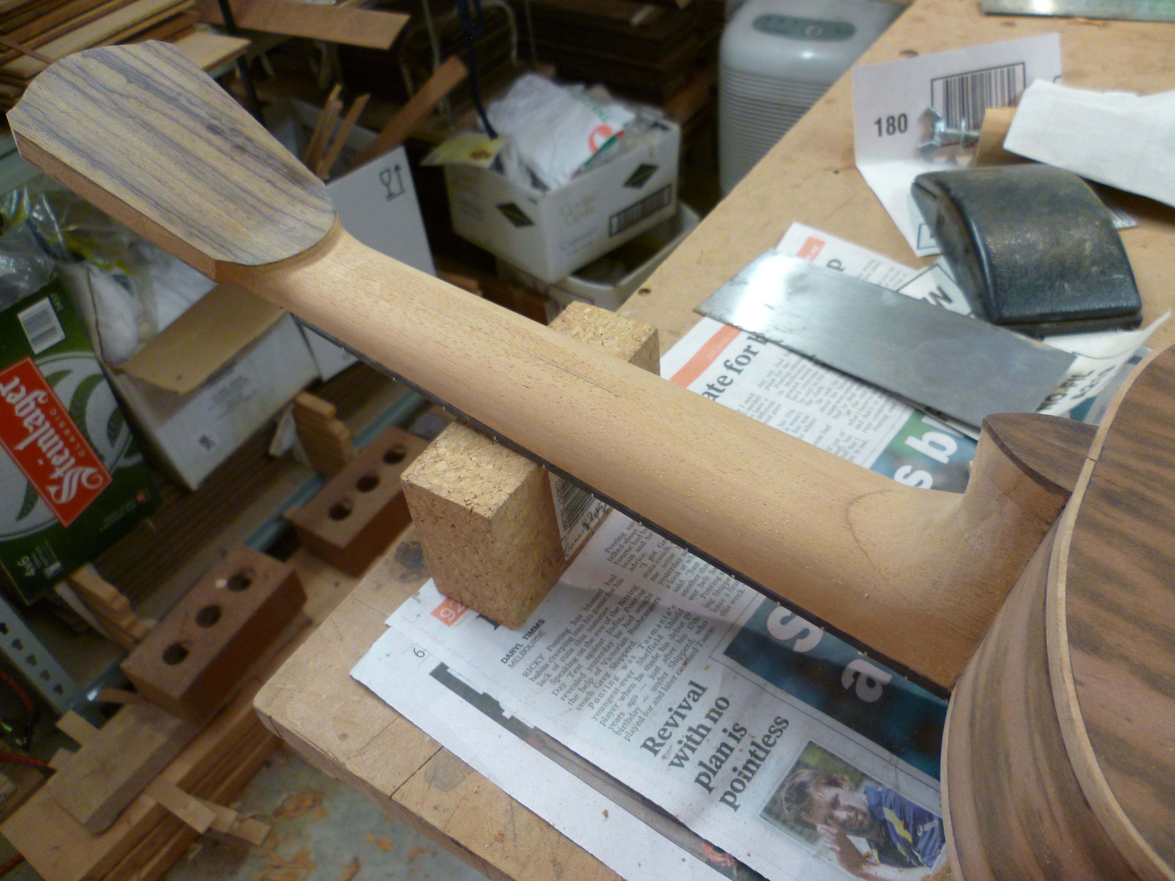

Post by kiwigeo » Thu Feb 02, 2012 6:01 pm

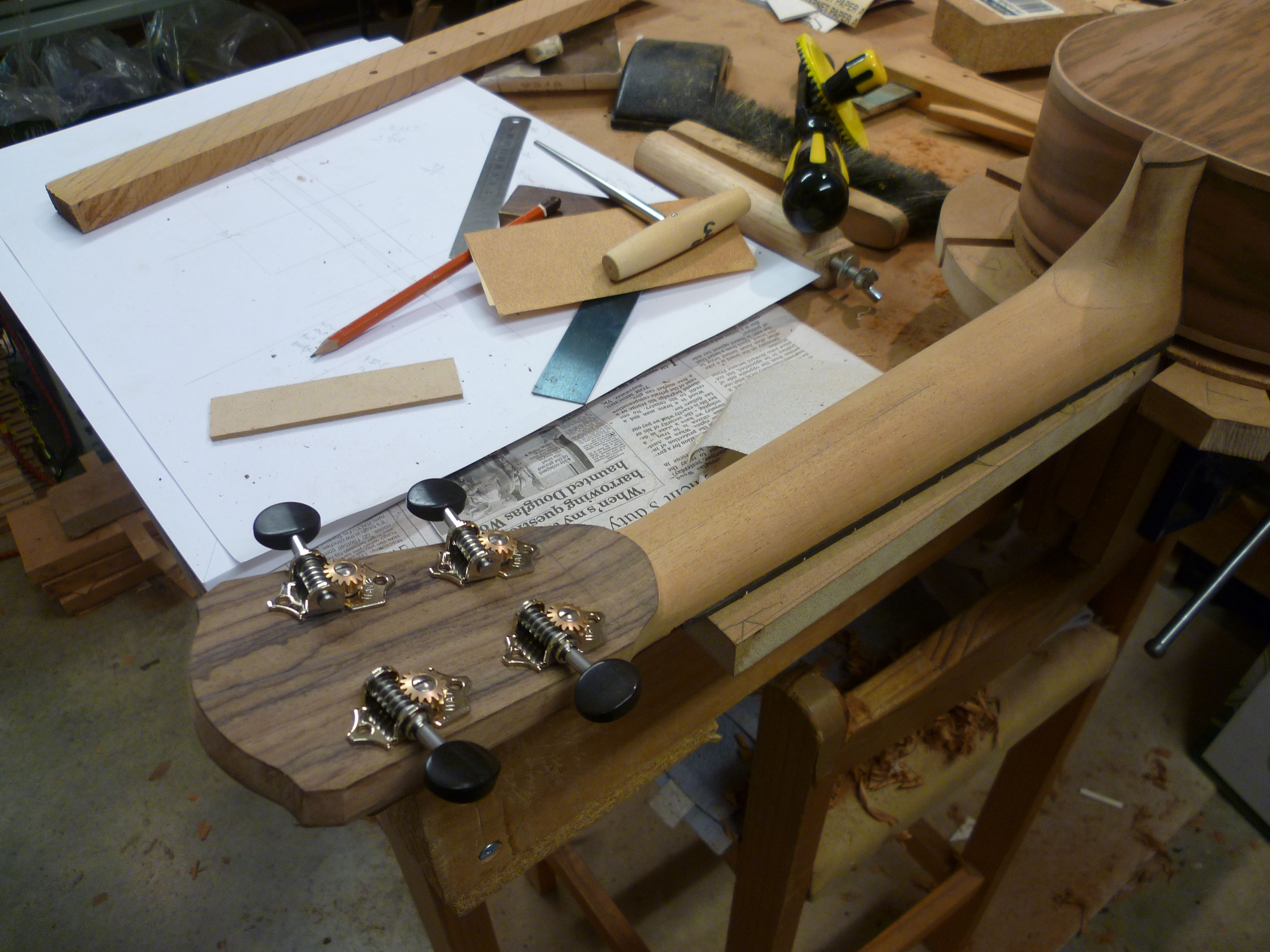

Getting there....got the neck shaped today and couldn't resist test fitting the Waverley tuners.

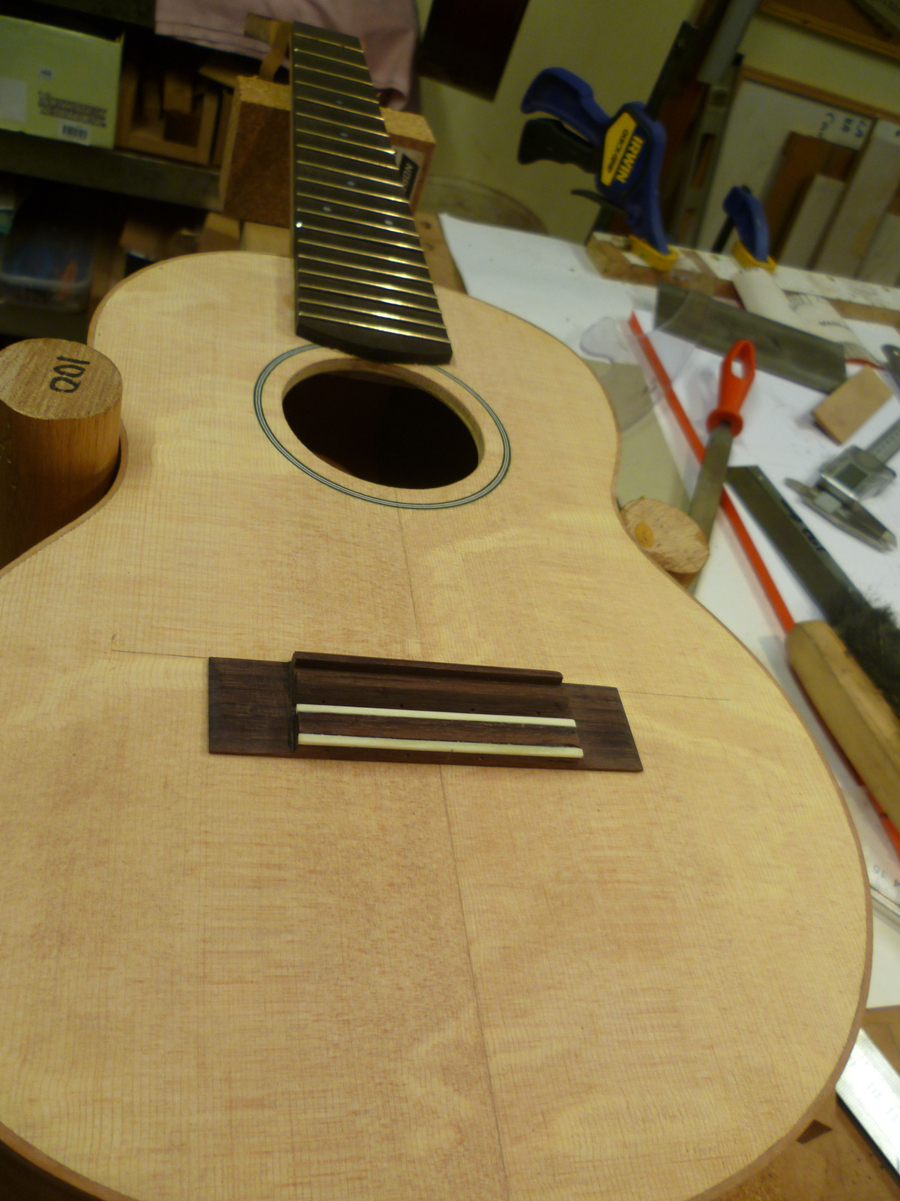

Re: Steph's Tiger Tenor Uke

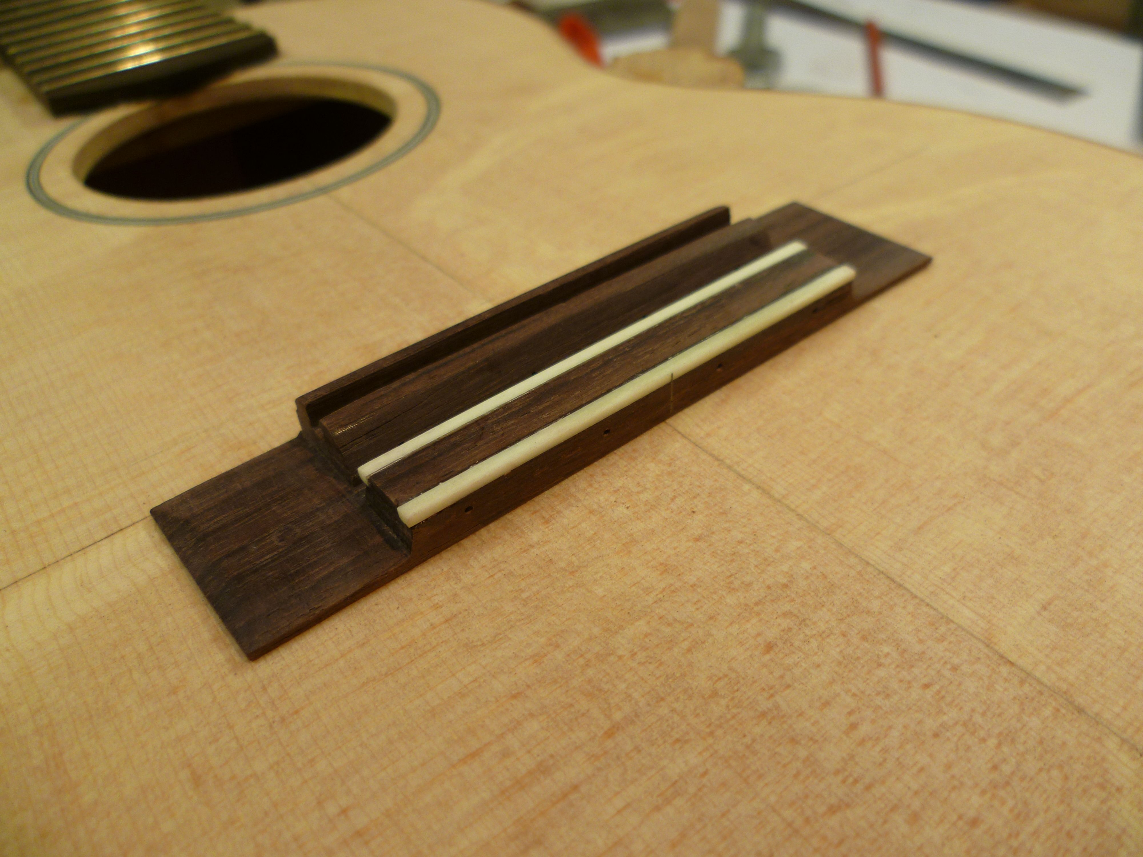

Post by kiwigeo » Fri Feb 03, 2012 3:10 pm
More questions for the ukeologists.
I'm designing a classical style bridge for my uke. String height off top at saddle position is 11.0m (this is allowing for 2.5mm action at 12th fret). I plan to make the bridge a tad over 7mm thick which will leave just over 3mm of saddle protruding above top of bridge. Saddle slot will be 3-4mm depth. Bridge will be 25mm front to back. Width of bridge will be sufficient to accomodate string spread plus 15mm wings either side.
The above dimensions allow for about 4square inches of gluing surface which according to David Hurd is sufficient for a tenor uke.
Any comments on above would be appreciated.
Post by Allen » Fri Feb 03, 2012 5:14 pm
With a tie bridge mine are 100mm wide and 22mm deep. String spacing at either 42mm or 45mm depending on buyers preference.
Your specs are certainly within the norm Martin.
Post by kiwigeo » Fri Feb 03, 2012 6:08 pm
Thanks Allen!
J.F. Custom
Posts: 778
Post by J.F. Custom » Fri Feb 03, 2012 7:41 pm
Hi Martin.
I answered a PM of yours but for the benefit of a broader audience who may be reading and interested...
My dimensions for the classical style Tenor bridges pictured above, come in (by happenstance) at the same size Allen mentioned - approx. 22mm by 100mm.
David Hurd suggests a 2.5" square gluing area on a bridge is required for a Tenor, calculated by string tension and extrapolated using the classical guitar design as a reference. However, he suggests he has had success in his several hundred instruments using a 4" square gluing area in his design. The dimensions I (and Allen) have provided give about about 3.5" square.
Quoting David Hurd -
"...the smallest ukuleles shouldn't have miniature classical bridge shapes because all of the area is used as a stiffener as well as glue area. "Wings" on a soprano are probably extraneous, adding excess stiffness to the top."
"My own tenor bridges have about 4 in2 of area and that middle range value has worked well for me for several hundred instruments."
"Tenors and baritones could be either 1" depth with small "wings" or 7/8" with slightly larger "wings"."
Anyway, hopefully you are not being led too far astray if you land somewhere between our advice and that of David!
Cheers Martin.
Post by kiwigeo » Sun Feb 05, 2012 5:20 pm
Today spent working up the bridge. The wings could probably be a bit wider but I'll live with what Ive ended up with.

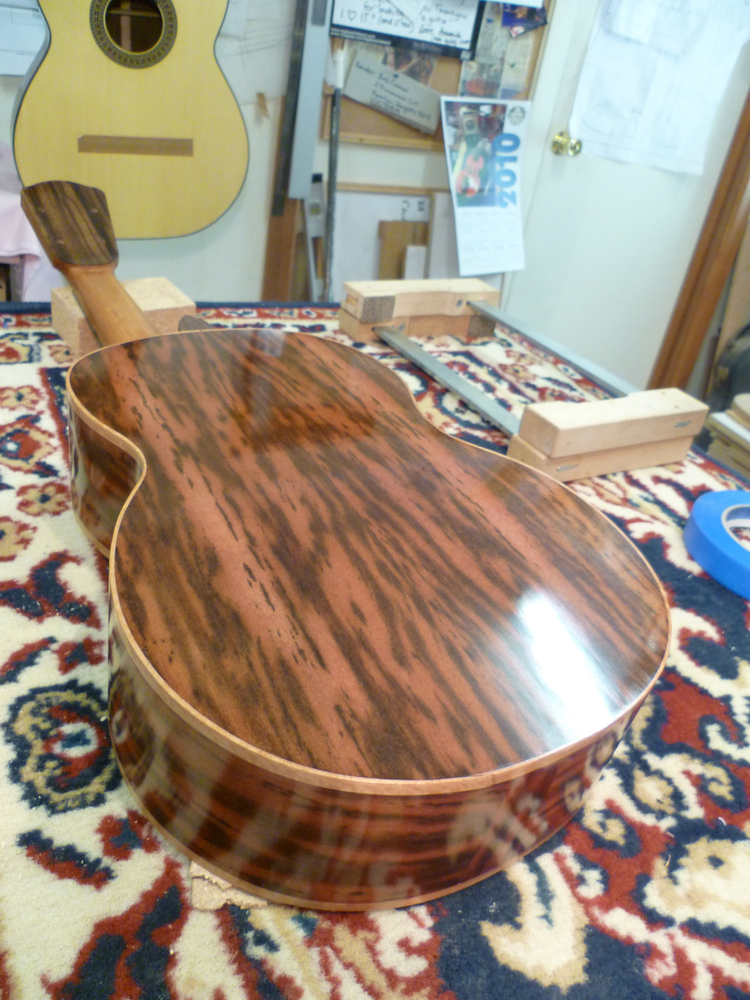

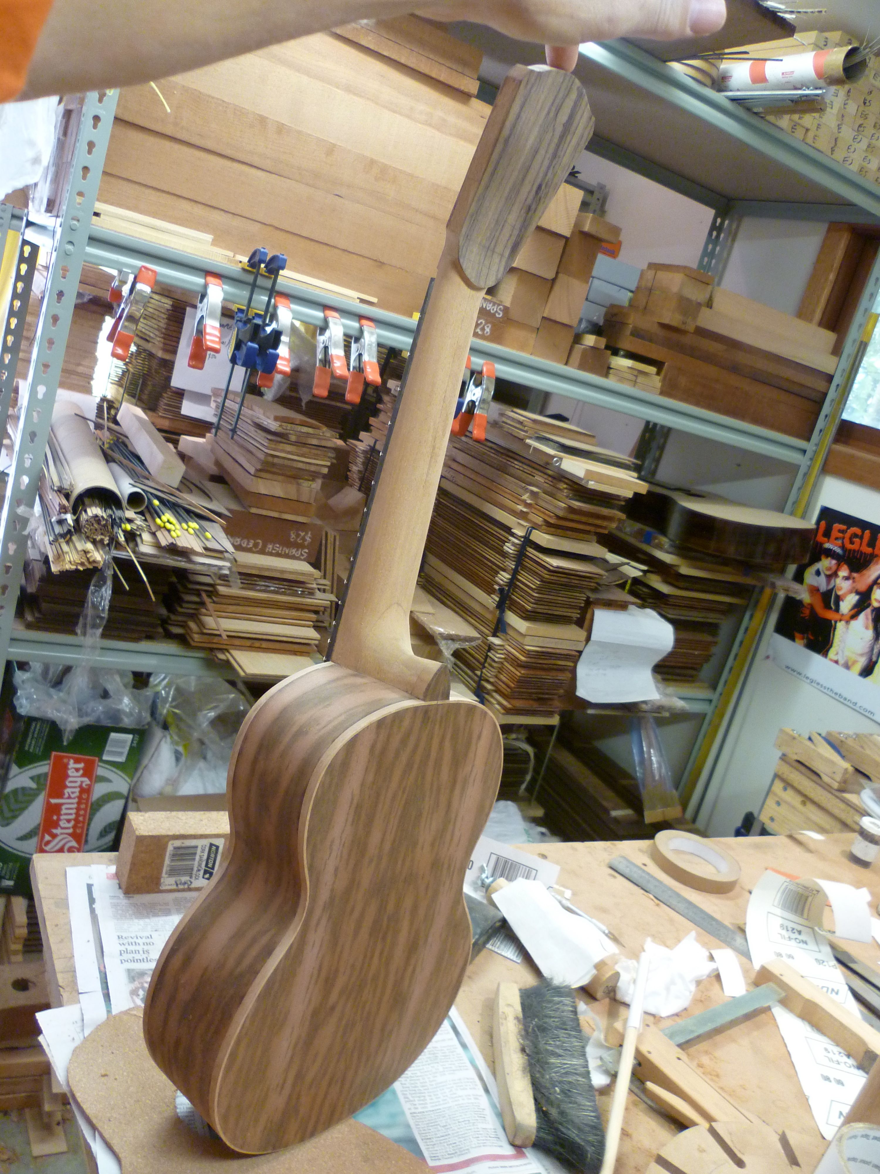

Post by kiwigeo » Sat Feb 11, 2012 4:09 pm

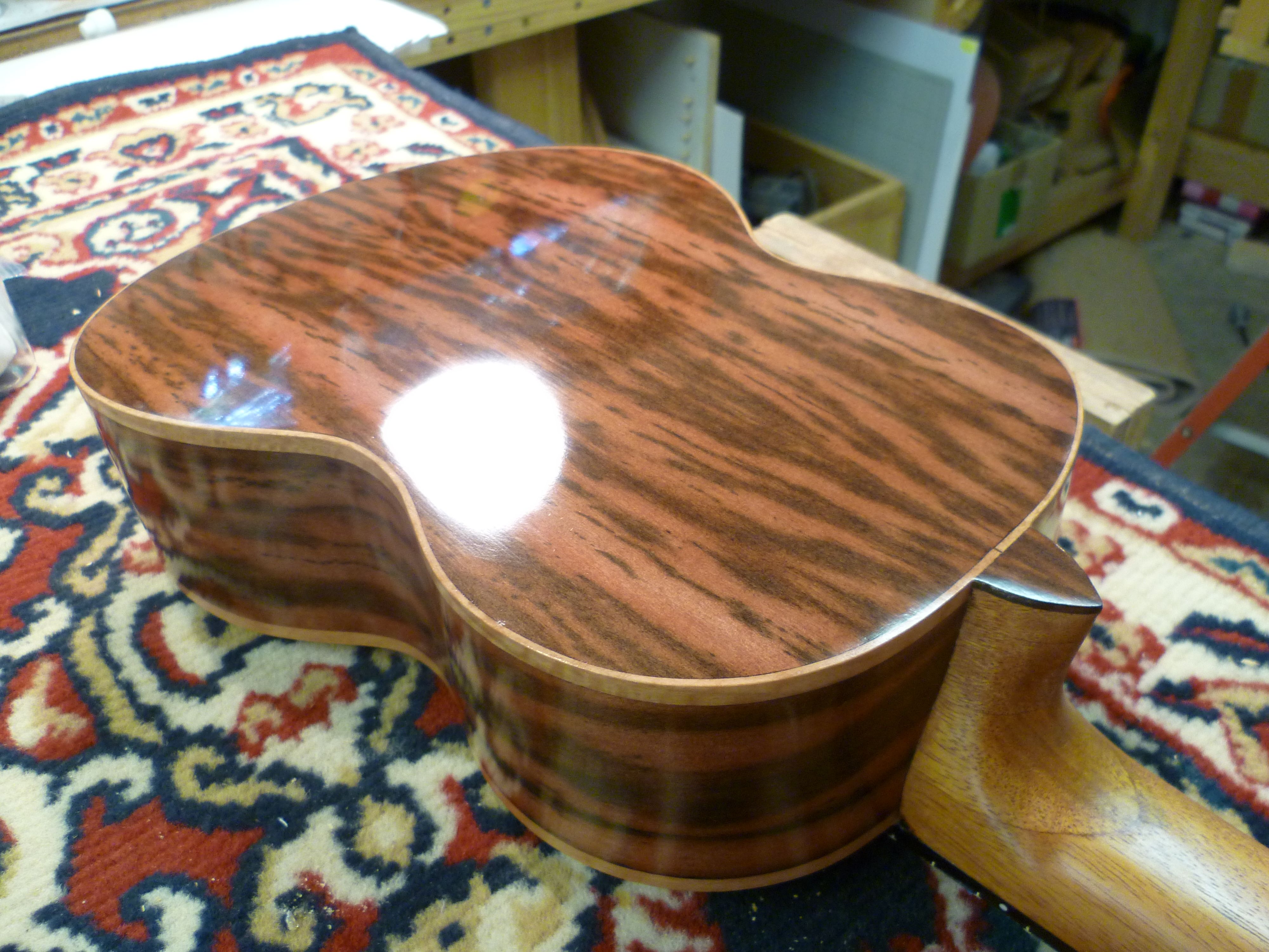

More delays at work so more progress on the uke. After tossing up between FP and a truoil finish I went for FP....mainly because it's what Im familiar with. After brushing on two seal coats of shellac (1.5lb cut) the wood looked slightly porey so I did a light pore filling session with pumice on the Tiger Myrtle and the mahogany neck. Pictures were taken after 2 bodying sessions on back and sides. Shellac is LMI super blonde and oil I'm using is walnut oil.
Post by auscab » Sat Feb 11, 2012 4:39 pm
Nice one Martin. Your sister will be happy with that.
Do you know if Walnut oil goes off after a while ?
I was speaking to a client about it ,she said she had an old bottle of it that I can have.
Post by kiwigeo » Sat Feb 11, 2012 4:49 pm
auscab wrote:Nice one Martin. Your sister will be happy with that.
Rob,
The walnut oil I use has a use by date on the bottle...usually about 12 months from date of bottling. Ive got a bottle thats 2 years old and its starting to smell like its a bit off. The stuff Im using on the uke was bought 3 weeks ago.

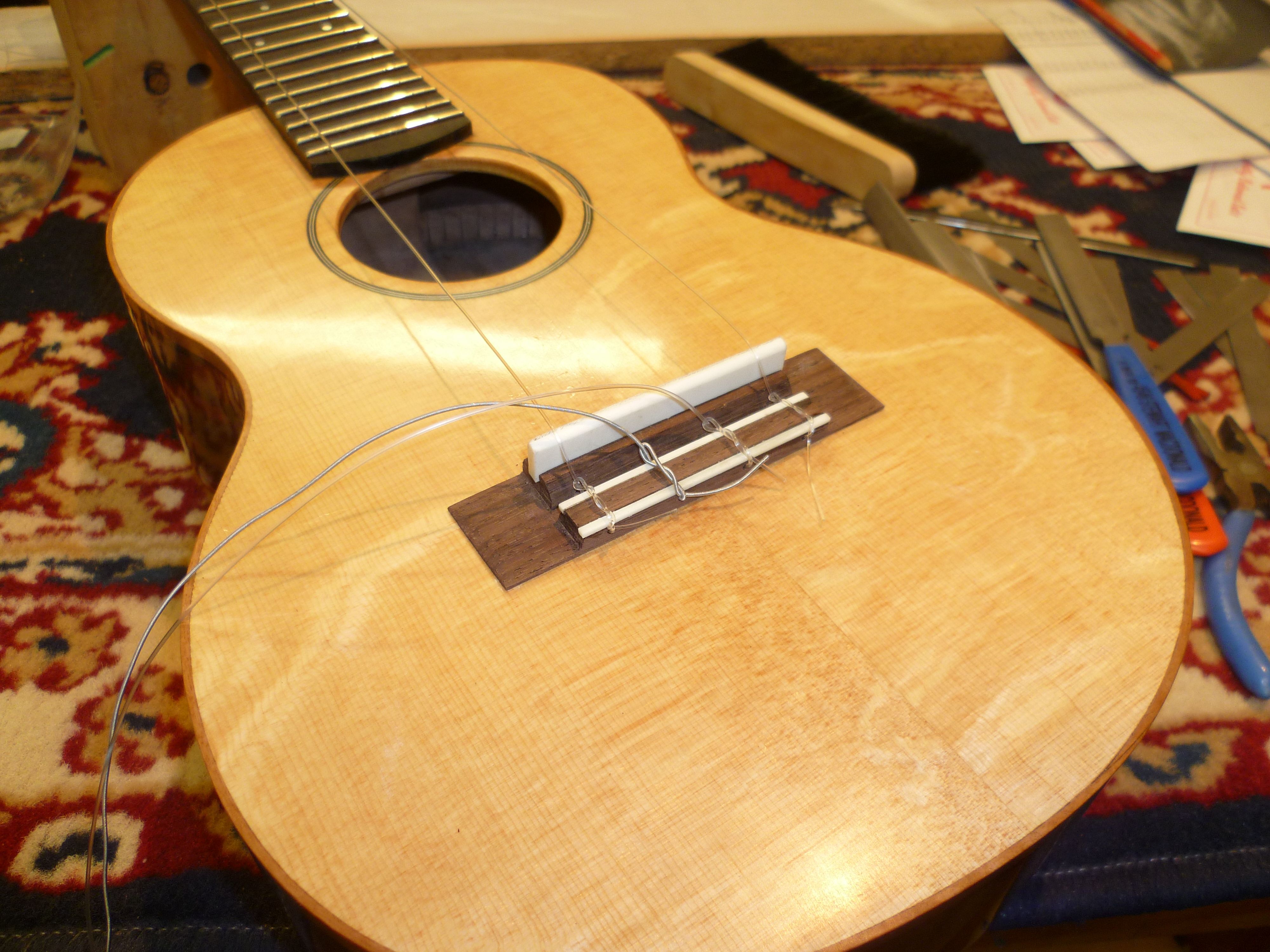

Post by kiwigeo » Tue Jul 03, 2012 9:50 pm
Another dragging project but at last theres light at the end of the tunnel. French polishing is finished and today I got the bridge on and nut and saddle roughed up. Tomorrow the instrument should be singing.
