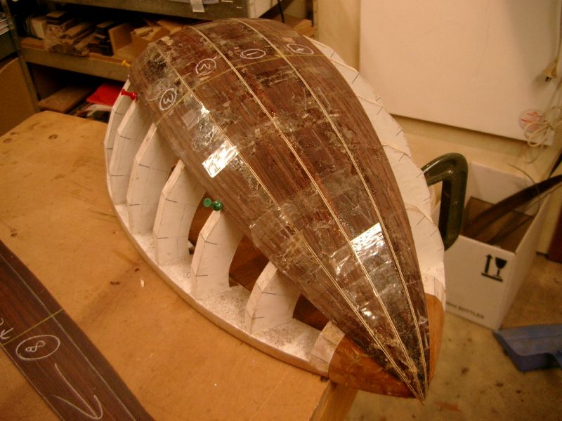

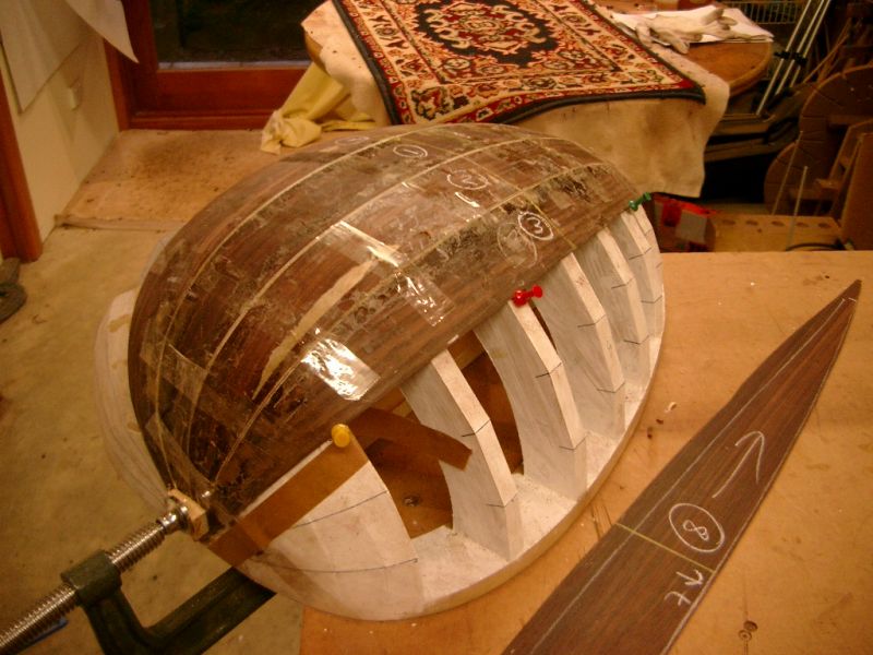

Post by kiwigeo » Sun Jul 05, 2009 5:30 pm
Rib No 4 glued in and back on track. Lots of glue all over the show...gave it a bit of a quick clean up before taking photos.
Post by Nick » Sun Jul 05, 2009 5:43 pm
It's starting to look sexy already Martin :)
Post by kiwigeo » Sun Jul 05, 2009 6:04 pm
Three rolls of binding tape and one large roll of sellotape used up so far.
One thing Ive discovered is that hot hide glue sticks like sh*t to a blanket...dont pick your nose half way through a glue up.

Post by Mongrel » Sun Jul 05, 2009 10:03 pm
Its great to see other people use tape like I do. When I tiled my kitchen, everything was taped up with masking tape. You locate your tile and tape them on.
Martin, do you think it would be a viable method for accoustic guitar backs? Would you end up with something like an ovation roundback. Would the bigger area equate to easier bending or just a bigger pain in the butt???

Post by kiwigeo » Sun Jul 05, 2009 10:14 pm
Mongrel,
If youre even thinking of making guitars with bowl backs then you need to book yourself into the nearest mental asylum. I dont know why they built instruments with bowl backs in the Renaissance....there was some fine art and music happening but I think they were also drinking alot of mead back then.
The size of the bowl doesnt affect ease of bending with a bowl back....the bending is the easy part, the hardest part is making the ribs fit together tightly. More than one Oud maker uses a solid mold....a much better option that using an armature mold as Im using but the latter is easier to make than a solid mold.
The only reason Ovation has succeded with a bowl back is because the thing is made of one piece plastic.
Cheers Martin
