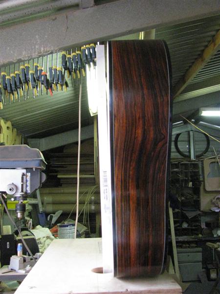

Post by Bob Connor » Wed Feb 04, 2009 7:38 pm
I sanded it back this afternoon and gave it the second layer of Z-poxy.
I really can't wait to get some finish on to this beast.

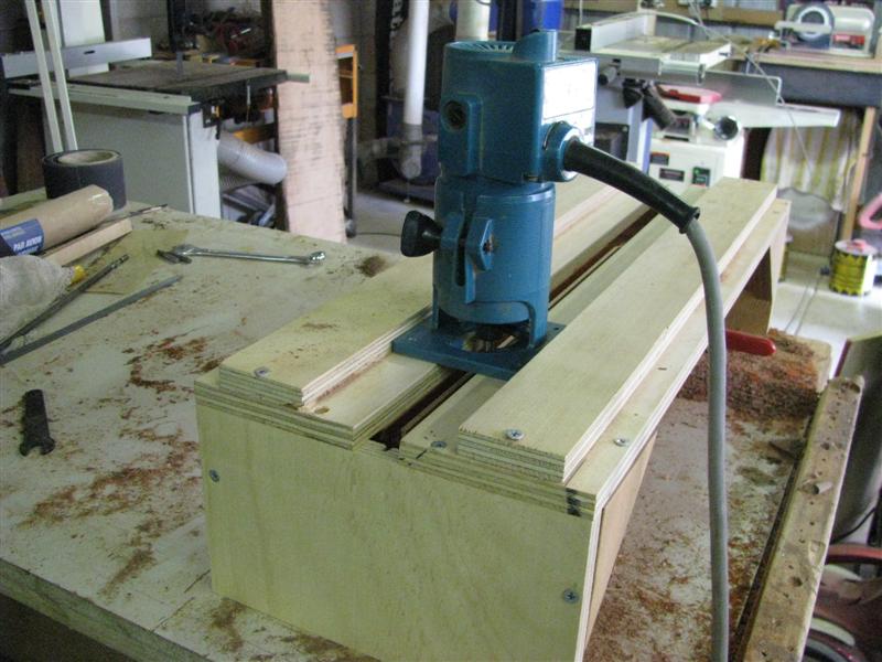

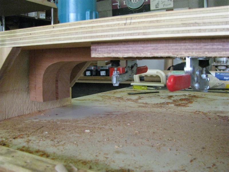

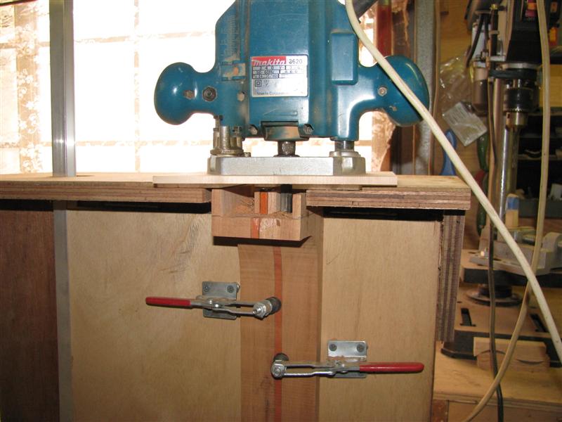

There's been one jig that I've been meaning to build for quite a while and that's to route the truss rod and CF channels in the neck. I've been doing it with a router fence up until his point but it has been fraught with danger and uncertainty. :lol:
So here's the jig. It took about 30 minutes to build.
Makes the whole process idiot proof.

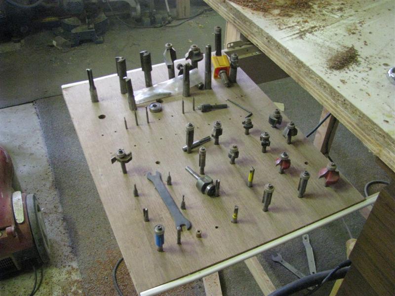

While I'm at it here's our router bit "drawer" made from a couple of drawer slides and a bit of plywood.

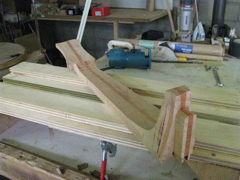

Once the truss rod slot has been cut we need to shift to the neck angle jig which is Paul Woolson's invention.
We sit the body of the guitar on top of the jig and adjust the bottom angle until the aluminium bar is around 1/16 to 1/8 of an inch above the soundboard right above where the bridge will be glued on.

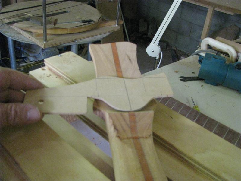

Once this angle is established I can rout out the mortise and tenon joints on the neck and the guitar body.
This is an extremely messy part of the job which generally ends up with me covered in sawdust.

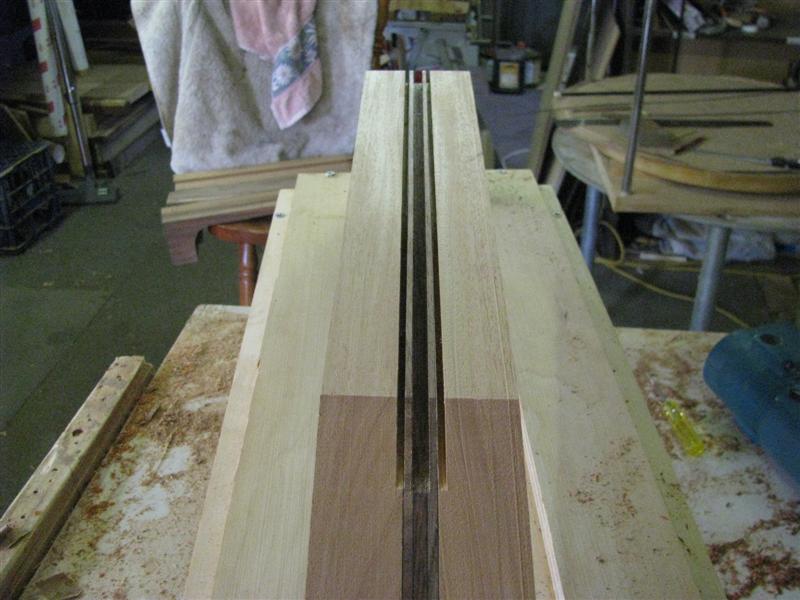

So this is what the neck is looking like at this point.

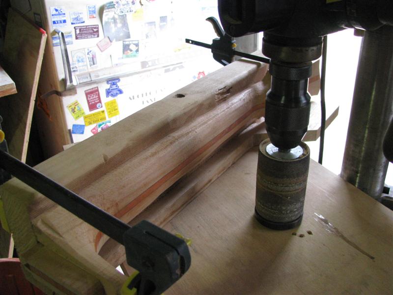

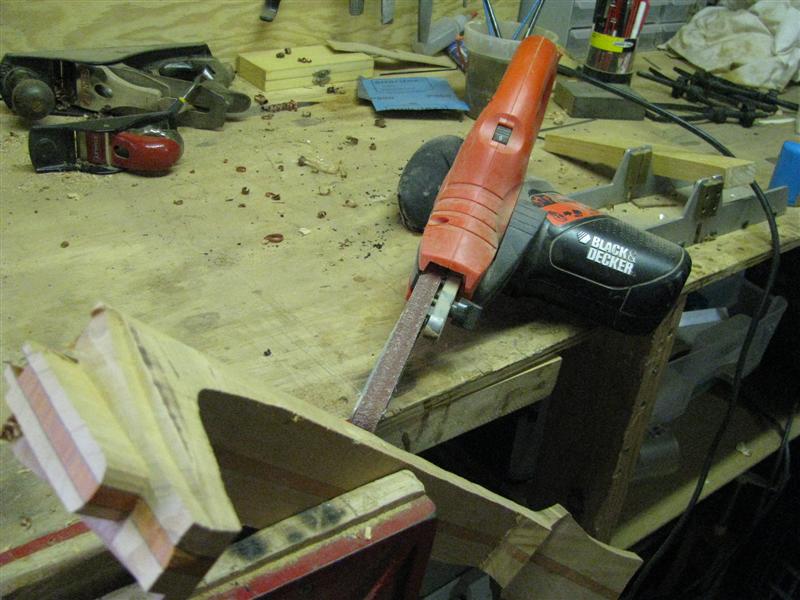

Next I'll rough carve the neck. Now anyone with romantic notions about neck carving being a relaxing part of instrument construction with the craftsman gently carving the neck with a whittling knife had better skip this step.
I use a Black and Decker power file which gives me the ability to have this sucker rough carved in about 15 minutes.
I have a template for the neck volute as well.

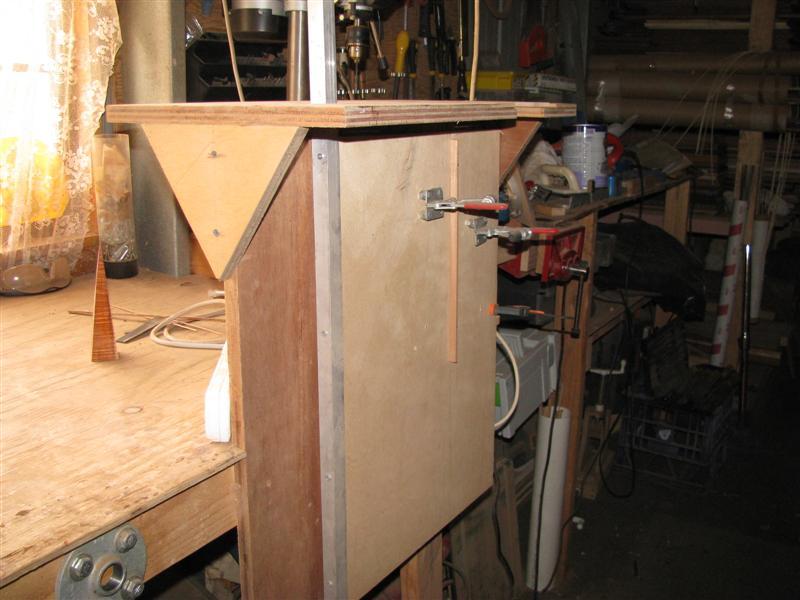

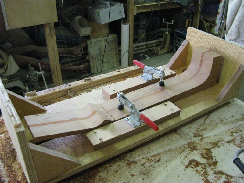

Once the neck is rough carved I'll throw it on this jig to get a uniform thickness up the neck.

What are you doing to get the spacing on all the channels in the neck Bob?
I'm cutting mine on the table saw, but where I struggle with this, is getting the alignment spot on with the channels I'm cutting in the bottom of the fret board for the CF rods that extend to the end of the fret board.
Post by Bob Connor » Sat Feb 07, 2009 8:13 am
Pencil line and eyeball Allen. :lol: Nothing too hi tech at all really.
But I'm just putting the CF into the neck, not trying to mate it into the fingerboard like you are.
Sounds like you need a notching arrangement on your table saw fence.
