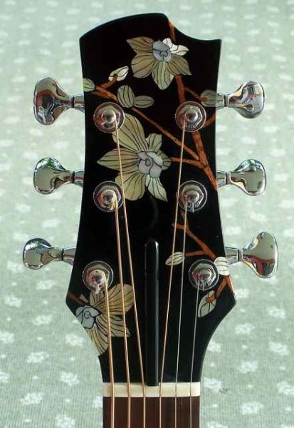

You can certainly practice inlaying different woods. The process is exactly the same, and it'll give you some idea of how to follow a line with the saw. This is the first time I've tried engraving, and I don't know if you would have much luck on something as soft as wood.
We've got a great source for shell here in Australia. It's MOP Supplies, and as far as I can tell, his prices are pretty hard to beat. A little goes a long way, so if you get an ounce of white MOP, it won't break the bank. Fret saw blades are very easy to break, and should be considered expendable. You can buy them by the gross for not much more than what places like Stew Mac are charging for a dozen.
I've got an email address for a local supply that a mate uses all the time. He swears by their product and service. I still have a stock of ones that I paid too much for, but if anyone is interested I'll pass it along.

The inlay looks fantastic Allen.
You must have some new calluses on your finger tip from holding the little buggers down while you're cutting.

The cutting wasn't too bad on the fingers, but the eyes are a different matter. I tried to use one of those large magnifying lenses on an arm, but I found that it ended up in the way more than not, so I bought a pair of 2.5 reading glasses from the local chemist. Too strong for me for reading, but bloody brilliant for this sort of work.

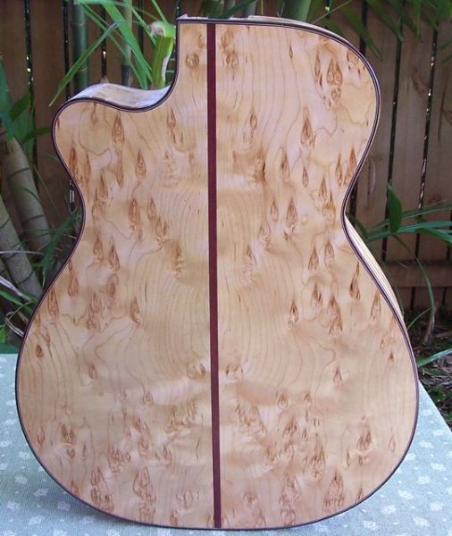

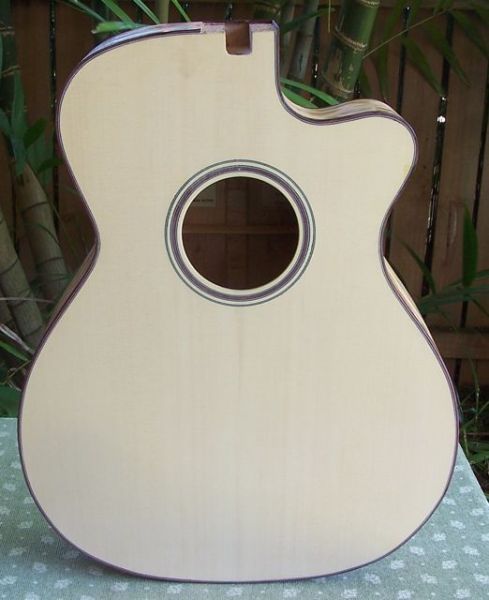

Body is bound, and the first epoxy pore fill is complete. There's not much in the way of pores to fill on maple, but there are small voids to fill in some of the birdseyes, and the epoxy really brings out the figure.

That birdseye is something else......and the purple too.

It's going to be a real Girlie looking guitar for sure. I had thought that this would probably be the case when I first saw the maple. But I'm really liking it, and I don't recall ever seeing an instrument that you would say was overly feminine. Hopefully someone else will like it as well, and it finds a new home.

Pore fill with WEST Systems. I've got a very accurate digital scale designed for mixing automotive paints, and I make up 5 or 10 grams of epoxy to do an instrument. Depends on the type of wood.

Hi Allen Ive been a bit slack in not following this thread, so I just read it from the start. Great work mate, I really love the inlay work very well executed and very well balanced, it just works well, love it.

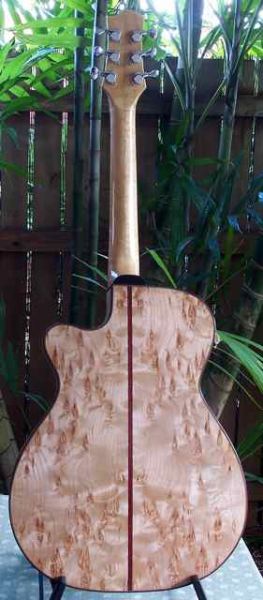

Post by Allen » Fri Mar 13, 2009 3:58 pm

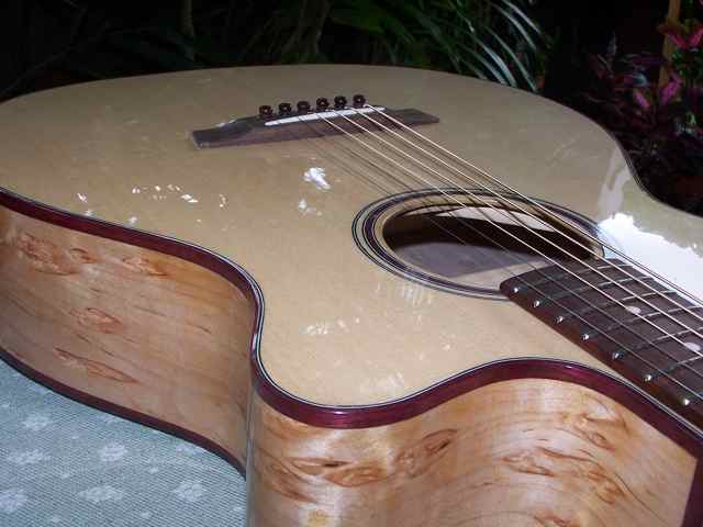

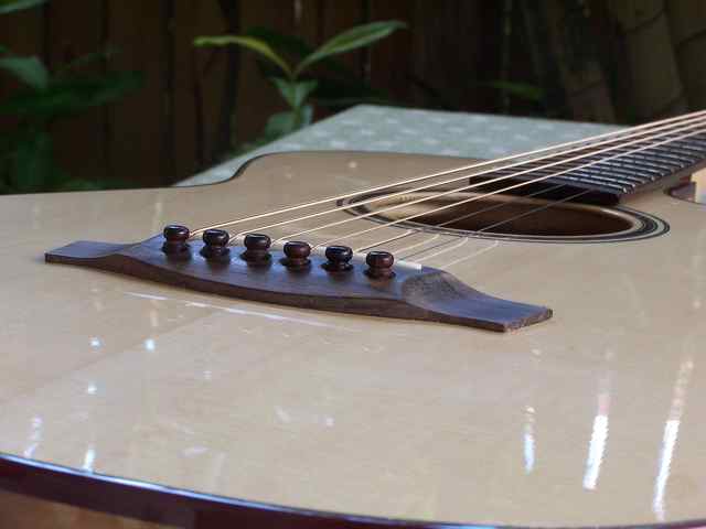

I've managed to get this one completed today. The lacquer had 4 weeks dry time while I was away, and it's really improved the sand-ability and buffing. I know that I should leave them all this long, but it's hard to just leave them hanging there, almost done.
I've set the action very low, and have just a hint of a buzz if strummed hard. I think that once everything starts to settle in that it should disappear, if not there will be some more tweaking to do.

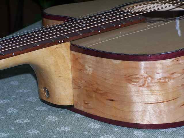

Does the fretboard just lay on the top?

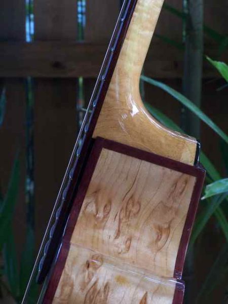

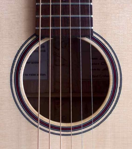

The fret board is fully floating for the adjustable neck. The cap head bolt that you see in the heel is the adjuster for the neck. You can see the evolution of this neck design in the "Adjustable Neck" thread.
There are 2 1/8 x 3/8 carbon fiber rods that extend all the way from the end of the fret board ( hidden by binding on end of fret board) through into the head stock. They are inlet into the fret board 1/8 of an inch, and into the neck by 1/4 of an inch. Makes the fret board from the 12th fret to the sound hole rock solid.
If you are talking about a down cut bit for the inlay in the head stock, then yyes, they are ones from Stew Mac.
And finally, yes, I rode the motorcycle from Cairns to Geelong, and back. 10,000 kms and a very sore posterior.

Hey Allen, love the inlay, the picture from the side looks great the way the light is picked up. The stems look like wood?

Very Pretty Allen. So if you want to change the action you just tweak that, is it a socket head cap screw?. What ever it is I assume you just tweak it and you action is back down.
