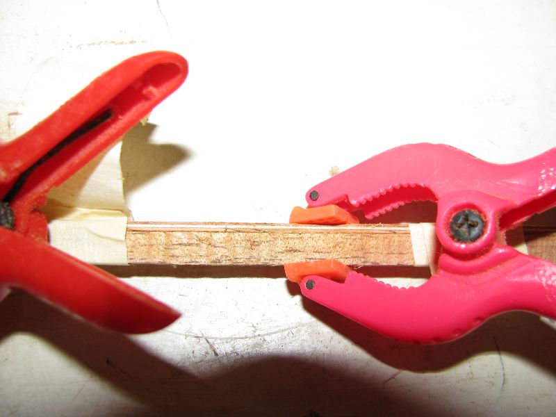

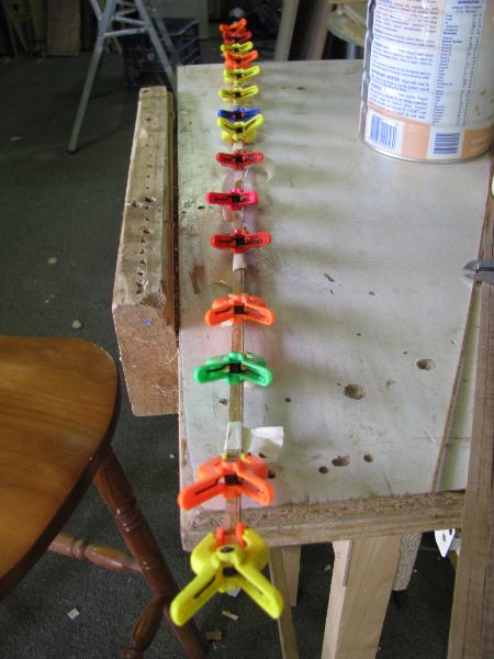

My own humble contribution. I bound my first fretboard. Cooktown Ironwood and Ivoroid.
What I didnt do was cut the fret slots wide enough, so now I have a radiused fretboard :oops:
Apologies for the photos but you get the idea....
ya live and learn

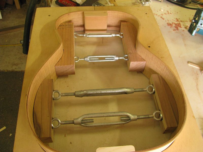

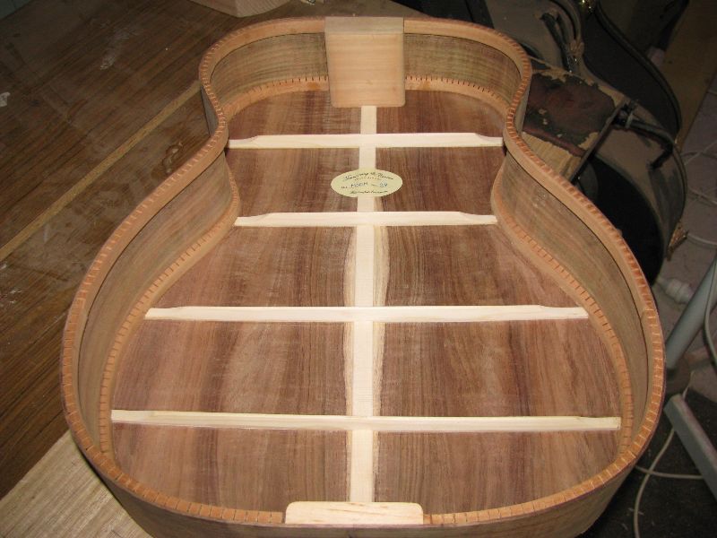

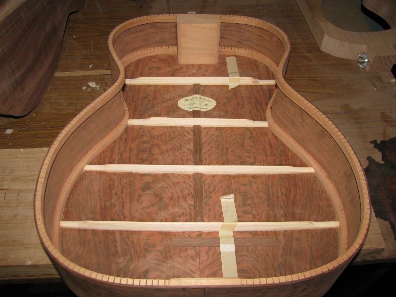

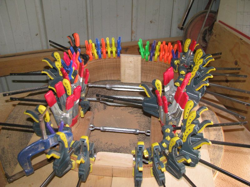

Got the backs on a few this week.

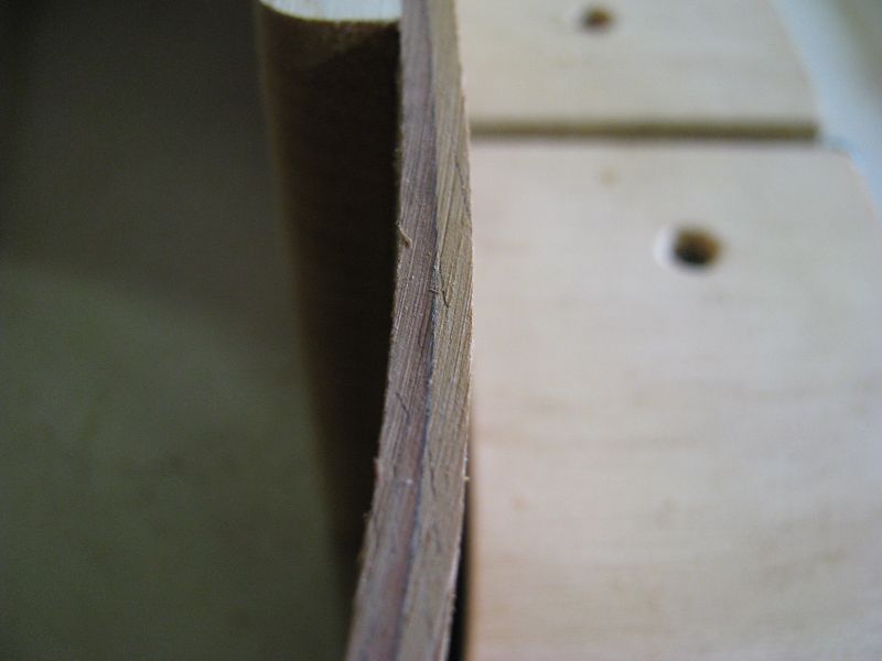

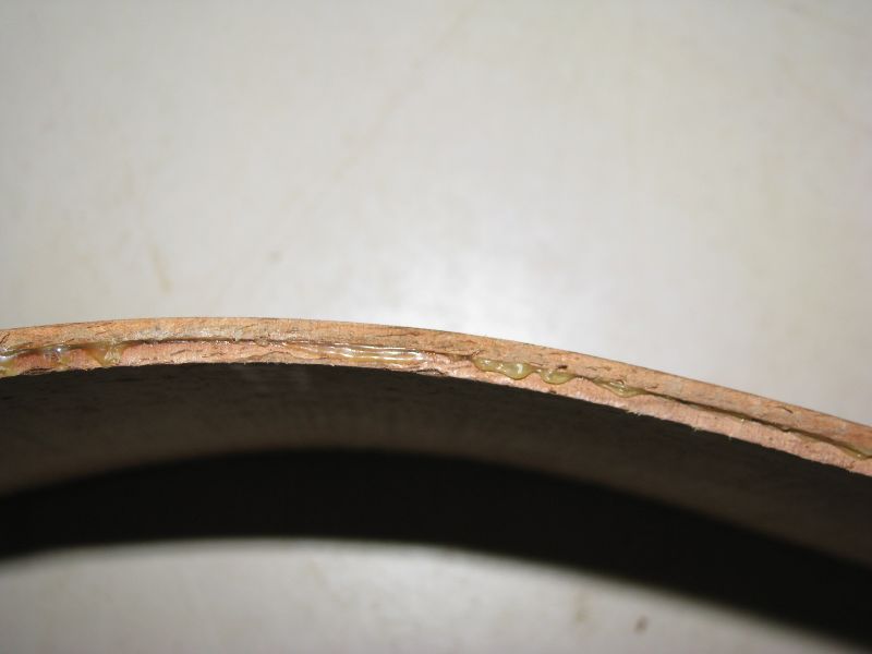

This one is interesting.
Our thermometer was measuring low and Dave scorched a side set.
He decided to bend another set and glue them together. They're pretty stiff as they're .17" or about 4.5mm thick.
They're glued together with Titebond not epoxy as most people do when doing double sides.
I was talking with Zootman about this and we decided it may be possible to glue the sides together flat and then wack them in a bender. The glue would melt while the bending was happening and then re-glue when cooled. Shouldn't be a problem with such a large glueing surface.
I'll report back when we've tried it. However I think well take the imdividual sides down to .040" or thereabouts.
Here are those sides getting the linings glued in.

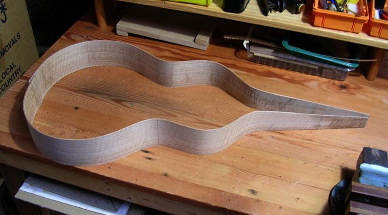

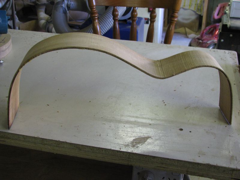

This weekend I successfully bent the two new sides for the Weissenborn guitar I started. This proved far more effective than the first attempts.
I took everyones advice and was more successful on this attempt. I reduced the thickness of the sides to 2.3mm, sprayed the sides with water, then wrapped in paper towel and aluminium foil. I also had my wife Maggie control the temperature of the blanket, turning it off and on to maintain a temperature of 150º C until the bending was complete.
Thanks Tim for sending me the new side material.

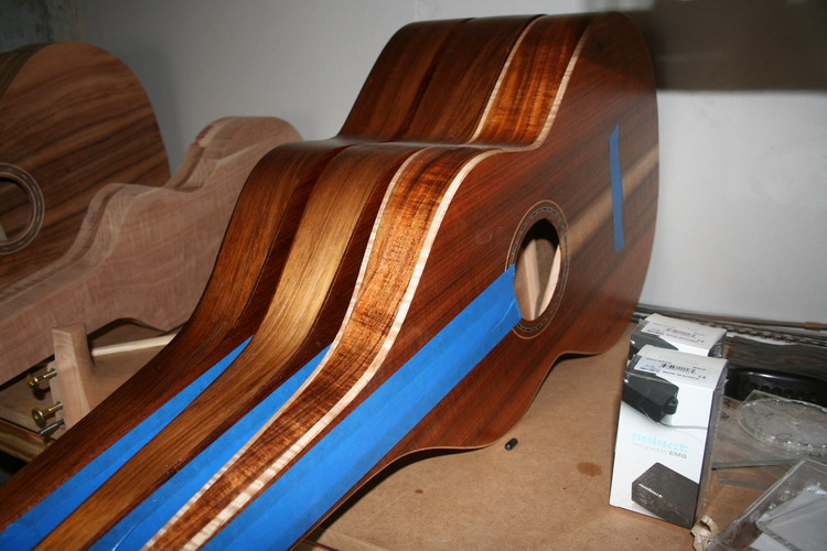

Spent a week finishing guitars about two weeks back so they're all now at a stage where they can be completed. All three are Blackwood with satin finishes, one with Maple binding. Two Qld Maple electric lap steels are behind them.

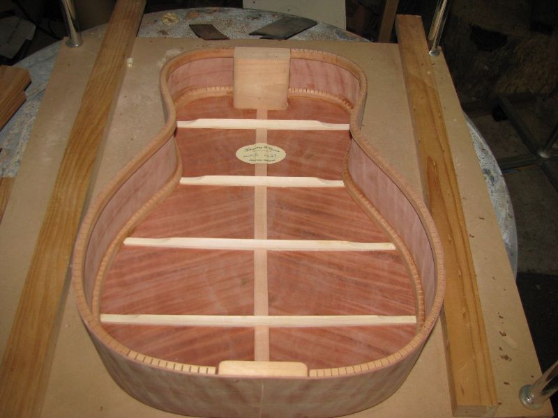

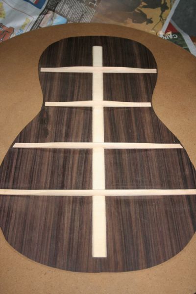

Finally got started this week on only my second steel string for the year... EIRW 1-18.

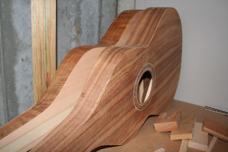

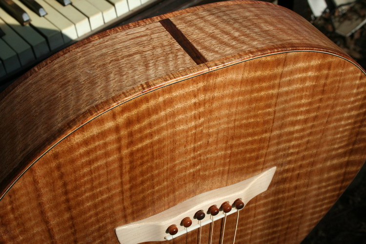

An Alpine Ash build which I finished alongside the batch of Blackwood guitars above.
Closeup of the Alpine Ash build to show the binding scheme. Went with a light Blackwood look which I think turned out differently though better than I expected.
