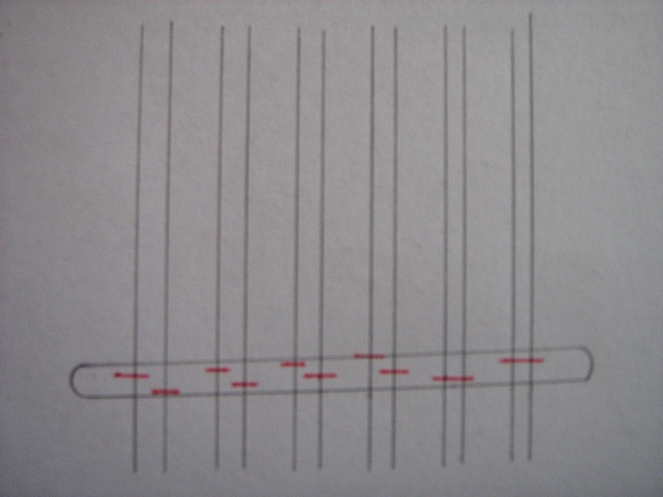

Okay I finally got the compensation sorted. In case anyone is interested results were as follows:
String (guage) -compensation
1 (0.010") - +3.5mm
2 (0.010") - +3.5mm
3 (0.014") - +6.0mm <== not a mistake
4 (0.014") - +6.5mm
5 (0.023") - +3.5mm
6 (0.008") - +2.5mm
7 (0.030") - +6.0mm
8 (0.012") - +4.5mm
9 (0.039") - +8.0mm
10 (0.018") - +6.0mm
11 (0.047") - +6.0mm
12 (0.027") - +6.5mm
Scale length is 25.3" (643mm).

That's really interesting Martin. How did you handle that much difference between 1-2 and 3-4? Wide saddle or split saddle?

Are these results with strings at final playing height?
2-3 and 9-10 look really suspicious and I would not expect 12 to be longer than 11
Posts: 1090
Location: N.S.W. in the bush
Post by Craig » Tue Sep 23, 2008 7:01 am
Martin ,
I agree with Jeff , the figures don't seem right to me at all ! .
I'm trying to think of where you may have gone wrong. Your nut slots pictured earlier look to be way too high to be able to do the intonation correctly. Maybe ,that's part of it ??,, or your tuner ?,, or wolf notes ?, or that 'intonator thing '? It may be a combination of one or all !
12 and 11 can't be right ! , and the A string longer than the E ???? . The high "G" needs to be way forward also .
Take another good look at my notes on your 12 string compensation thread . Did you not read it ??? :lol: The saddle positions should look a lot like this :
Also note Alan Carruth's 12 string saddle compensation to be virtually an identical pattern
I'm hoping you haven't already slotted the bridge ! :?

Okay you can stop bldi panicking you guys. I've routed the slot but its a bldi 5.5mm wide saddle so there's heaps of leeway for ridge positon on top of same.
Yes the nut slots are way high. I dont cut them down to final depth until saddle is in. I rough out intonation only to work out where to cut the saddle slot. If I was using a narrower saddle I'd cut the nut slots to final depth before fitting saddle. There is method in my madness.
Jeez youd think I'd just destroyed the guitar....

I suspect you are probably 1.5mm too long on all your compensation lengths due to high nut slots and or high strings at the saddle.

kiwigeo wrote:Okay you can stop bldi panicking you guys. I've routed the slot but its a bldi 5.5mm wide saddle so there's heaps of leeway for ridge positon on top of same.
No there ain't ! . Not on a fully compensated 12 string. As you can see by my above pic , You'll need the full 5 mm. to have it intonate correctly.

Ive got the saddle fitted and have been fiddling with intonation on bass E pair, top E pair and the G octave pairs. All intonate ok with exception of string 11 (low E slightly sharp) which needs to go back a fraction on the saddle and the G octave (string 6) that is right at front of saddle and could move a fraction forward (slightly flat).
The end analysis.....saddle needs to rotate a fraction. Anyway Im going to string up the thing because I cant wait to hear what it sounds like and then do a saddle slot fill and re-route job. Ive already done one of these this week so might as well get good at it.
Just for the record I totally f***ed up the saddle job because I didnt pay attention to Craig's detailed and learned instructions. Ive got big time egg on my face...but the whites will come on handy for my next pore fill job.

So, what do you think has been the stuff up Martin? String hight?

Root cause is relying on working out intonation myself with nut slots not cut to final depth (= strings too high) and then positioning saddle slot based on same.
