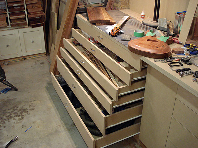

Dominic wrote:Hey Stu, what drawer slides are use using for the 1200mm drawers?
I ordered a bunch of heavy duty slides from Timbecon. I was going to use them for the bigger/deeper drawers and use the lighter white ones for smaller drawers.
I'm using the crappy Bunno's white sliders at present and they're holding up just fine.
I built a mix of drawer sizes with the top 4 being 100mm height and the
others get larger. The other set to the right are larger in height again from 150mm to 250mm.
The carcases are 16mm melamine and everything else is 16mm mdf
including drawer sides and bases. The top is two 16mm mdf sheets glued and screwed to 32mm thick.

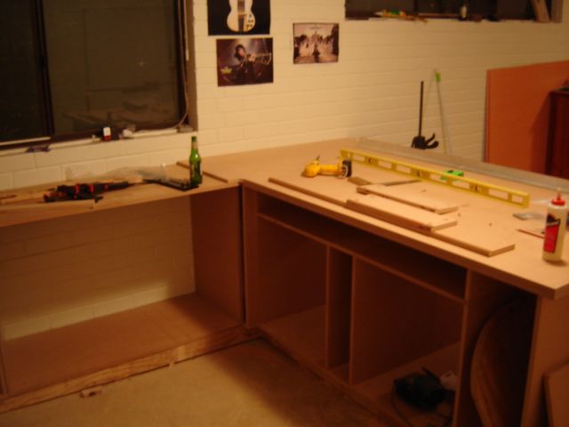

Been busy at work lately but have managed to get some work done on the new workshop. I have thought very carefully about what needs to go into the spaces. I would like to be able to have a clean bench with everything away. I want to keep the surface area that dust can cling to to an absolute minimum.
First I levelled the base for a large L shaped bench. It is 600mm wide against the window and 1150mm on the rest so there is heaps of space there.
Then I have built different sized boxes using pocket holes to house drawers of different depths and widths to store all my tools, jigs etc and cupboards for bigger stuff and these are screwed together to form a flat bench top around 900mm high.
I add another layer of 18mm mdf to the top of that and I found some laminex at the salvage yard which goes on top for hard wearing protection. This will be edged with hardwood.

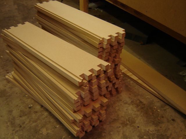

Next I tried out my new dado blade and cut all my drawers with box joints. Once the jig is set up its easy. And the bits just go together so nice.
I love my new table saw.
Here is a pile of drawer pieces ready for assembly with bases slid into the dadoed groves and glued. Note the two piles have offset pins and grooves. Thre are more piles of bits around the old workshop waiting to be put together.

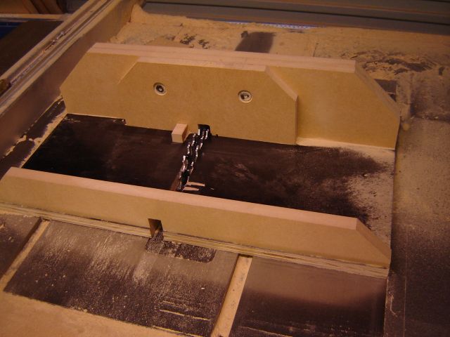

Here is the jig with the dado blade. If you haven't seen box joint jigs, you slide the jig back and put your side up against the pin next the the blade and push the jigs through the blade. Then you put the new dadoed groove over the pin and cut the next slot and on. The mating piece starts with a groove and not a pin so the bits mate.

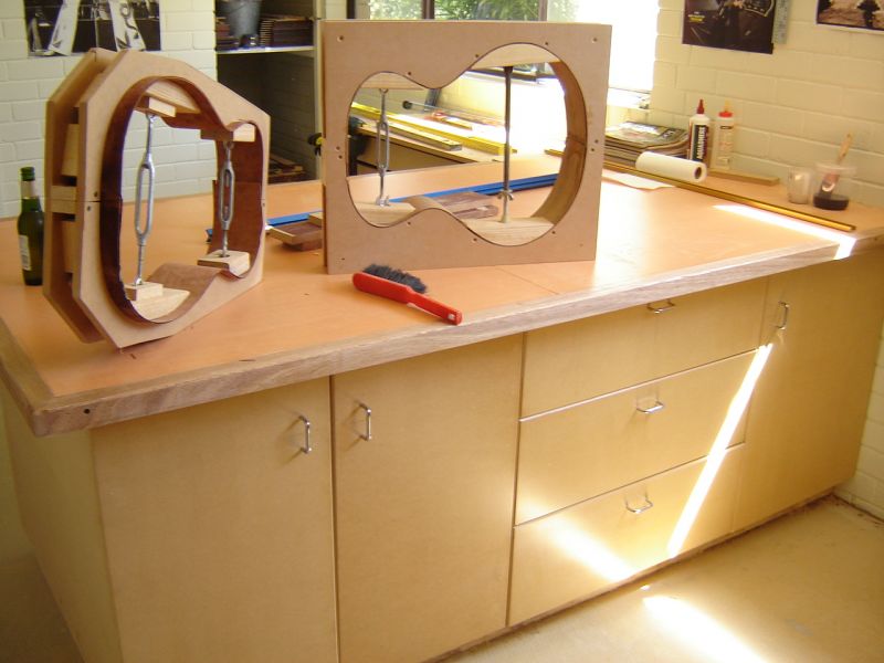

OK, after the wounds from my fight with the table saw healed I got back on track and have nearly finished the big bench. Here are a couple of pics.
These draws have heavy duty bearing slides that are full extention and smooth as. I can keep all my power tools I them and they stay smooth with the weight.
The double cupboard is about 500mm deep, half the width of the bench top but the single one is about 1100mm deep so i can store weird long stuff.
The top is 2 layers of 18mm mdf with fake wood grain laminex on top and hardwood edging.

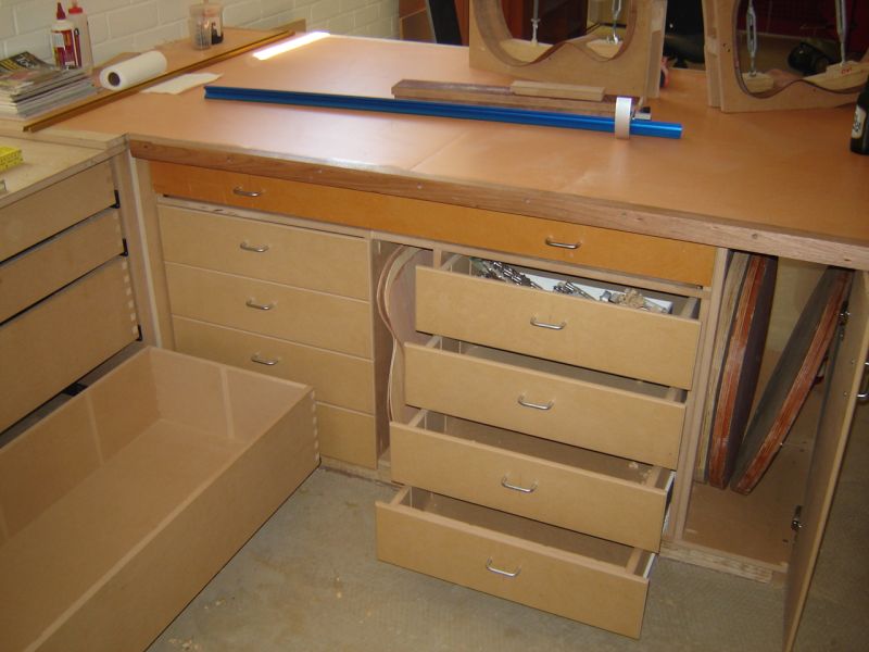

This is from the other side. 8 small drawers with lighter weight slides, a narrow cupboard for dishes and one very long drawer under the top with heavy duty slides so i can keep all my important tools right there where I need them.
The drawers on the left have not had there face pieces put on yet and you can still see the box joinery. The faces cover up the gaps and make it easier to get everything lined up. And I have to finish the bench top but I want to get a sparky to put a sub main for the whole workshop in near here so that has to get done first.

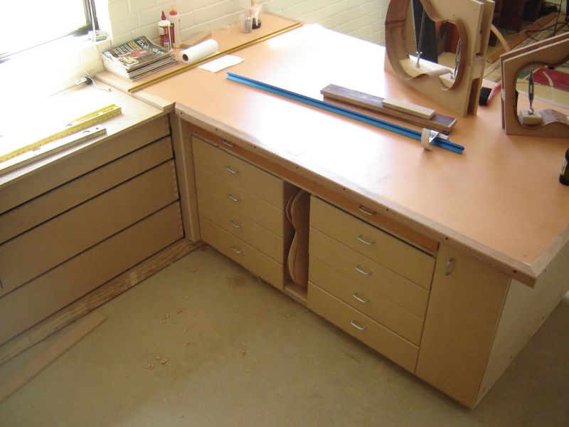

Another angle. The 2 big drawers on the left can easily hold an guitar. You can also see the dadoed grooves in both big and small drawers. All the drawers have grooves so I can fit dividers later on if I want.
