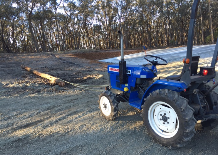

Working away sorting out drainage ect, using logs, clay and mulch to redirect rainwater away from the site.
Mulch is product from branches that were cut down and some logs were put aside from the area to use later, so it's all part of the original landscape, just going back slightly different.

I'm wondering how you are using the logs. Are you burying them? I would be worried about them attracting termites.

The logs are simply a retainer/boundary for the clay and mulch which is redirecting rainwater.

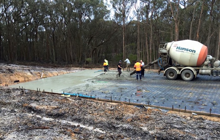

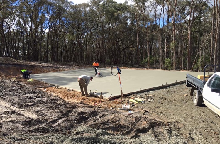

Slab was poured nearly three weeks ago so there's no changing it now, you can just see it in the background of the tractor pic I posted two weeks ago.
