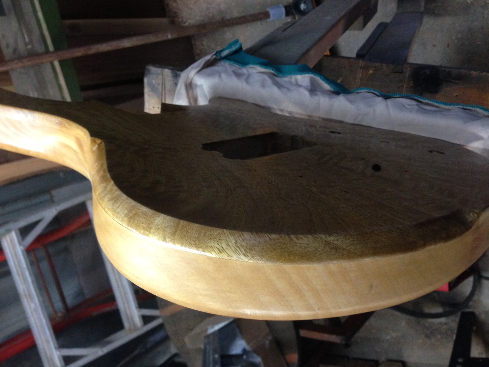

I was going to use poly for the finish but after finishing a timber gift box in shellac I used that instead and built it up to a nice lustre. I'm not sure how shellac will wear over time, however with the popularity of road worn/vintage gear it might just fit it!

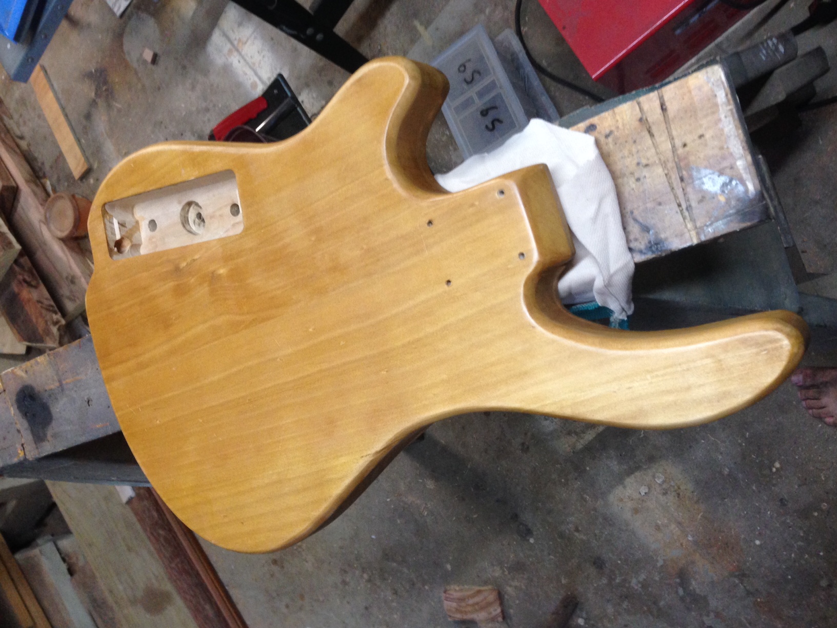

Post by Mat » Thu Jan 14, 2016 10:06 pm

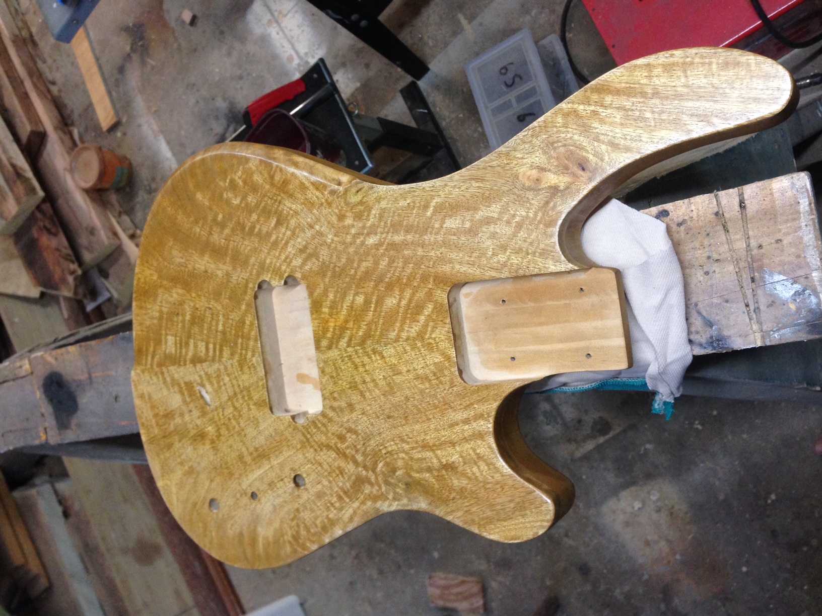

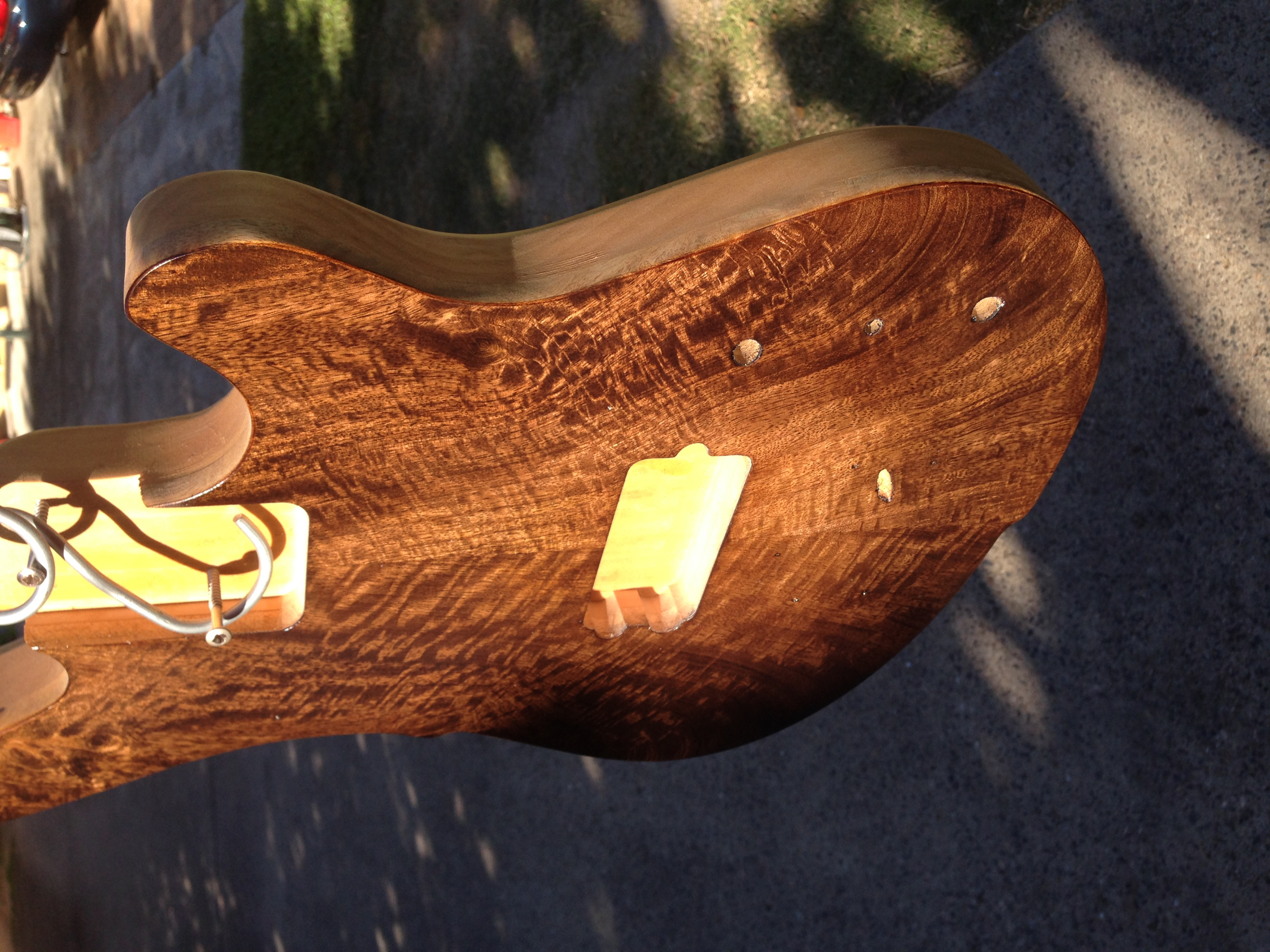

I sanded off the shellac and decided to stain the top. The result is much nicer.

Re: Electric Bass Timbers
Post by slowlearner » Fri Jan 15, 2016 9:07 am
That looks FANTASTIC! Well done. :)

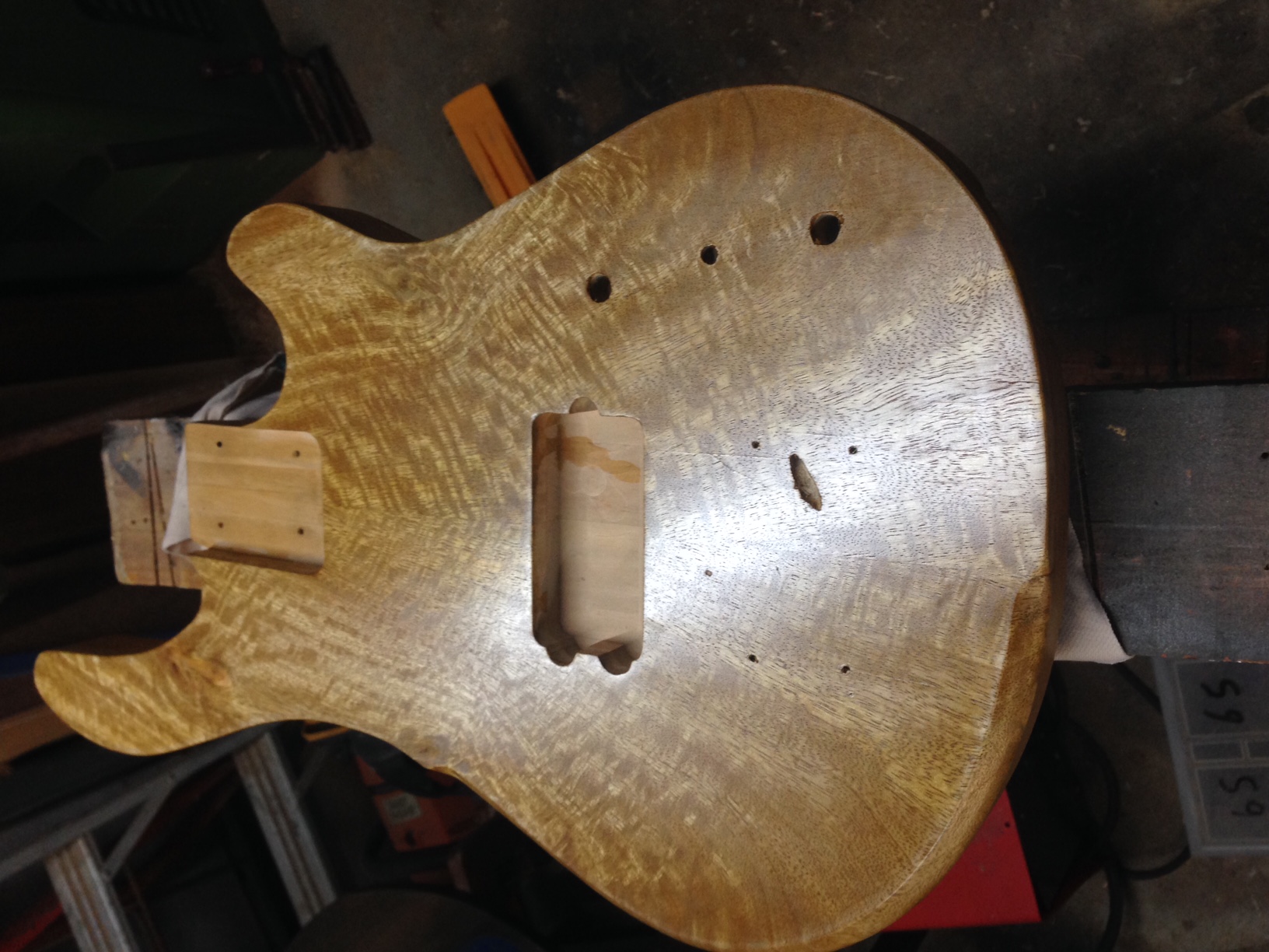

Post by Mat » Tue Jan 19, 2016 6:58 pm

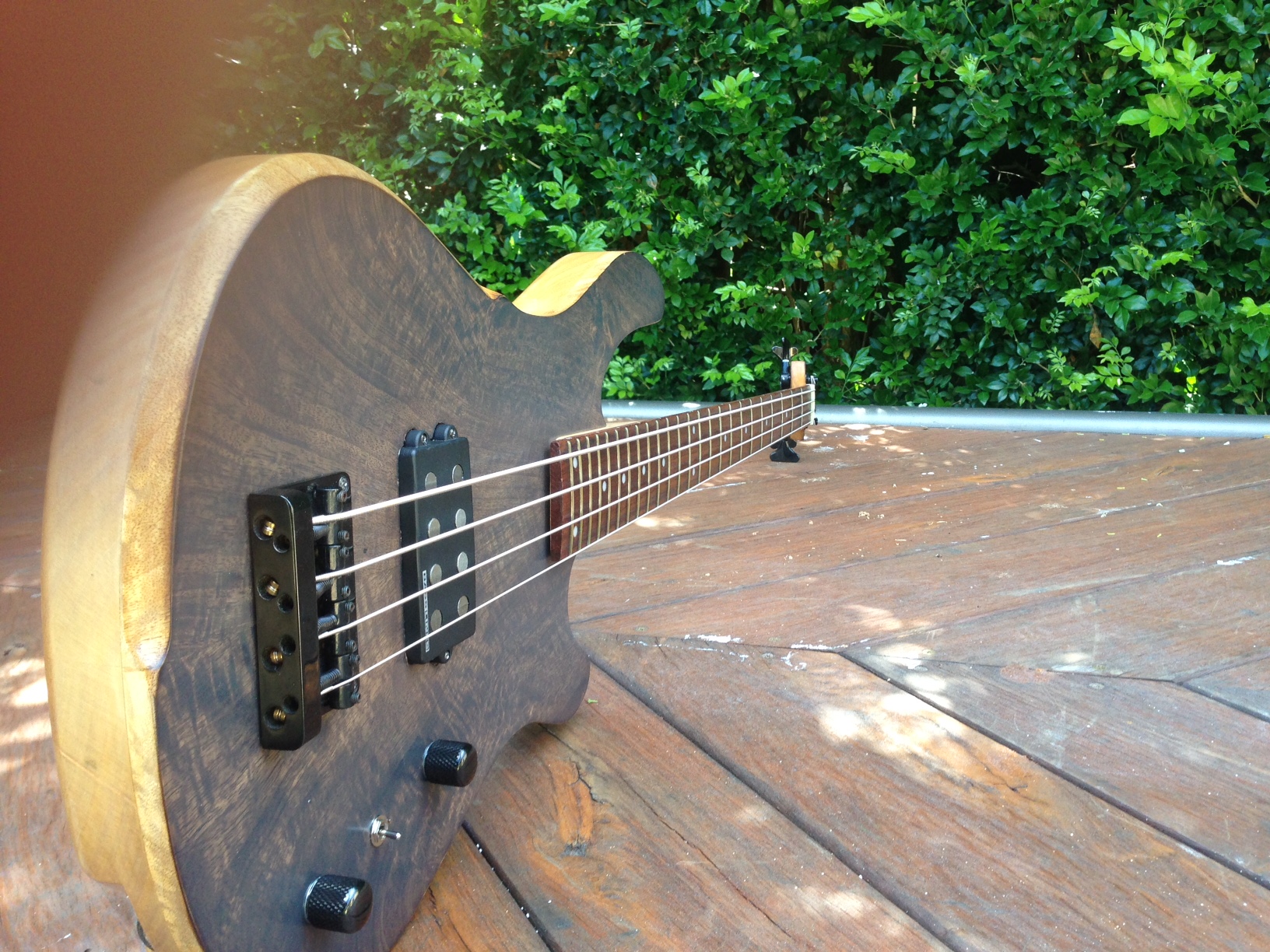

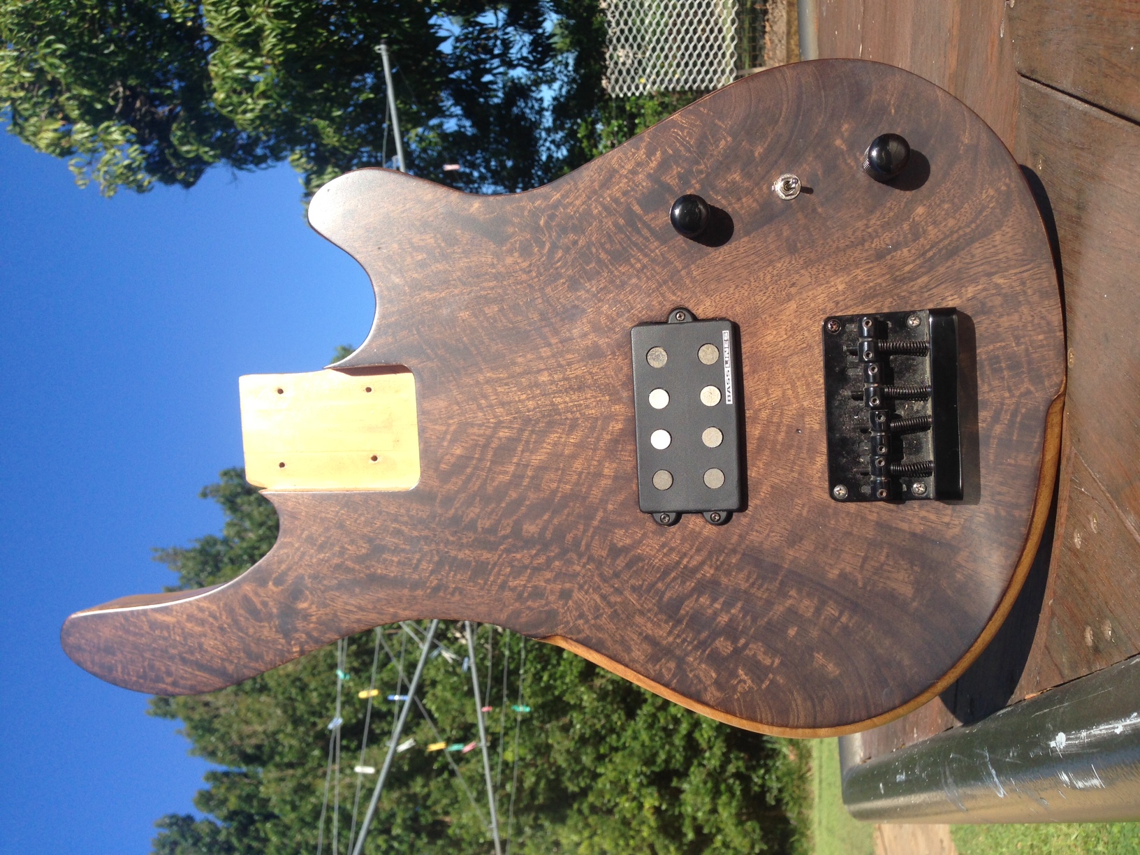

Here is the bass body with wiring done.
It does have a slight buzz so I'll have to double check my shielding. With shielding how shielded is shielded? If I have a small gap here and there will it buzz or could it just be the wiring?
Can't wait to hook it up to a decent bass amp and see what comes out of it.
old_picker
Posts: 184
Post by old_picker » Tue Jan 19, 2016 11:00 pm
did you ground the bridge?
get the earth and hot reversed at the jack?
regardless of the shielding you should get negligible buzz with that type of pickup.
the shielding should be uninterrupted and continuous in the cavity, cover and the pickup route - the cavity cover should be shielded and earthed by a copper strip into the cavity walls - all should be earthed to the back of a pot or the jack -
nice bass :)

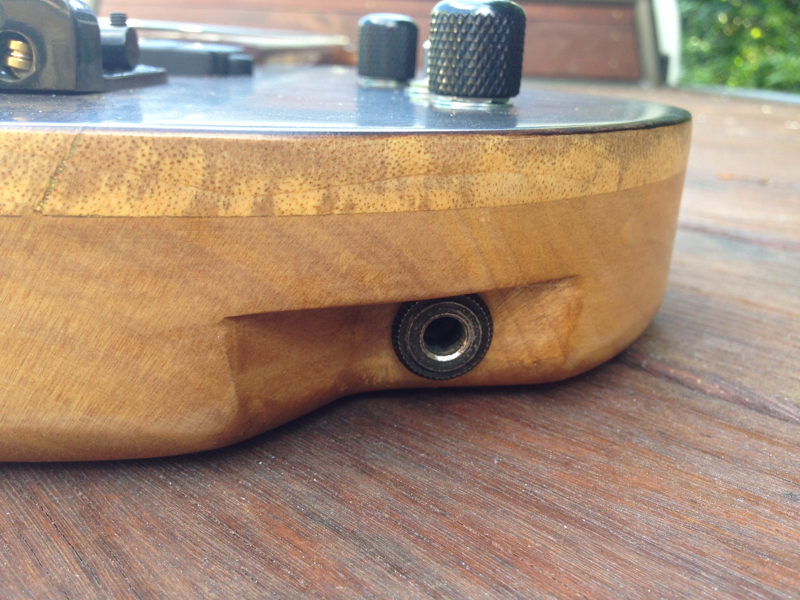

Post by Mat » Fri Jan 22, 2016 9:34 am

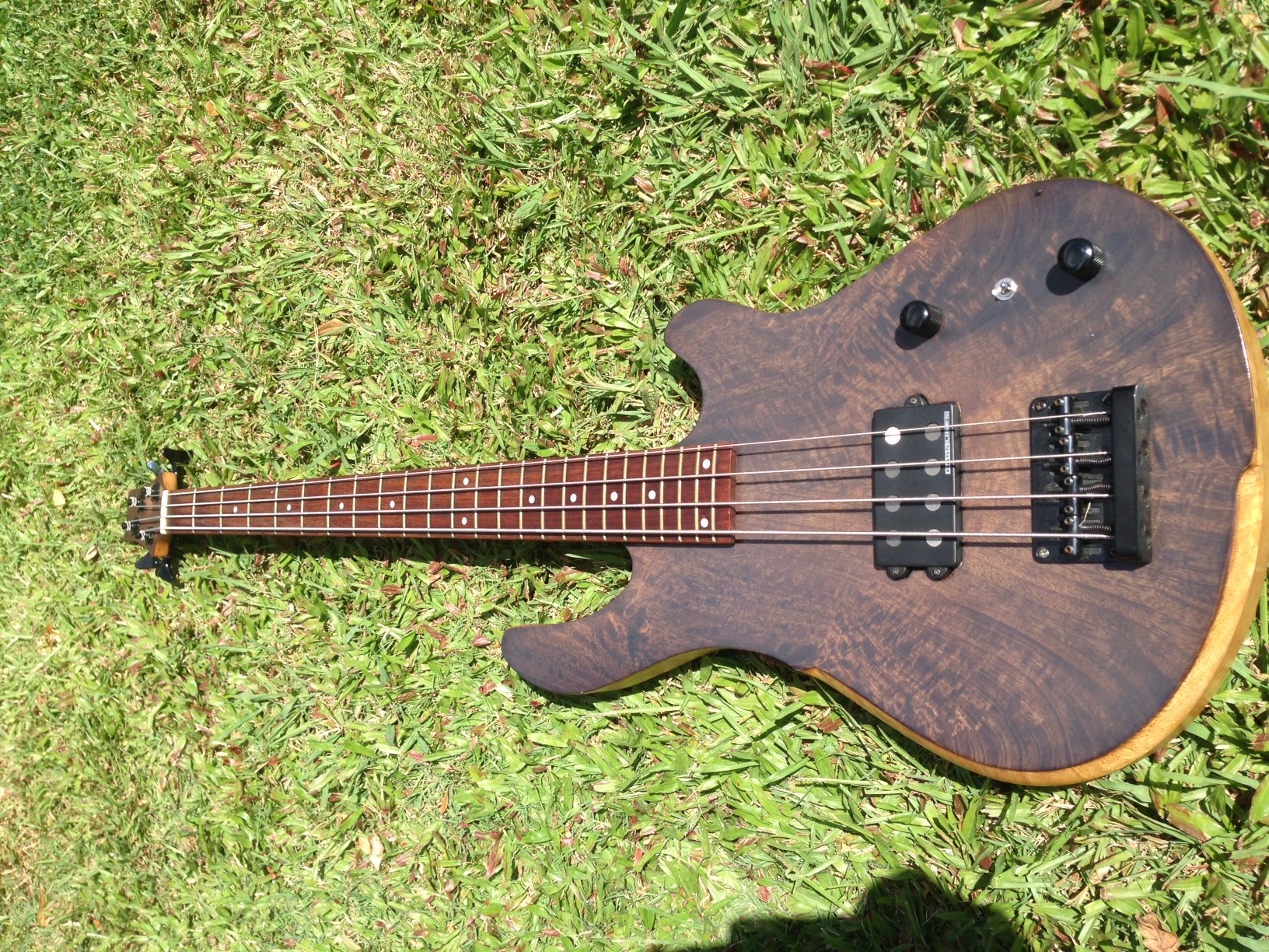

I worked it out!
I had the pickup wired wrong to the mini switch. Being that I didn't know which side of the pickup was which I have the + & - hooked up incorrectly so it was effectively making hum. This was of course after I rewired the pickup with shielded wire and added more shielding to everything. Needless to say once i reversed the wires everything went silent and only sweet bass noises come out.
And here she is finished. I'd like to thank everyone again for this input on timber selection, finishing options and electronic knowledge. I'll be starting my next bass sometime this coming week. So I'm sure I'll have more questions.
