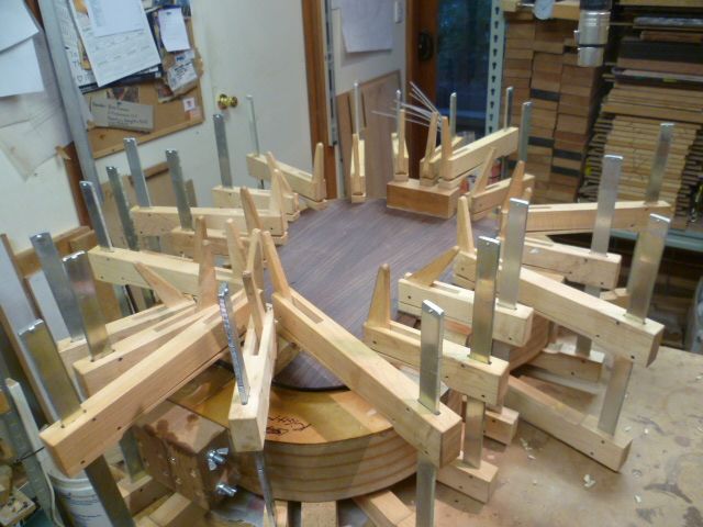

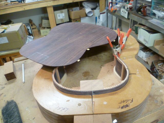

Post by kiwigeo » Mon Feb 17, 2014 9:59 pm

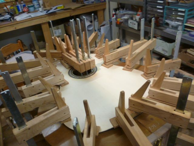

Today's activities. Final preparation of back and then gluing of same to sides.
Trimming neck end of top back to side to allow easier line up during glue up.
Repair job on some split kerfed lining adjacent to brace slots. Most people wouldnt bother but if it's visible through the soundhole then I fix it. The white square on the back is the outline of the headblock to aid location of clamping caul.
One can never have enough clamps!

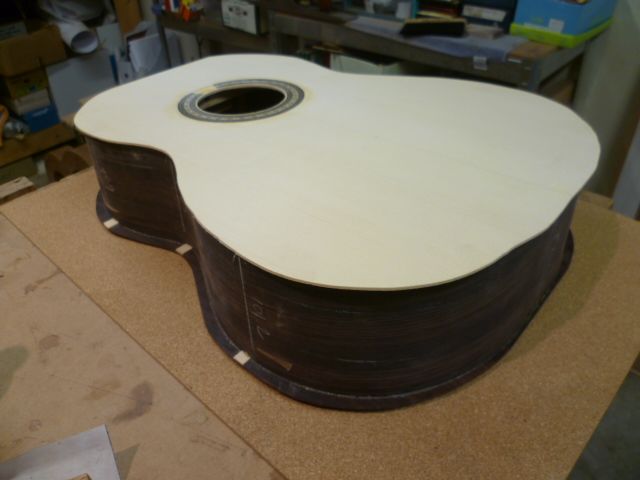

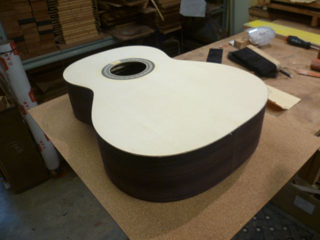

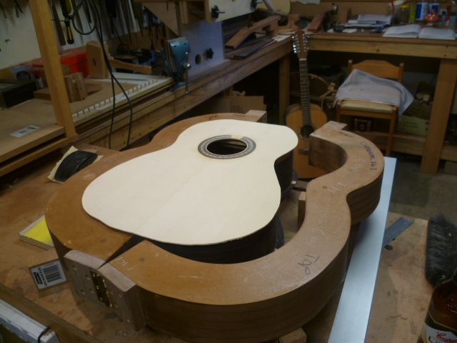

Post by kiwigeo » Tue Feb 18, 2014 8:11 pm
On a roll......all boxed up.
Top glued up
Out of the mold!!

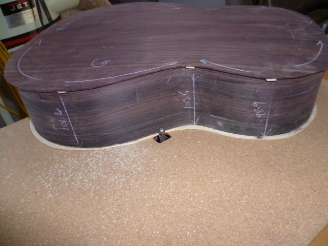

Trimming the back and top overhangs on the router table. Im using a 1/4" shank pattern following cutter. I always draw cutter rotation and cutting directions on the top and back of the guitar so I cant make any mistakes.
All cleaned up and ready for tap testing.

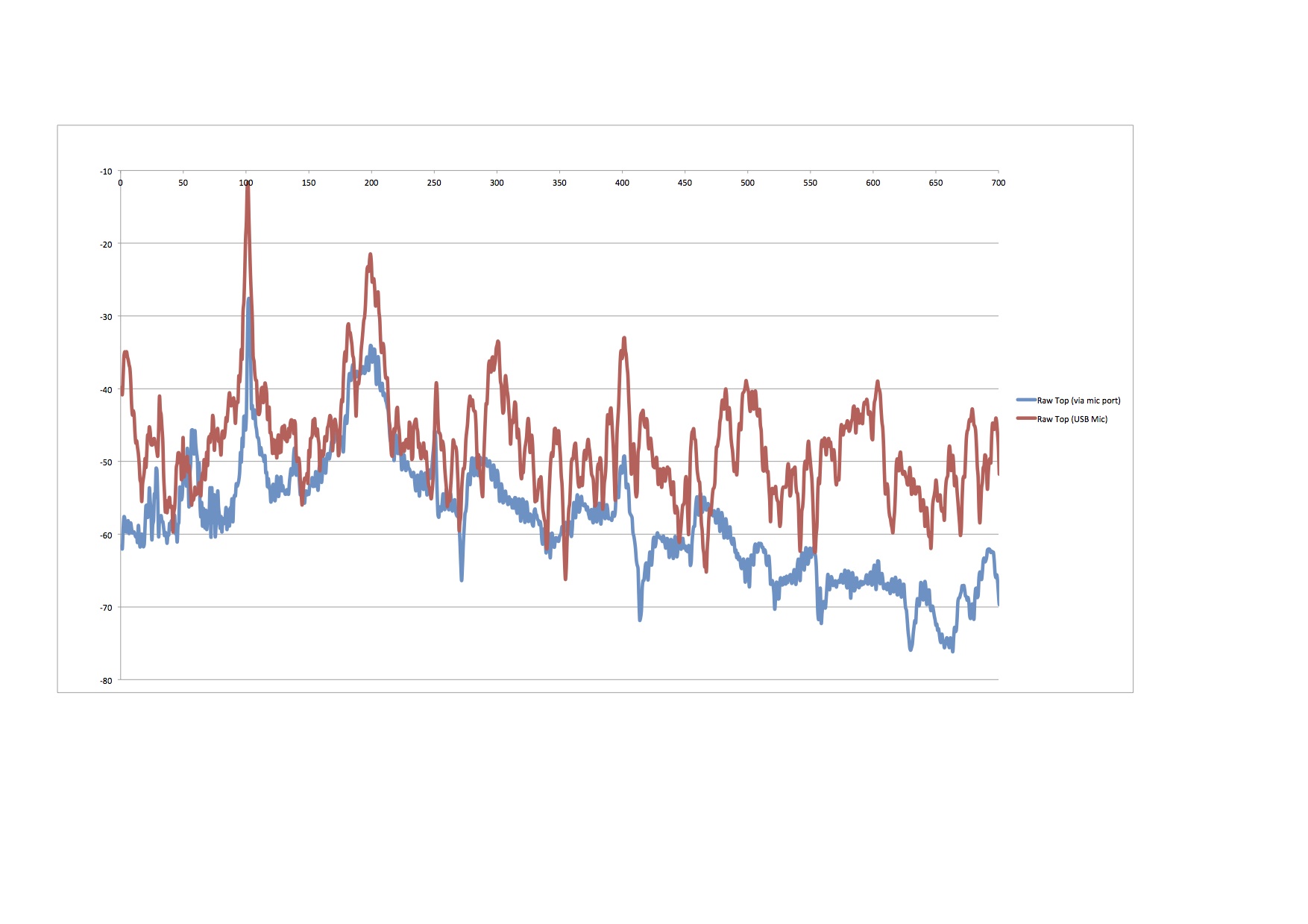

Tap testing didn't go as planned. Ive recently switched from testing using VA running on a MacbookPro (Windows 7/Parrallels emulator) to running VA native on an HP laptop. All Im getting is regular peaks on the spectrum at 50Hz intervals.....I suspect laptop fan noise. testing will have to wait until I get a cable to run from my mic preamp to my new MacAir. The MacAir doesnt have a dedicated mic input...you need to either go into headphone socket with a 3 ring mini plug or go in via USB.
I did some rough Chaldni testing and noted strong monopoles at 101Hz (Helmholtz) and 195Hz (T(1,1)2 - main top monopole). There was also a strong cross dipole at 250Hz. The back is giving a strong response (didn't use poppy seed for this one) at 247Hz.

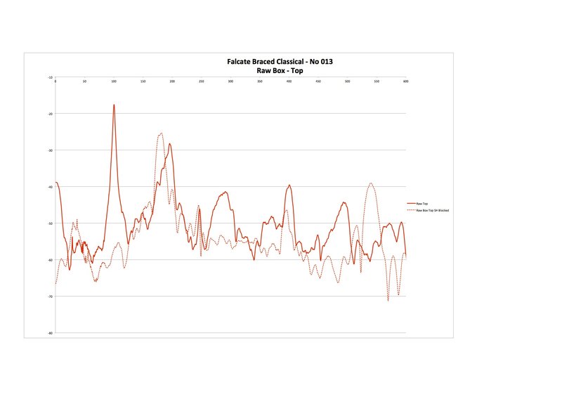

Post by kiwigeo » Fri Feb 21, 2014 4:46 pm
After a bit of juggling around with my tap testing set up I did another run on the top. Helmholtz peak is at 101Hz and main top peak seems to be at 198Hz. Ive presented data recorded with a Shure SM57 mic going via a preamp into the mic input on the HP laptop and also with same mic into USB port via a Shure XLR-USB converter.

Post by Tod Gilding » Fri Feb 21, 2014 7:04 pm
Lookin Good Marty, I have been using a shure SM 58 straight into XLR to USB ( No Preamp) with good results.

Back peak is 275Hz - I dont think Ill be able to bring that down so it effectively couple with the top. I had a similar issue with the last classical I built.
Trevor Gore
Posts: 1643
Re: Classical No 13
Post by Trevor Gore » Sat Feb 22, 2014 3:32 pm
Martin, I think that split peak at 175/200 Hz -ish is worth looking at more closely. Use Chladnis to figure out the modes and maybe do a tap on the back (sound hole open, mic on the back) to see what the back taps at. Then try both top and back again with the sound hole plugged. You might find another back mode in there somewhere... If you can't find two clear resonant modes, one at ~175 and the other ~200 Hz, you might need to do some work on your tap technique to figure out why a spurious peak is being generated.

Post by kiwigeo » Tue Feb 25, 2014 6:32 pm

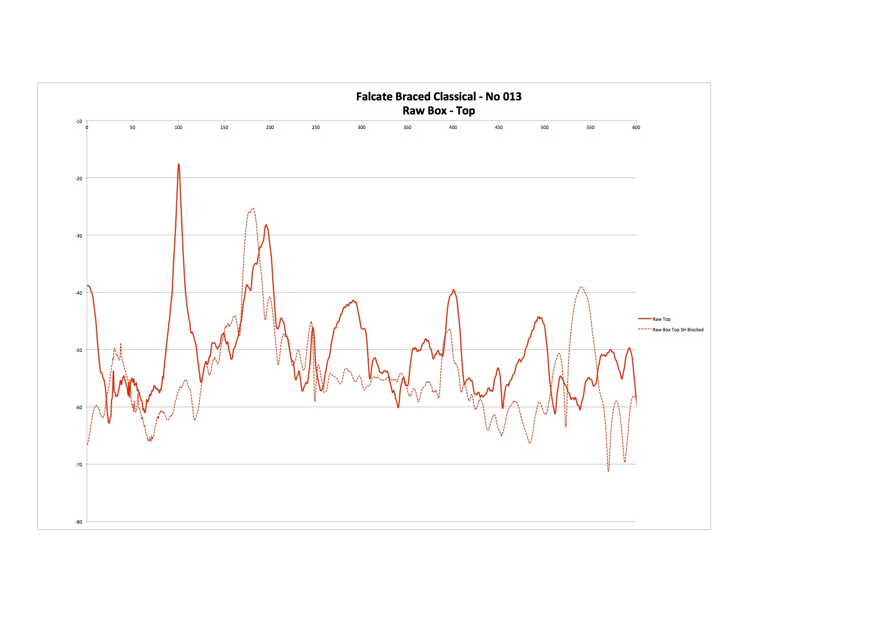

I played around with my tap testing technique and managed to get a slightly cleaner spectrum for top and back. I did some quick Chladni testing and found following. Note I've averaged 5 tap tests for each plot:
Top with soundhole open (solid red line):
1. Strong monopole at 198Hz - looks like this is T(1,1)2
2. Unable to get clear Chladni patterns for peaks at 245, 294, 400 and 498Hz. Peak at 400Hz is most likely long dipole and at 498Hz is Cross tripole?
Top with soundhole blocked (dashed red line):
1. T(1,1)2 peak appears to move from 198 to 181Hz. Gives strong monopole Chladni pattern.
2. peak appears at 542Hz. Couldnt get a Chladni pattern off this peak.

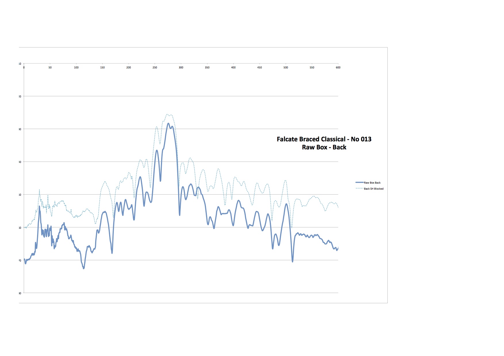

Back
1. Unable to get Chladni patterns off peaks at 220 and 252Hz.
2. Strong monopole from peak at 273Hz. I still think this is main back resonance.
3. with soundhole blocked (dashed blue plot) amplitude of spectrum seems to increase.
