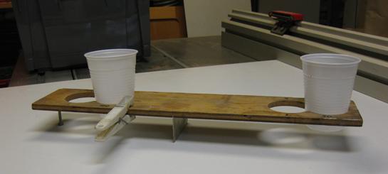

I frequently mix epoxy in small portions using disposable paper or plastic coffee cups and my wife's kitchen digital scale (in a sandwichbag to keep it clean). Recently bought my own scale ( 500 gr. capacity, 0,1 gr. accuracy ) for little over U.S.$ 5,- and free shipping on e-bay. For larger portions I'm using a simple balance which proved to be accurate enough. It can be used for various ratios depending on the type of epoxy. Each ratio requires some added weight for which a clothes peg is used. It’s position varies with the chosen ratio and can be found by calibrating with known weights.

Agree, it's only for the larger quantities that I use the balance and seperate cups.
