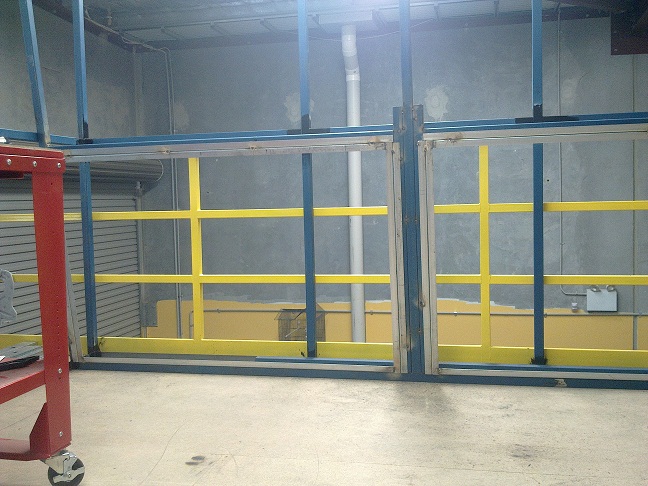

Doesnt look like much, but boy.....
We have the frame work on a removable panel, that can be positioned or angled for optimum draw within the booth, within that panel we have on the lower section two frames that fold out, 1.5 metres by 1 metre each, these still need to be meshed but they will house the filter elements, in the current position they have a lip all the way around so they butt up against the steel box behind. This is so you can have a positive seal when the filters are installed with nil chance of sprayed particles being drawn out of the booth without going through a filter first
Paint Booth shot 9.jpg (146.65 KiB) Viewed 2943 times

Post by Kim » Mon Jul 04, 2011 8:10 am
Good to see the progress Steve, lots of work but the end result will be superb. Any chance you could scale it down a bit and drop down with the tig to put one in my shed when ur done...there's a 6 pack in it for ya and I'll get the Missus to throw a pie in the oven for lunch. :lol:
