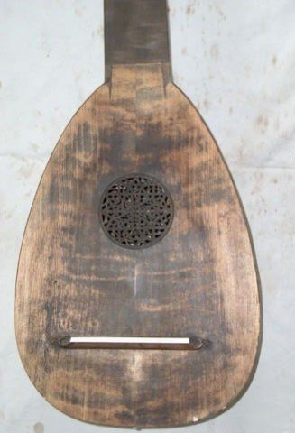

Egg white? well yes I do use it on all of my tops particularly, The chemists at my university have analysed a lot of finishes on instruments over the years and a lot of the old Spanish, Italian and German instruments has an egg size. On many German lutes it was in fact the only treatment applied to the top. On this particular Brunner lute that I worked on it was the tops only finish.
As to the original question I do tuck the upper bout legs of the X but taper away the lower bout arms to nothing about 3mm from the linings. This is for a flexibility reason not fear of failing joint.
As some of you will know, one of the things I do is restoration work on historic instruments for several museums. Most if not all of these were put together with a collagen glue of some sort, and probably not of the purity we use now. It's very rare for a joint to come apart on these without there having been some sort of mechanical cause. The oldest instrument I've worked on dated back to the late 16th century and a good threequarters of the joints were as strong as the day they were made, probably stronger.

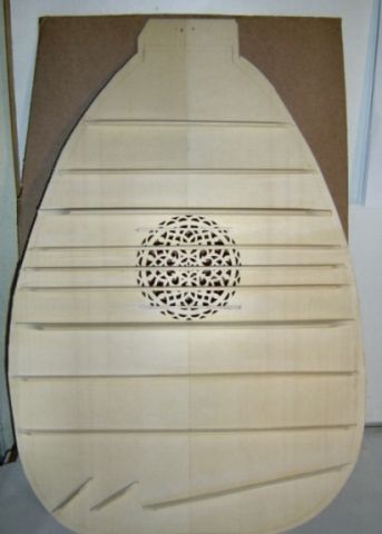

Don't forget that the rose will have small braces added on the inderside, good tip to stain the gluing surface of these prior to gluing to the underside so that they are not obvious from the top. If you look at the underside of this lute top you'll see a number of braces crossing the back of the rose. But they are not visible, runining tha pattern on the finished instrument.
