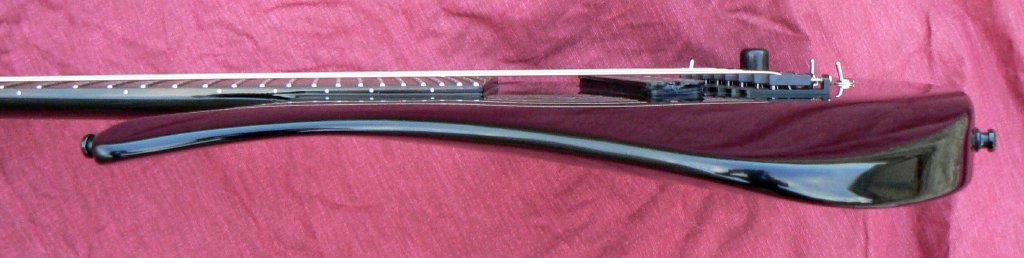

I don't think the tenon and neck is one piece. On all the pics you can see a sort of gasket or joint between them. Also the neck veneer - if it is that - is laid up impossibly neatly around such at 90degree joint. I think it's bolted on somehow. I think the tenon, and the mortise it slides in, are CF, the block being built up around a preformed CF socket.
Just speculatin', of course.

In the image immediately above with the gold block, I see what you mean about the gasket at the neck and neck block Mathew but that could just be the way that the gold leaf is laid up. Downloaded this Image, the first link from Allen's post and then magnify. This looks like it 'may' be one peice and is the image I was referring to when I mentioned the feathering in.
Of course there is no reason why this part of the construction could not have been tackled in a number of ways and perhaps what we are seeing is MK1 and Mk2?

What I take from some of the articles I've read where Ken discusses his design is that the neck / riser assembly is made from Douglas Fir then layered with CF and a show veneer. The riser might be separate to start with (and probably is) but the laminations of CF and veneer make for a very strong joint.
The CF running from the neck and down the riser would account for that slight fillet that can be seen in those photos.

Jeff, I agree with both you and Dom in that the tenon of the neck would be inherently the weak point; what I was suggesting is that it should be able to be accounted for with design. Can you explain (preferably via a rough diagram!) what you have in mind when you say this though... "I would imagine there would be some sort of bolt fixing through the neck under the fingerboard into the tenon at the headstock side and at the bridge side." I'm not sure my visualization of this is the same as what you mean. I would assume there is still a truss rod in these necks for a start?
Kim - likewise, I'm not following what you mean in... "...CF foot which the riser block is attached to or part off. Like a one piece unit which is bonded to the underside of the top extending toward the back for a little way but also extending forward to meet the side right at the front of the guitar where it turns 90 degree, the strap button is probably used to lock the whole thing in place stabilizing the block and top so that the adjustment can work from the back." Diagram? In that last picture you added, do you think this is the carbon itself showing or another decorative finish? If the carbon, does it provide any clue as to how it is constructed with those more familiar to carbon?
Matthew - I don't think it would be impossible to lay the veneer this perfectly - A square hole matching the tenon could be cut in the veneer and act as a locating point before it is glued to the neck, possibly with vacuum. Of course, having not tried this, it is purely speculation and it may still yet be two pieces as you suggest.

Allen - With respect to the Douglas Fir, if this is the case, do you think just a single carbon skin would make this neck joint strong enough? Particularly if the core of the tenon of the neck is a separately attached piece as you suggest? Two timber members joined in this fashion with just a carbon skin would still seem a bit risky to me? Perhaps I underestimate the strength carbon would give in this. Do you feel from your experience with carbon this would be adequate?
I've a good friend and colleague that has built in a similar fashion to that you mention Allen and I'm not aware of anyone else doing this. He has built at least two if not more, solid body guitars made wholly (that is, body and neck) of solid spruce with a carbon skin over the entire unit. He does not then skin in a timber veneer, preferring the Carbon look for these instruments. Pictures demonstrate it better, but they are very impressive - incredibly light, strong and resonant. The style allows him to build in access and contours that would be impractical otherwise.
