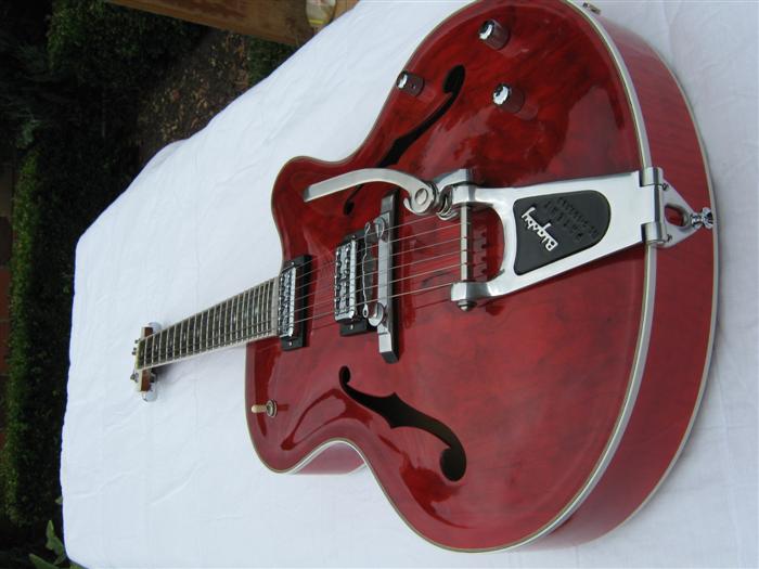

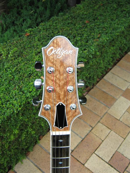

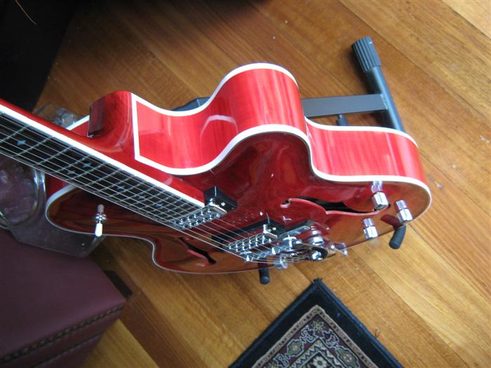

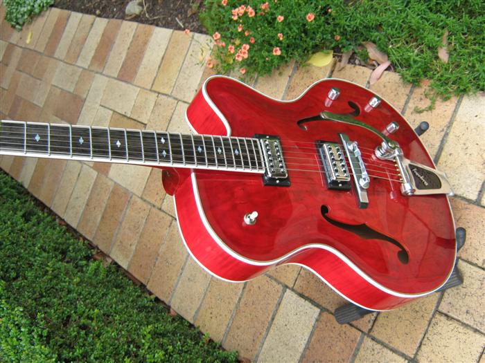

Just got this one finished, wasn't sure wheather to post here or in gallery, but this thread started here so here it is!!
Laminated curly maole b/s
carved U.S. cherry top
440mm lower bout
plastic binding &bwbw purfiling
25 scale
ebony f/b
cherry and purple heart neck
red ironbark headstock
TV Jones classic pickups
bigsby rocker bridge and trem tailpiece
2 vol 1 master tone& 3 way toggle

first proper elec, learnt a fair bit on this one.
Thanks for looking,, Cheers,,,, Rod

Top marks!

Without a pic I would have gone with intuition and said Cherry.

Very cool Rod. Colour and finish turned out great. How's it sound?
Just a spaniard in the works on the earthing saga which I have just read again is that on all my electrics I use active EMG pickups (B 81, N 89ish) and on those you never earth the bridge/strings.

That DEFINITELY belongs in the gallery - that is a beauty.
Well done Rod

Noice,noice very noice Rod. Loving the colour! How do the TV Jones sound & which tuners did you go with?

Well done Rod. I like it a lot.

I've got a couple of shirts to go with that guitar. Just loving that one Rod. Makes a statement in so many ways, not the least its a bloody great looking package.

Thanks for the compliments there you lot, as i said this is my first electric build, and being a hollow body info and specs were as scarce as hens teeth but it seems i've done ok with this one, didn't blow myself up when i plugged it in!!! It's got flat wound 11-49s on it plenty of sustain but not as much pop as i expected with the t.v. jones humbuckers, round wounds might give it a bit more. This little baby is having it's debut on Sunday at a rockabilly gig so i may have some footage to upload some time soon.
