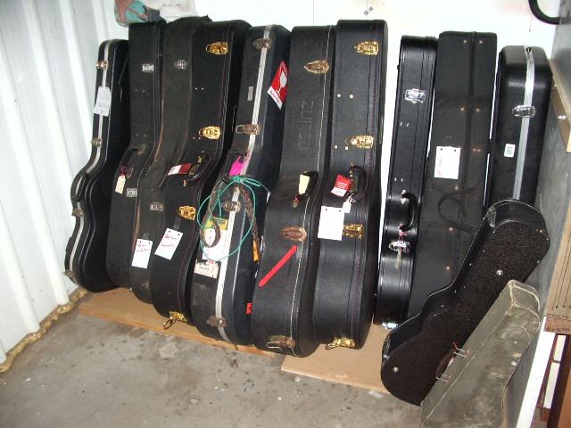

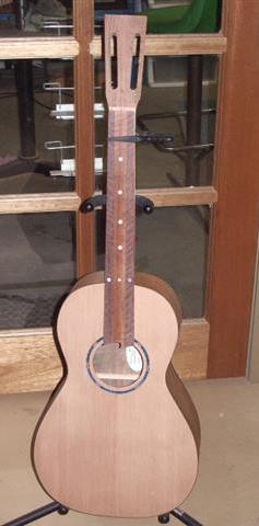

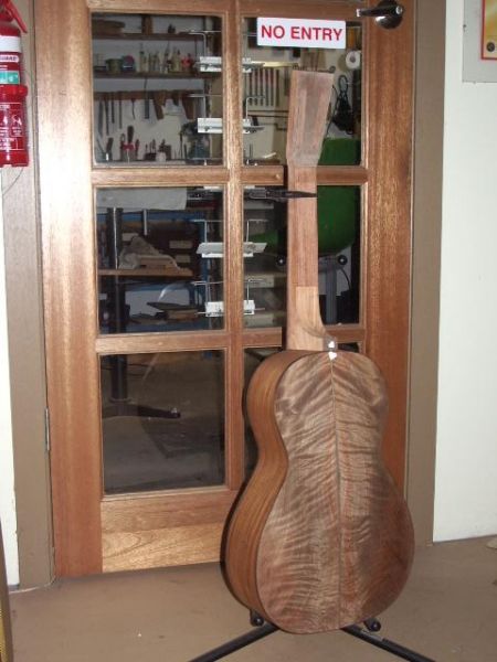

I've got 5 guitars on the bench, or rather one on top and 4 underneath, an I try to move from one to the other over time.
Most recently my time has be spent on this parlor guitar whilst waiting for parts for a solid body commission.
The parts have arrived so it's back to the electric guitar, and the parlor goes into its storage container for a few weeks.
But I've also got to get these repairs out of the way too this week.
All part of the fun.

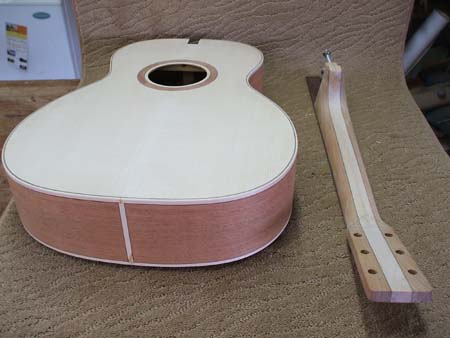

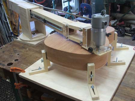

New binding jig and a OOO that has been lurking around all year is almost done.

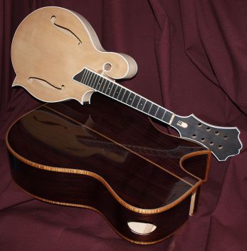

The OM has had a first coat of epoxy pore fill. In the interests of my health, I tried egg white, but even mixing in some silica thickener it wasn't very successful. I'm sure the slurry method would have worked, but I was worried about contamination of the koa bindings with rosewood sanding dust.
The F5 is based on a design made popular by John Monteleone some years ago. It has a King Billy top which may or may not stand up to the string tension. I used unfigured rock maple which, given its bland appearance and the significant investment of time required by mandolin construction, was a bad decision - as was the choice of top wood for that matter. In hindsight, I should have saved for something more suitable, but when I began this project around eight years ago (!), money was short!

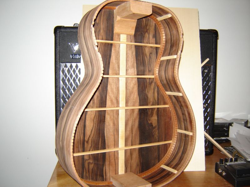

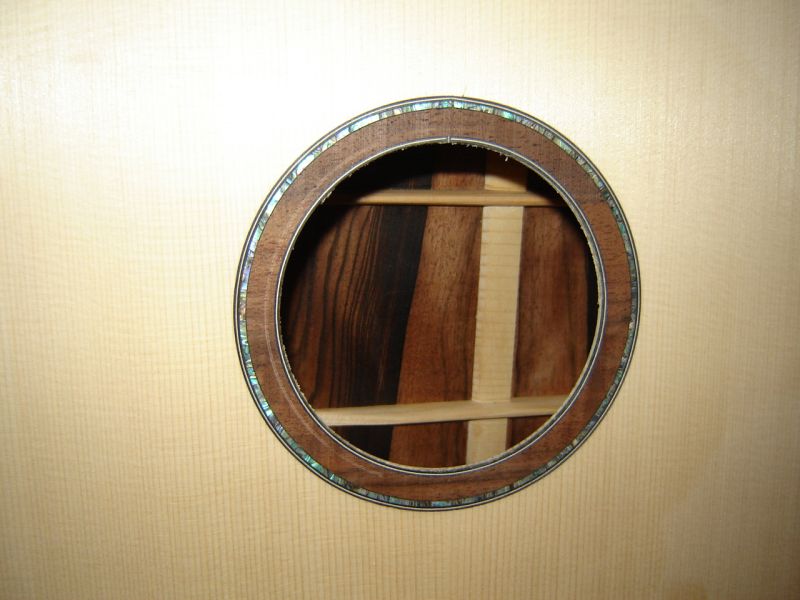

First my Mac ebony L-00 with back on.
I had the top on this one already but somehow it twisted during glue up and the body was not quite square. I couldn't do this to this lovely piece of wood so I removed the top and have started making a new one. Here is the rosette with bound soundhole.

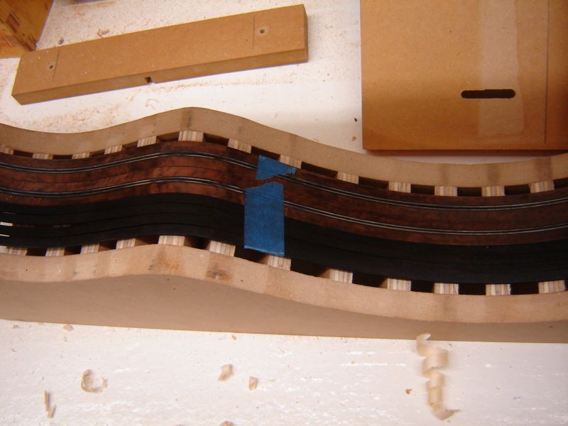

Next is a zebra wood L-00 for me-Julie. I have bent some tiger myrtle binding to go with it to keep with the safari theme. They were actually the best visual fit by far from the range I had. The ebony bindings in the pic are for my Mac ebony L-00.

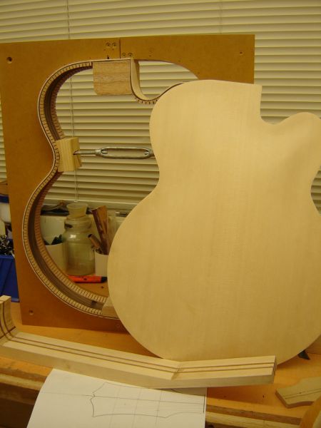

Also, my archtop has its body ready for assembly. The neck is also started. The top needs F holes (I haven’t decided what I want yet) and the back needs a final sand and clean up then I can glue it together.

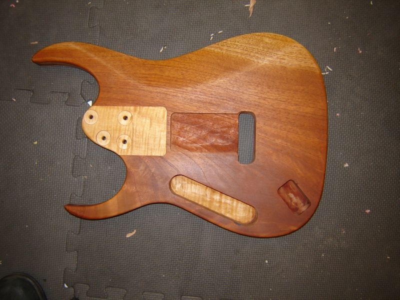

I’ve also got a couple of RG electrics with maple drop tops and Aust red cedar bodies. They are routed for Floyd Rose trems and I am going to put the new EMG-X series active pickups in them(81-x/60-x). The red cedar is really resonant and light but I thought I should reinforce the neck bolts so I routed in a bit of the top off-cut. We’ll see how they turn out.

The Macassar Ebony looks stunning, I remember you posting pics of the two backs a while ago.

The archtop is all class and I really like the way the grain on the cedar folds over the carving on the eleckertrickal.
