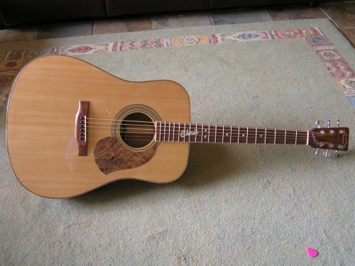

Allen wrote:[I've not installed a pick guard on a guitar, mostly 'cause I haven't been able to find one I like. I do have some pick guard sheet material, so I'd be up for a bit of a tutorial on how you go about making a custom one.
I have always liked the Maton shape.
In this case I used some figured blackwood-finished with Organoil.
I have always liked this pickguard.
Frank

That pick guard is a stunner Frank. What did you use to tack it down to the top with?

I just use the ultra thin double sided adhesive sheet, available from LMI etc. It took me a couple of goes to get the sheet to grip to the guard as the bottom was too oily. So I removed the guard, gave it a month to really dry, and then sanded to P600. That took care of it.
