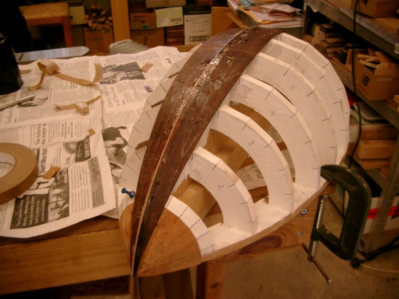

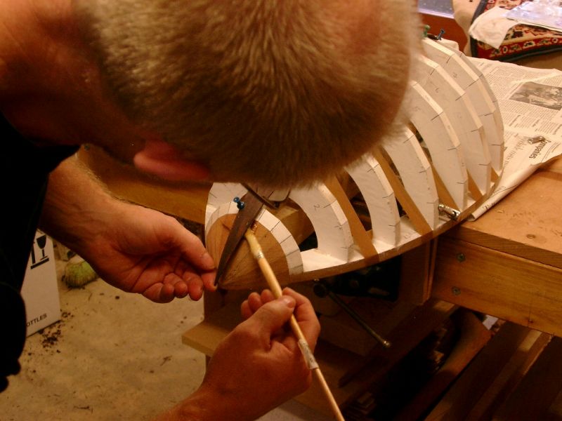

On to more serious matters. Two ribs have been glued up on the lute. Pics are of first rib being glued up.....no pics of second rib as camera battery is on its last legs and isnt holding a harge for more than 15 minutes.
I decided to use some commercial wbw purfling in between the IRW ribs....getting the purfling bent to shape around the arse of the lute is a pain as the purfling has to be bent at right angles to the orientation youd normally have it for a guitar. Had to try a few different purflings before I found the one that did the job. The glue job went ok but sometimes its handy having 8 arms for such jobs.

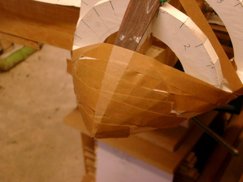

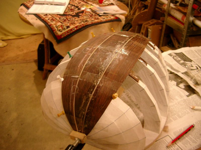

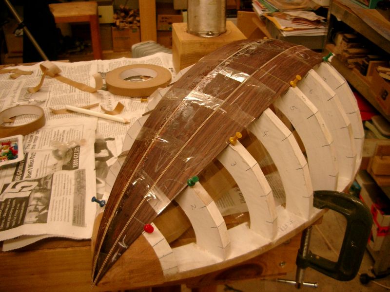

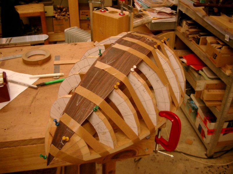

Pics of the first two ribs glued in and the third rib taped in to check fit. Running out of the purfling so therell be a break while I wait on a new load of the stuff to arrive.

That's looking good and the staves are meeting the mould where they should - great stuff. The purfling can be tricky to bend over the "back end" area but I found bending dry and slowly on a hot pipe keeping the purfling moving all the time worked pretty well.

Niiicce 8) 8) Good Job Martin and I'm with everybody else especially Craig, those purflings really add something more to the whole classy job so far. What sort of glue are you using, is that the Hot Hide glue or the fish glue?

Im using hot hide glue. Its ubeaut brand stuff and Im not sure of strength of the stuff. Its setting very fast despite warming up wood with a heat gun before glue up so strength might be a bit on the high side. regardless the stuff sticks like shit to a blanket....went to pick up a map pin and ended up with 6 of the suckers stuck to my fingers!! :?

Yes I quickly discovered the trick to bending the purfling over the arse end of the mold. The purfling is 2mm high which is about right for bending....anything less tends to twist when you bend it.
