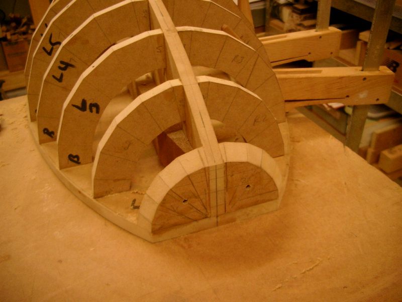

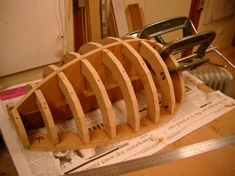

Okay I managed to get the mould fabricated today.....didnt follow the tutorial word for word and there are ways one could make the process a bit easier.
Tomorrow I start shaping the tops of the ribs.

That's looking good - certainly more sturdy than my "dunny seat". I don't know how you are going to use the form to support the ribs while glueing, but one thing I learned is that when you are at a point on the sides where the curve is changing, the facets are angled and not at ninety degrees to the side to side supports (a bit like an angled peghead). The obvious place is at the back of the lute (tail end) where your three pieces go down in steps compared with the central front to back spline of your mould which is the rib shape. As they appear in your first picture the ribs will be held too high at the tail - I don't know if you carved/sanded their profile later. The same is true of the neck block support. Also remember to cover the form with something to stop the ribs being glued to it rather than to each other.
Dave White
Posts: 10874
Post by kiwigeo » Wed May 27, 2009 8:33 am
Hi Dave,
Thanks for the comments and suggestions. The mold isnt finished yet...theres quite an involved process of shaping the top of the ribs using a steel ruler and cardboard strip.....ending up with a smooth profile for each rib. Before gluing up ribs the top surface of the ribs are waxed. I note your use of brown binding tape on your mold.

Just had to replace rib L3....wasnt quite matching the line on the base. All fixed and I think its ready to go.
One thing thats not explained clearly in the tute notes is that the ribs only make contact with the mould ribs at the points of intersection between adjacent flat spots on same.

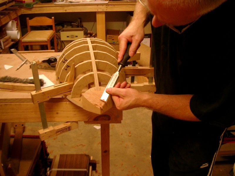

Post by kiwigeo » Sat May 30, 2009 10:49 pm

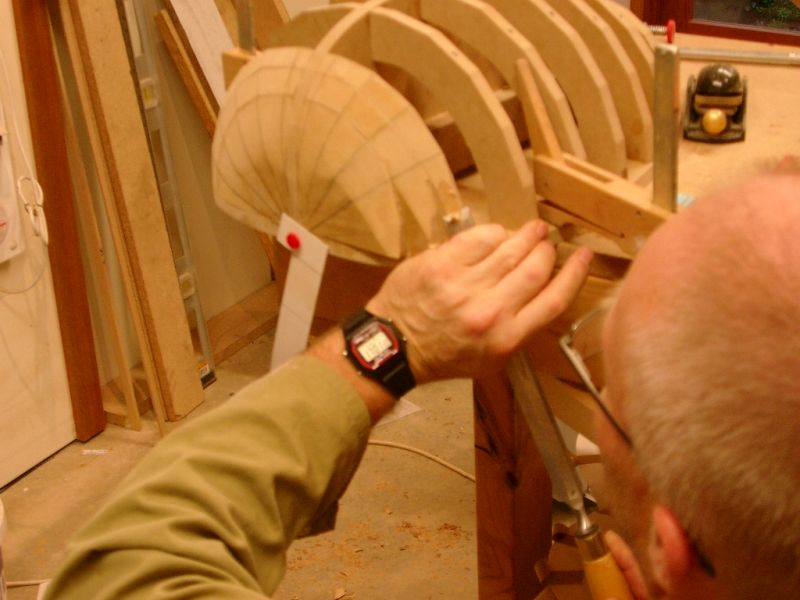

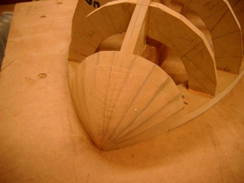

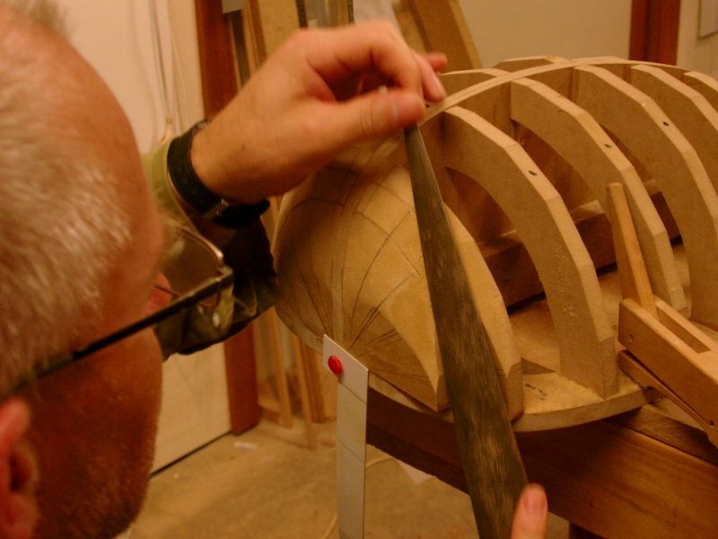

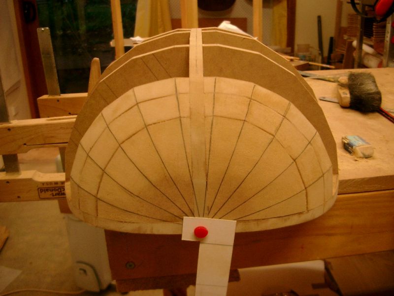

Worked on the neck block yesterday. There are a few choices as far as wood goes, I went for Honduras Mahogany as Ive got a bit of it lying around the shop and its a favourite wood. The block gets secured to the head end of the armadillo and gets carved to shape with chisels and rasps. The important thing is to acurately carry on the facets from the ribs through to the neckblock. It looks easy but it ain't.
Working with the 25mm Stubai.....my favourite bench chisel.
Working with the dragon rasp...one of the most used tools in my workshop.
The end result.
