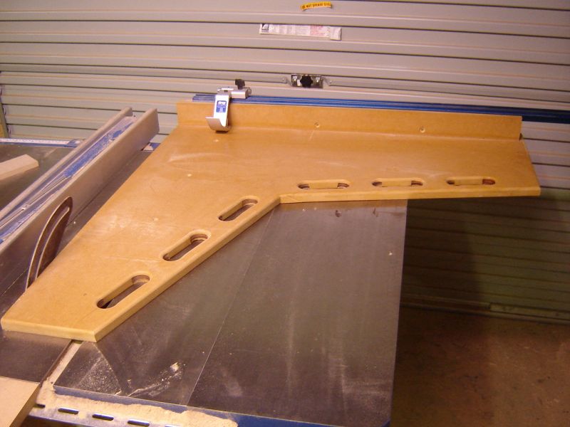

I made this cross cut sled from a fine woodworking mag plan but scaled down. Makes cutting large sheets safe and very accurate.

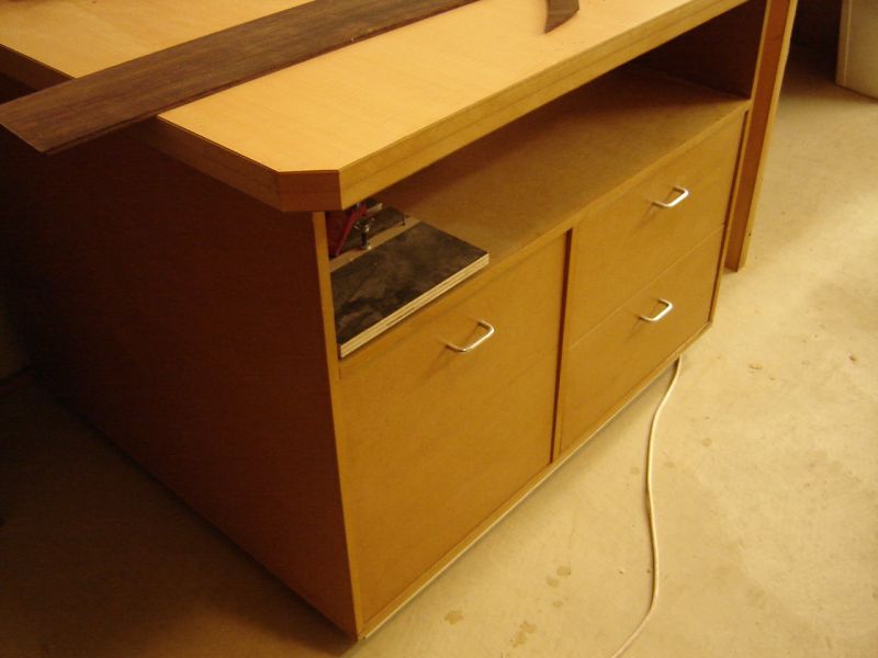

First an out-feed table for my table saw with spots for jigs etc and drawers below that for other saw related stuff. The top is 2 pieces of 18mm MDF with some Formica top using off-cuts I got at the salvage yard. I need to cut a couple of slots to extent the mitre tracks. All of these pieces have adjustable feet so I can account for uneven floor. And all the same height as the saw so they can be used as in/out-feed tables.

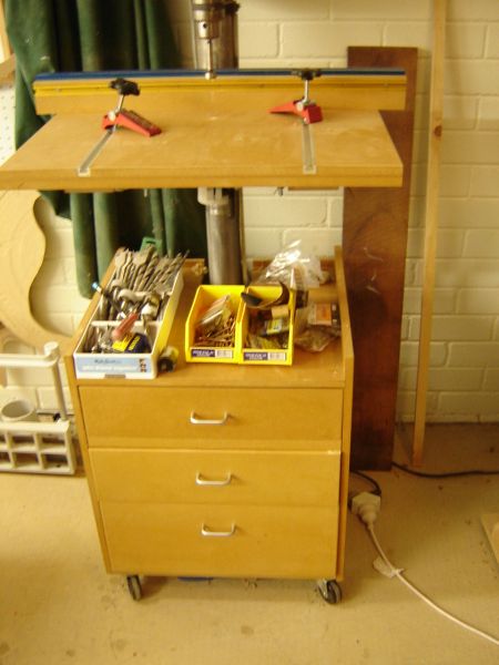

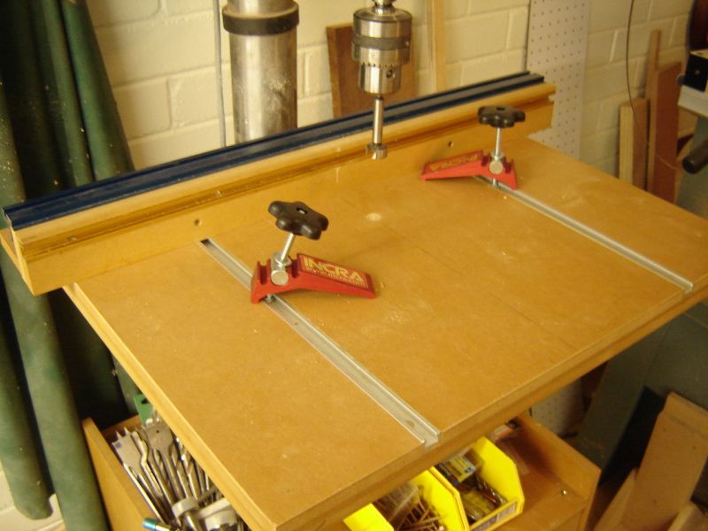

I also made a new top for my drill press with T-track for the fence, hold-downs and also in the fence for stop blocks etc.
Below that is a small rolling cabinet that fits under the table to hold all my drill bits, buffing pads and other drill stuff right where I need them but mobile if I need extra room for long pieces.

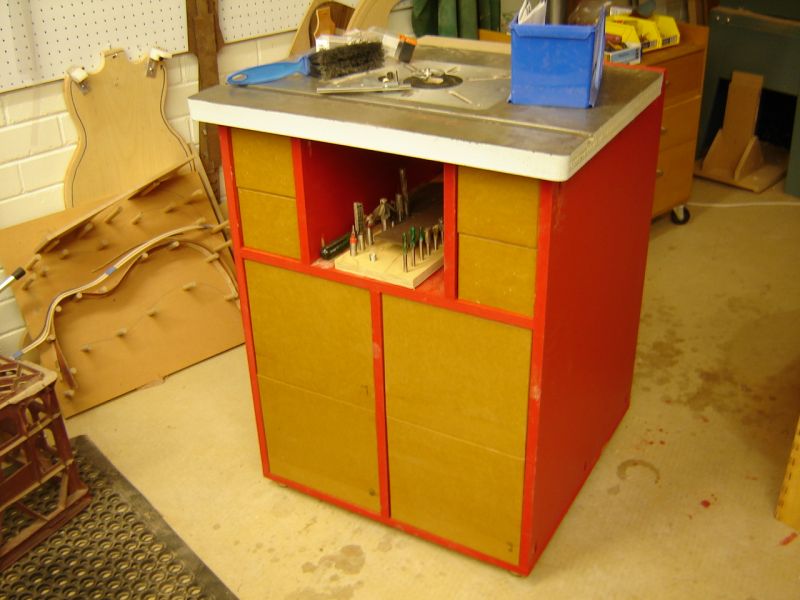

And last, my new router table cabinet. Not quite finished yet. It will have a door to enclose the router at the front with dust extraction at the back and on the fence which is not in the pic. oH, Oh, and handles on the drawers.
I have been very conscious of controlling dust in my new space so all these bits have been designed with that in mind. Either to keep dust out, or to make it easier to collect.

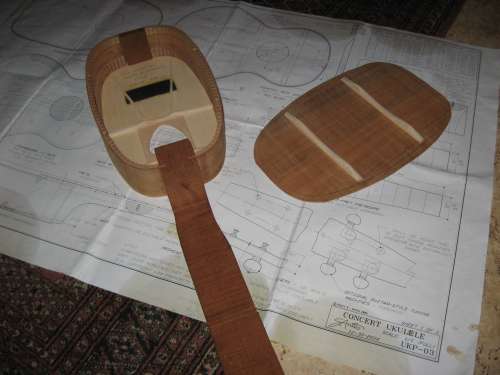

Got a couple of ukes on the go using plans from LMI ...
Tenor
Tiger Myrtle back, sides & headstock with King Billly top from TimS; neck of recycled mahogany from an old telephone switchboard cabinet:
Image Image

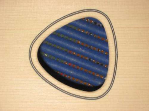

Concert Pineapple
High figured Tassie BW on sides and one-piece back; top of Swiss Spruce off-cuts, and neck from the same board of mahogany. Soundholes are experimental based on the Reuleaux Triangle.

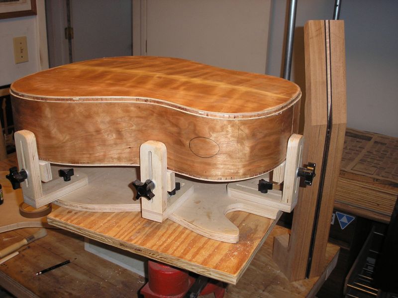

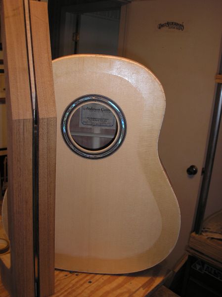

I haven't got much accomplished lately on my Concert Jumbo I'm working on....It's Lutz and Cherry from Bob - the famous Zootman.
This is my 1st 5 piece neck.I have always used solid mahogany up til now.

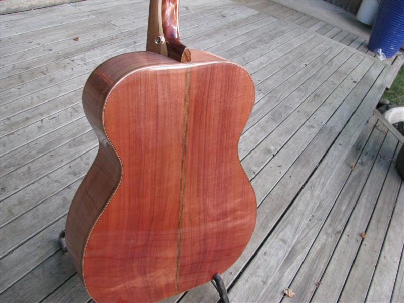

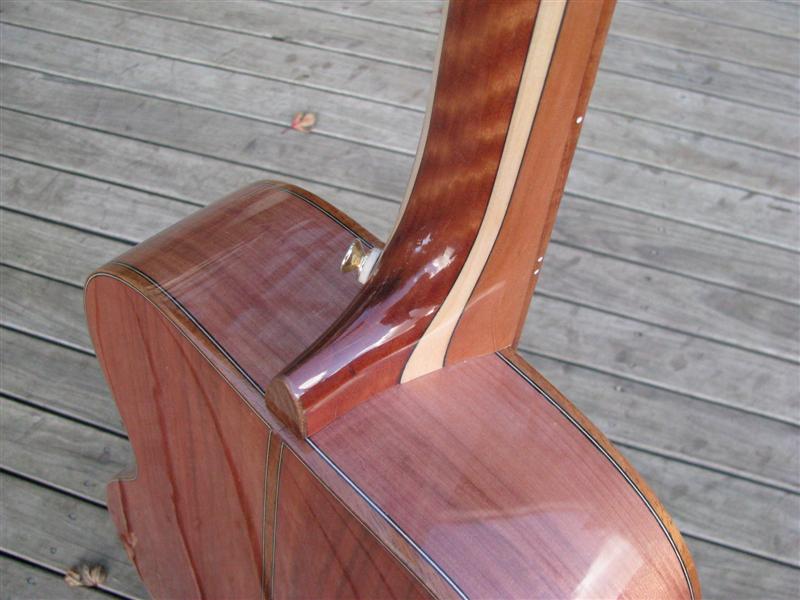

This is the guitar that had the staining under the shellac finish. We re-finished it with pre-catalysed laquer. It's Tassie Myrtle and Engelmann.
It'll be re-united with it's owner in Tasmania next weekend. Dave and I (as well as Mark, the owner of our shed) are off to Tassie on a lumberjacking trip next week. (thirsty work that lumberjackin' stuff)

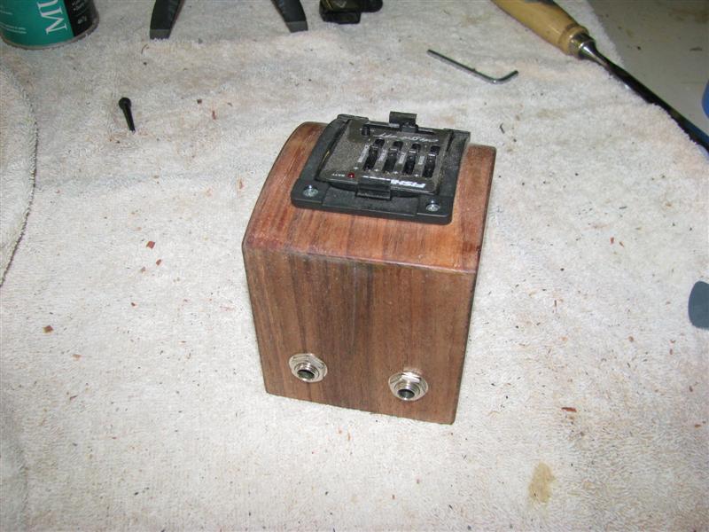

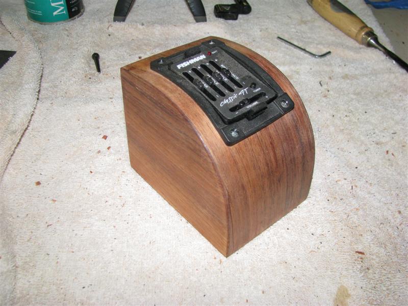

A pre-amp box. Much better to do this than to be hacking holes in guitar sides.

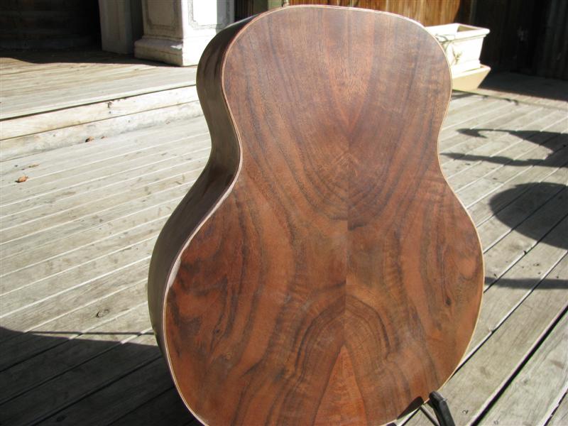

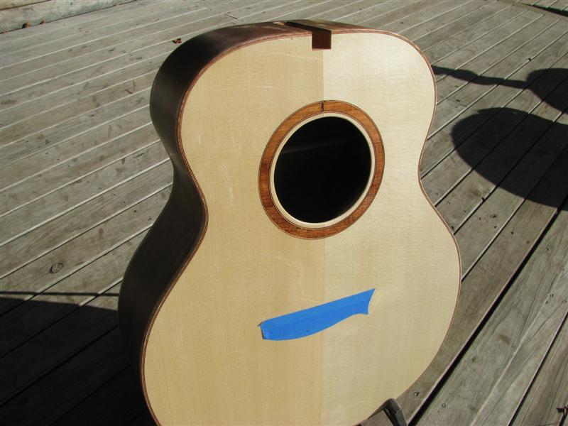

Walanut and Euro Spruce. This used to have a cedar top but I made it too thin so I decided to replace it with a nic e piece of Euro Spruce that Martin Turner gave me a while back.

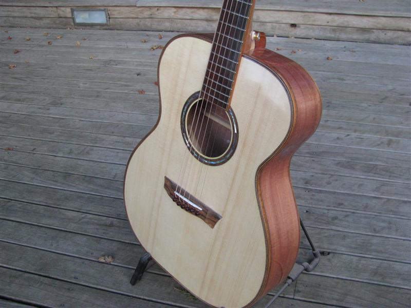

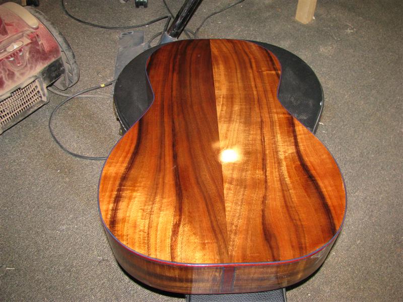

Cedar and Koa 12 fret O model.

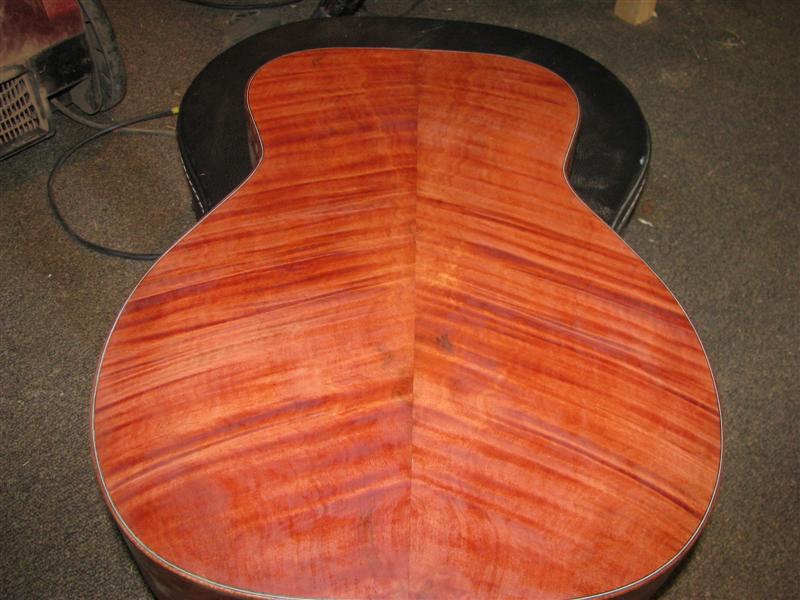

Curly Myrtle Carpatian Spruce.

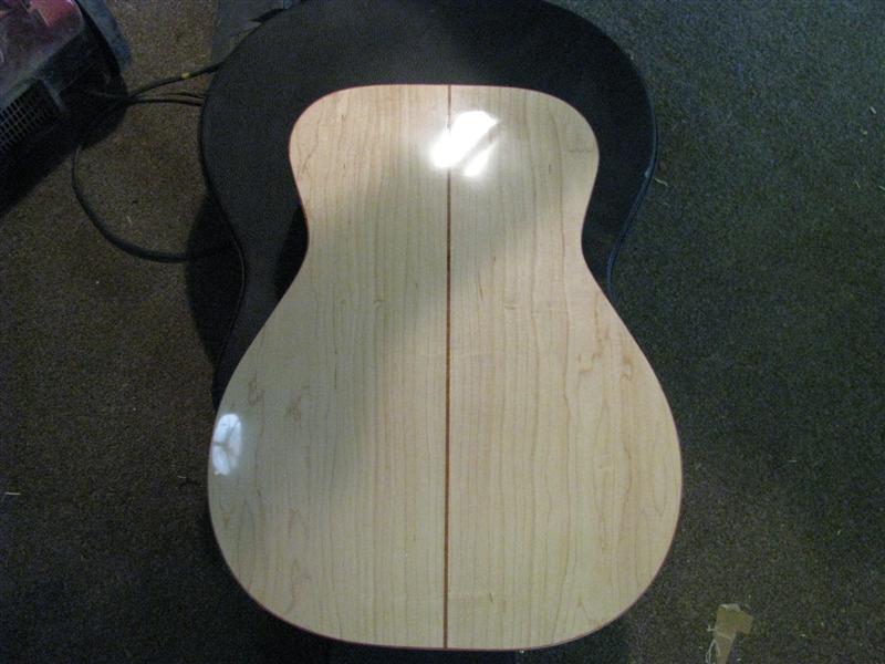

Maple/Sitka O model with Jarrah everything else. One of the sides on this was a bit scorched so one of the kids is going to be the happy recipient of this one.

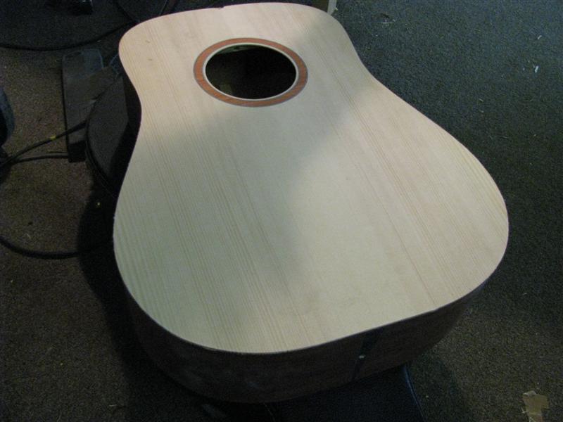

This is a Padauk Dready of Daves that originally had a very thin (2mm) Sitka top on it. (one of the first one's we built) The top started to buckle so it's now got an Adi top that's around 2.9mm thick

That Myrtle guitar looks so much better under the Mirotone than the shellac Bob. It's a real stand out now. The owner is going to be over the moon with the fix up.

Gosh that Myrtle is pretty, I just got hold of some meself.....

Sorry Bob, couldn't help myself. Love both the curly Myrtle and the Koa jobbies, beee ute eyefull!

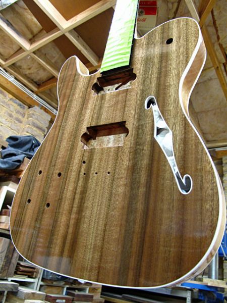

This is me to date.
The Quilt maple/makore neck through carvetop is getting delivered next week and the neck through Qld walnut hollowed tele is half way through the refinishing and will be delivered in 6 weeks time.

Hey Stu those electric's are bloody beautiful.
Is the Tele your design and would you mind explaing to me the chamber pattern inside?
