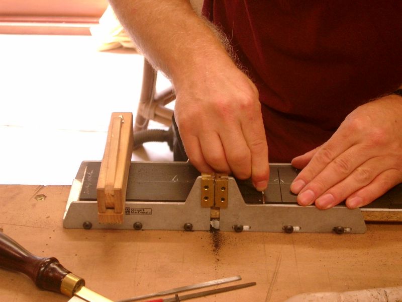

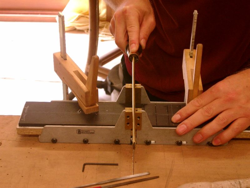

Probably old hat to most of you but some of the newbies might find attached pics of interest.
Standard Stewmac fret slot cutting jig. I stick fretboard to melamine covered MDF using double sided tape. The MDF runner is registered hard against registration pin side of the jig (bevel in runner is to clear the pin). The piece of fret wire with tang studs filed off is to check depth of slots.
Cutting slot with fret saw (Stewmac job). I run saw through candle to make it cut easier.

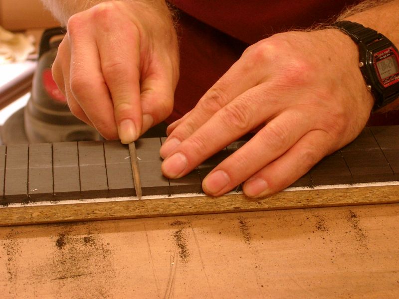

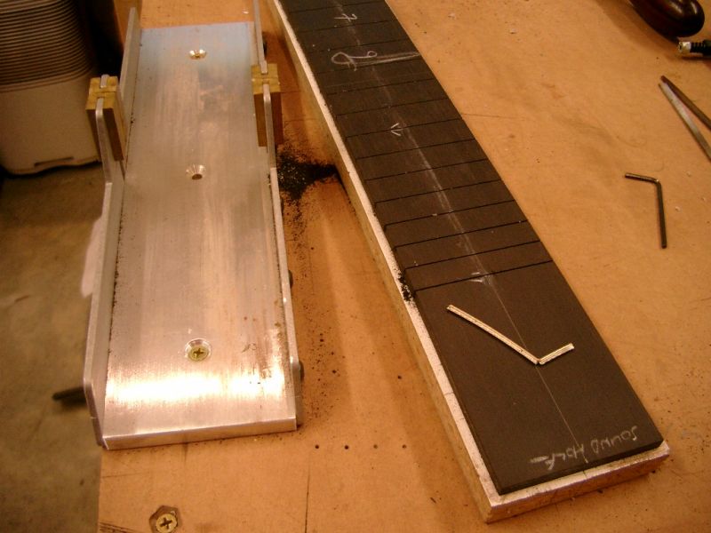

Checking slot depth. I check alll slots again after board comes out of the jig and deepen if necessary.
Bevelling slots with triangular file. Less chance of tear out during a fret pull if slots are bevelled.

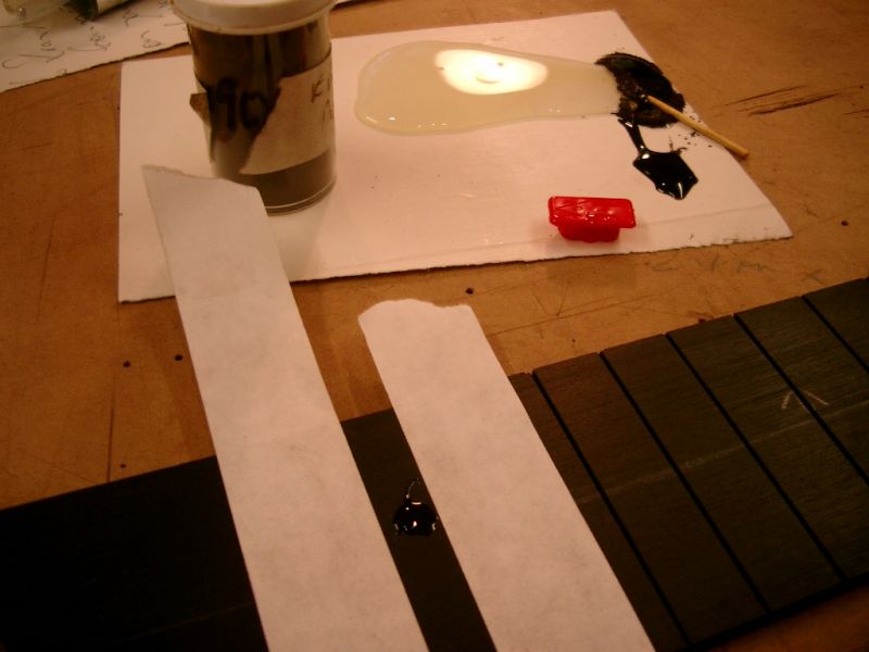

Repairing tear out on fretboard surface using 5 minute epoxy mixed with ebony dust. Tear out occured during planing of.....plane was running opposite to grain direction.

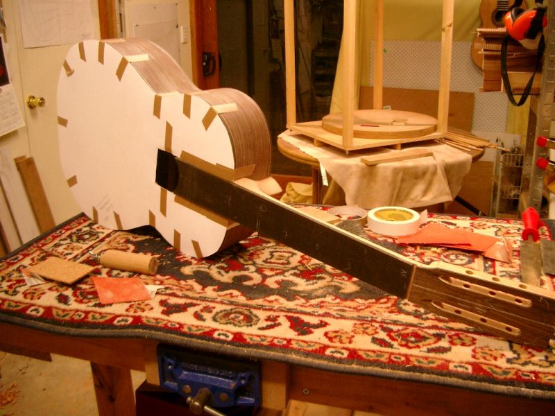

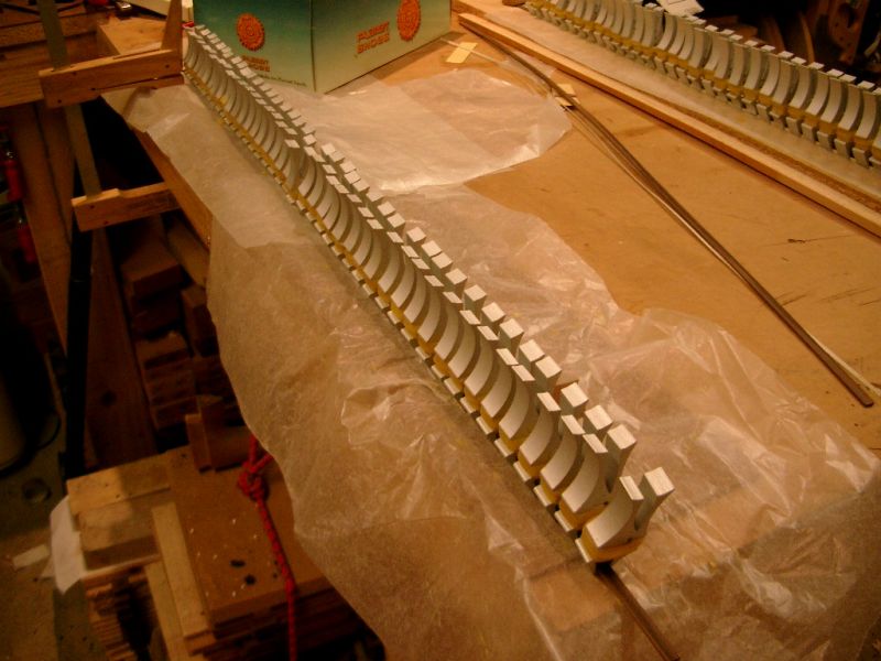

Nasty fiddly purflings......gluing up of same to IRW bindings made alot easier with John Halls lining clamps. And wax paper..useless for cooking but perfect for gluing up bindings and purlfings.

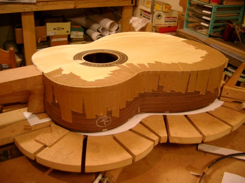

Last few days went on bldi bindings....using LMI binding tape rather than my usual method of roping up with bias binding tape. Jury is still out on my preferred method. The LMI tape is good around the butt and neck area where there are joins but around waist where risk of binding not securing hard into the channel the bias tape method is better.

Post by sebastiaan56 » Sat Mar 21, 2009 5:01 pm
Looking good Martin,
Where is the rosette from?
Post by kiwigeo » Sat Mar 21, 2009 5:55 pm
The rosette is an off the shelf job from Stewmac...havent got industrious enough to make up my own.

I use the brown binding tape, but still always use the wrapping method after everything is taped in place, just to cinch those bindings tight and into place. I found the tape on its own had a tendency to relax just enough to give me some gaps in places.
Progress is looking great Martin.
Post by kiwigeo » Sat Mar 21, 2009 9:10 pm
Brilliant idea Allen....bldi perfect idea!!
Post by Allen » Sat Mar 21, 2009 9:23 pm
I also get away with 1/2 the amount of tape that you've used there. I find that it also helps to have a few gaps in the tape spacing, so I can see the bindings pull tight when I put the wraps on it.
Post by kiwigeo » Sat Mar 21, 2009 10:12 pm
Allen I usually put the tape on with one tape width gap between each piece. Once Im happy the bindings and purfs have pulled in tight I fill in the gaps.

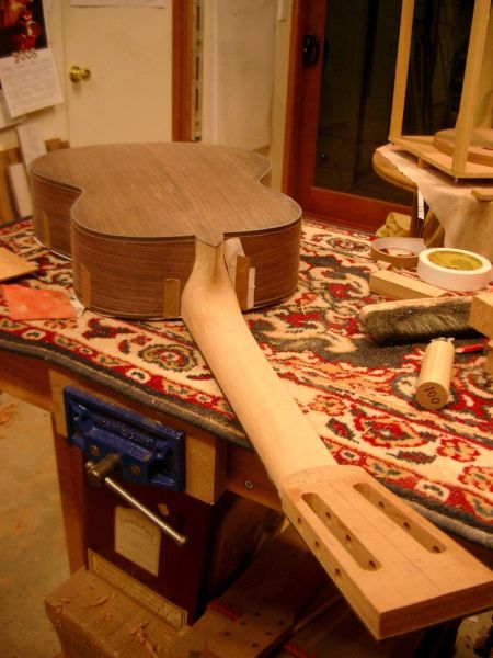

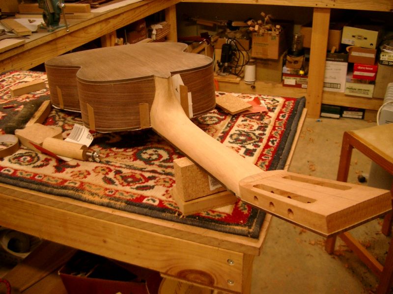

Went for a gut busting bike ride today on the new bike. The ride got me invigerated so when I got back I got busy working the neck on the current build. The fretboard got glued up yesterday.
Post by Kim » Mon Mar 23, 2009 10:33 pm
Looks great Martin, nice and clean and crisp, ewe have made great progress on this one M8

Steven & Kim are right though, it's all looking rather good there Martin. With the lighting it's hard (for me :roll:) to tell but is that Mahogany you are using on the neck?
Post by kiwigeo » Tue Mar 24, 2009 8:48 am
Nick, the neck is spanish cedar. Top is Englemann from Graham Hein and back and sides are op grade IRW from Allied. Bridge is ebony.
