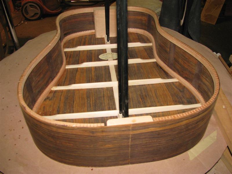

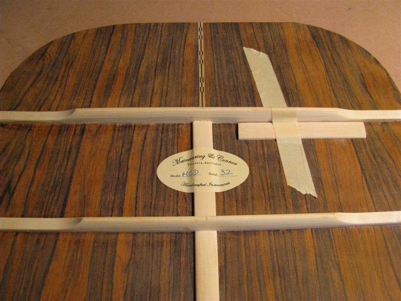

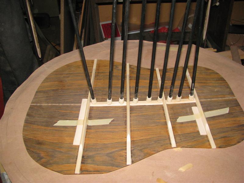

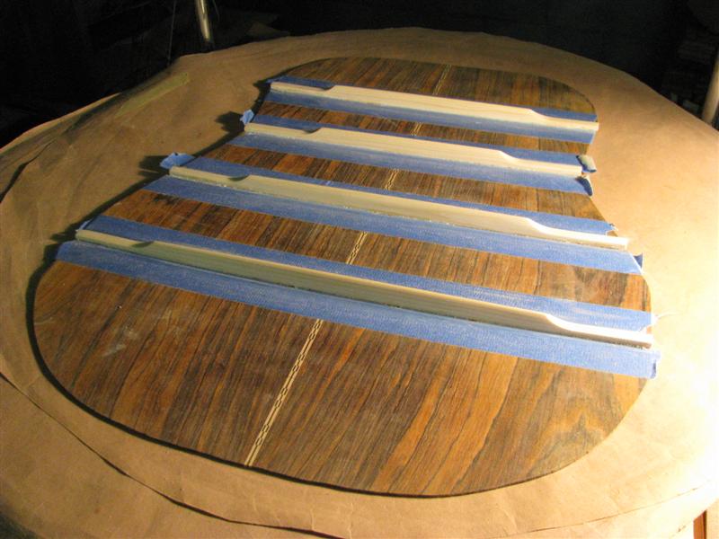

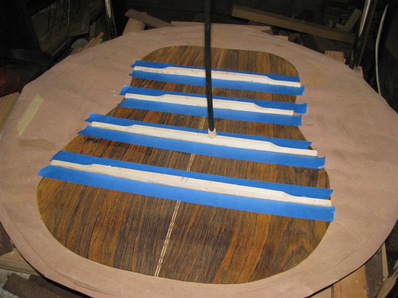

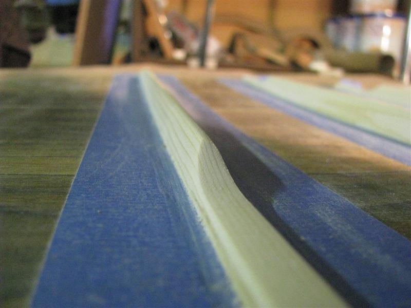

Time to carve the back braces.

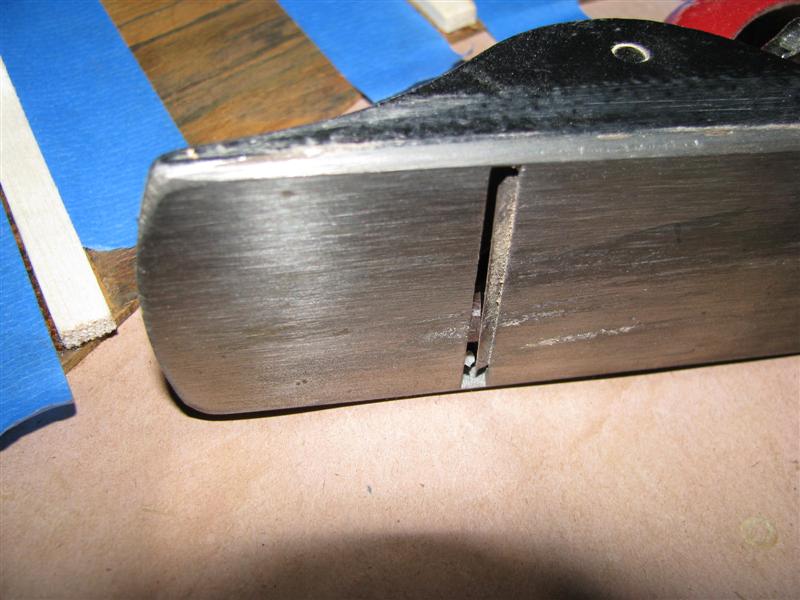

I use a cheap Stanley block plane that I took to with the belt sander and rounded all the edges off.
Tape up either side of the braces so we don't get any scratching on the back.
About ten minutes later the braces are rough carved.
I finish them off with a chisel and then sandpaper.
Next the centre re-inforcement strip goes in along with the label.

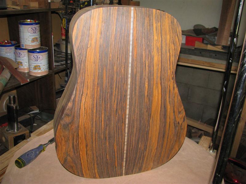

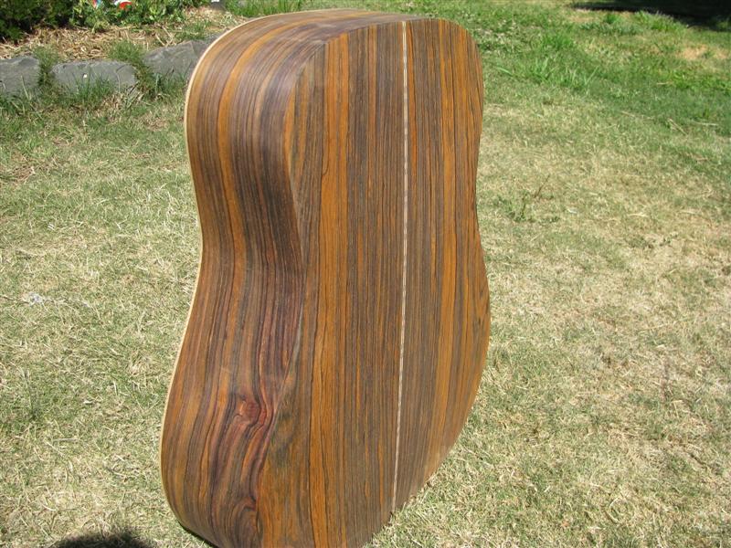

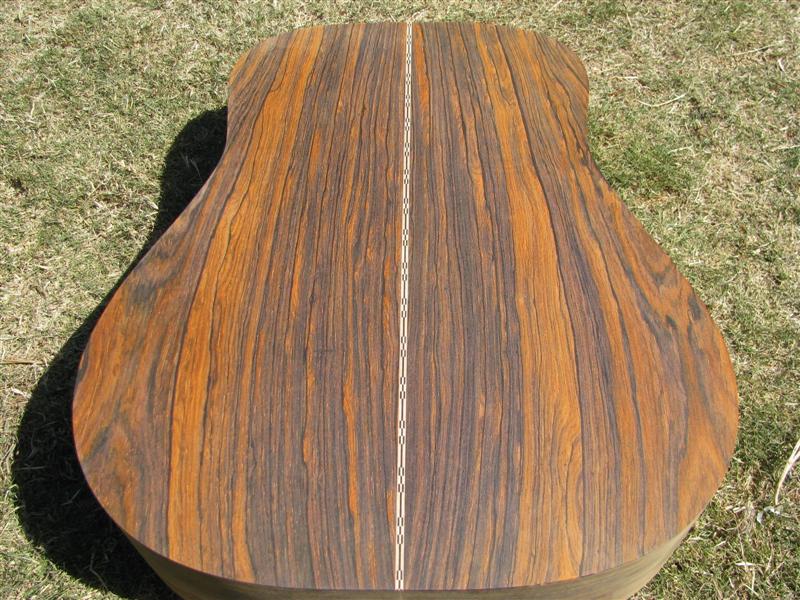

The back has now been glued on and it's starting to look a little like a guitar.

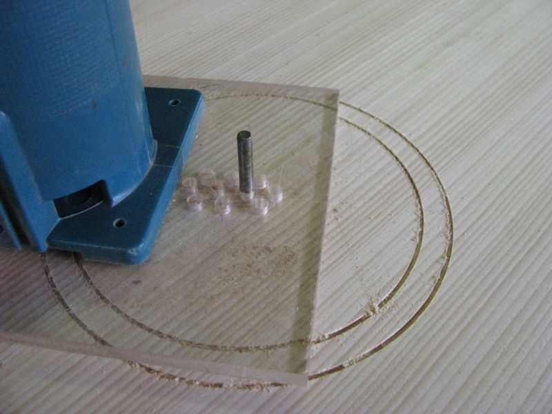

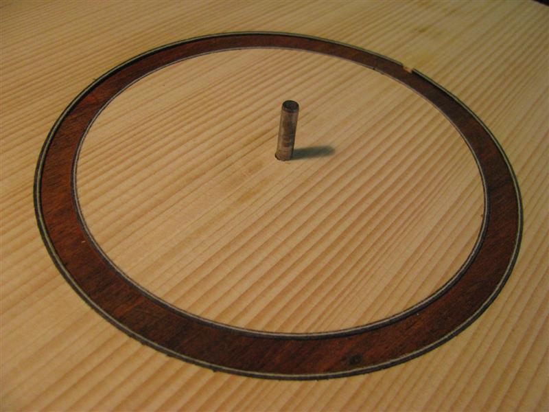

I started on the soundboard, so the first job is to stick the rosette in. I don't get too adventurous with rosettes and the jig is simple and foolproof.
The different holes are for different sized soundholes and purflings around the main rosette. The secret of the rosette cutting jig is to have a router bit the same diameter as the thickness of your purfling.
The rosette is Cocobolo. This one was warped and cracked before I routed it out so I didn't know if it was going to work but I think it'll be OK.

I've seen some people who glue the entire strip on first, then install the braces which wouldn't suit the way I carve the braces. I do have a jig to line the strips up but rarely use it and I'll do it by eye.
I'd never consciously thought about glueing those two strips in last. I've just always done it that way.
I love watching what other people do as in Dave White's Uke build. Everyone has a different spin on certain aspects of the process that you can incorporate to simplify or idiot-proof things.

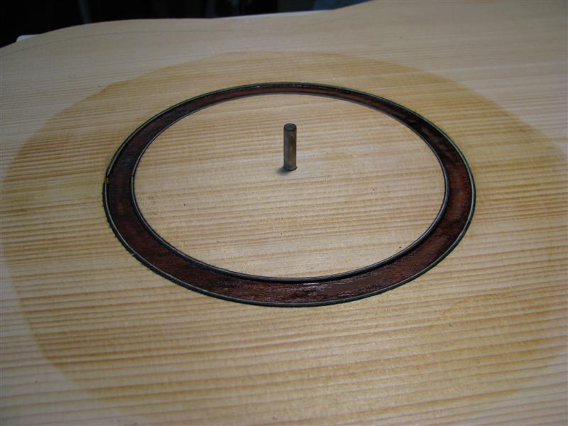

The rosette got glued in this morning with Hot Stuff cyano-acrylate.
The area routed out for the rosette was sealed with Shellac, particularly the end grain, to stop the glue from staining the spruce yellow.

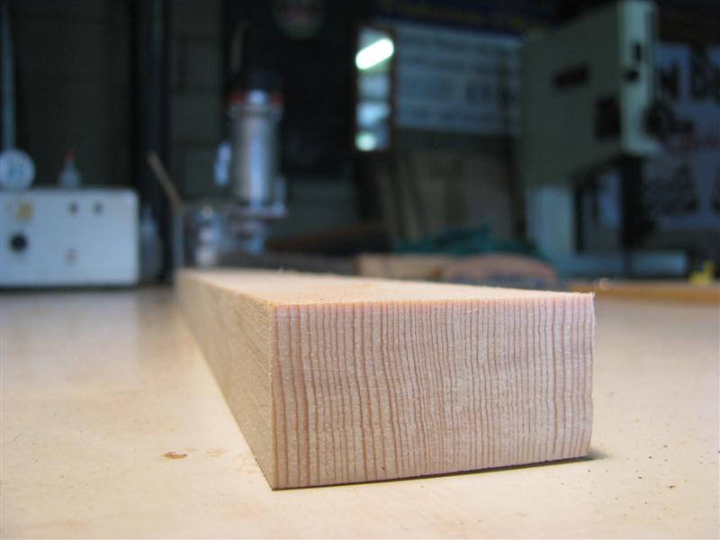

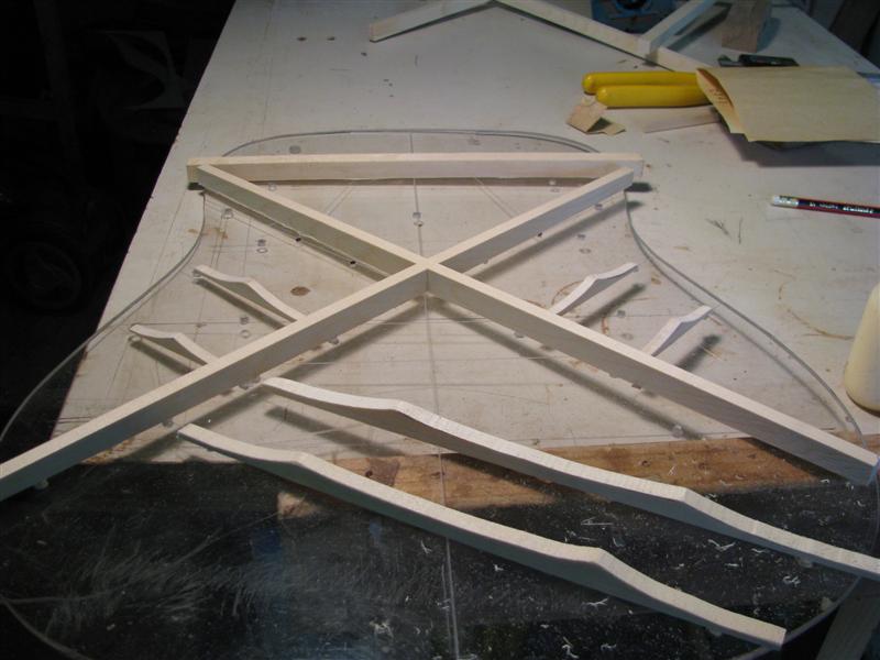

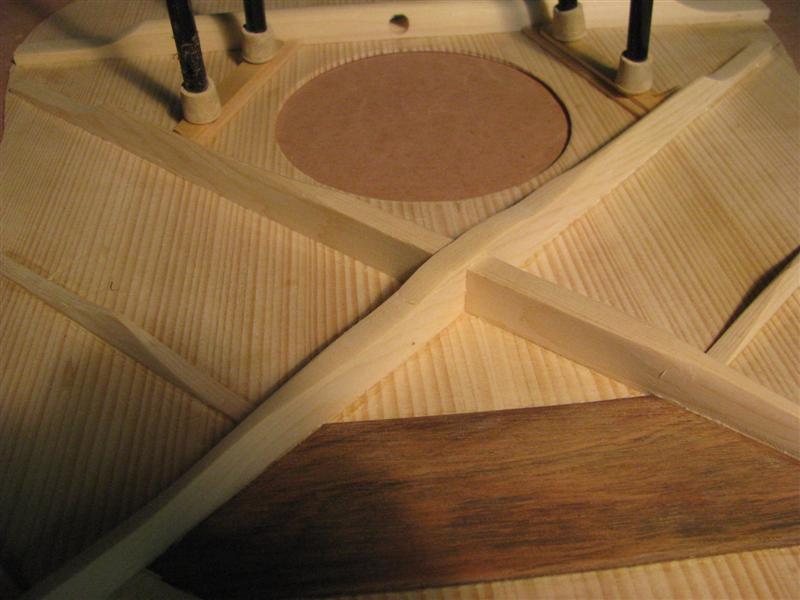

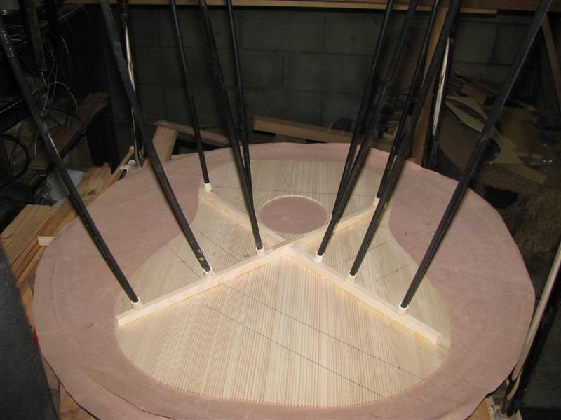

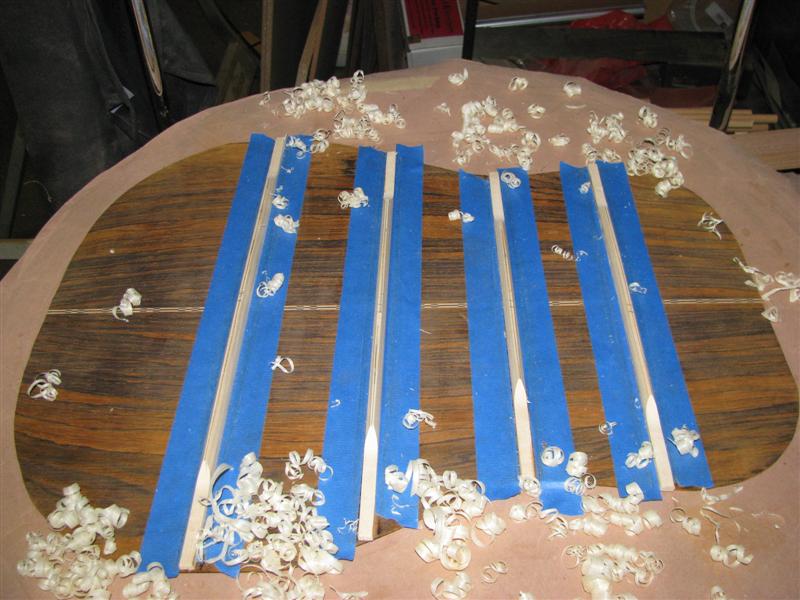

We now need some braces for the top so we'll start with a lump of nicely quarter-sawn Adirondack Spruce.

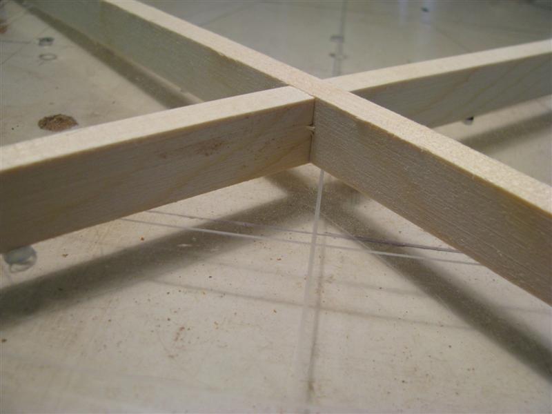

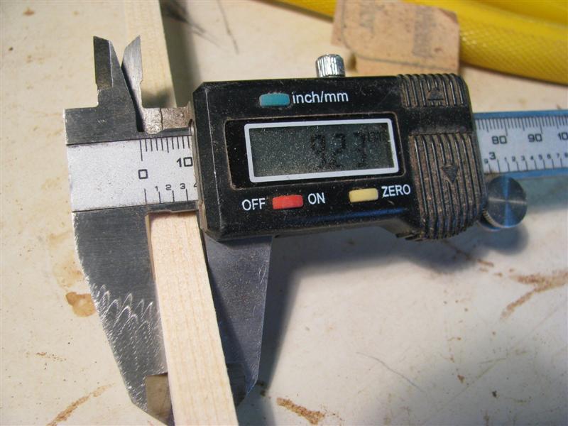

This is a Dreadnought so the X-braces need to be 15mm x 8mm.

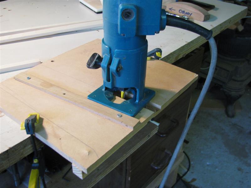

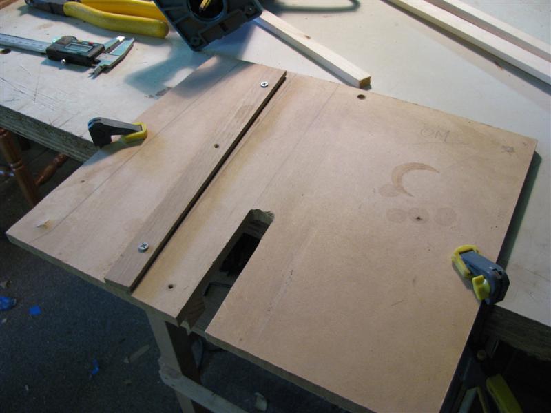

I'll use a router to cut the lap joint in these so I'll leave the brace stock a little thicker - around 9mm

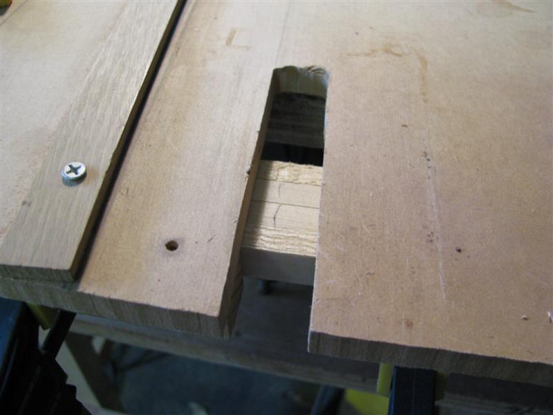

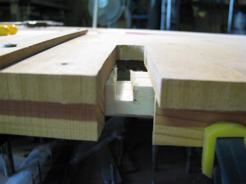

Here's the jig I made for cutting the perfect lap joint.
Thats an 8mm router bit. if I'm building OOO's or smaller guitars it'll be 6mm.
The braces are the two pieces of wood with the pencil mark. The outside pieces are sacrificial to stop the router bit blowing out when it exits the wood.

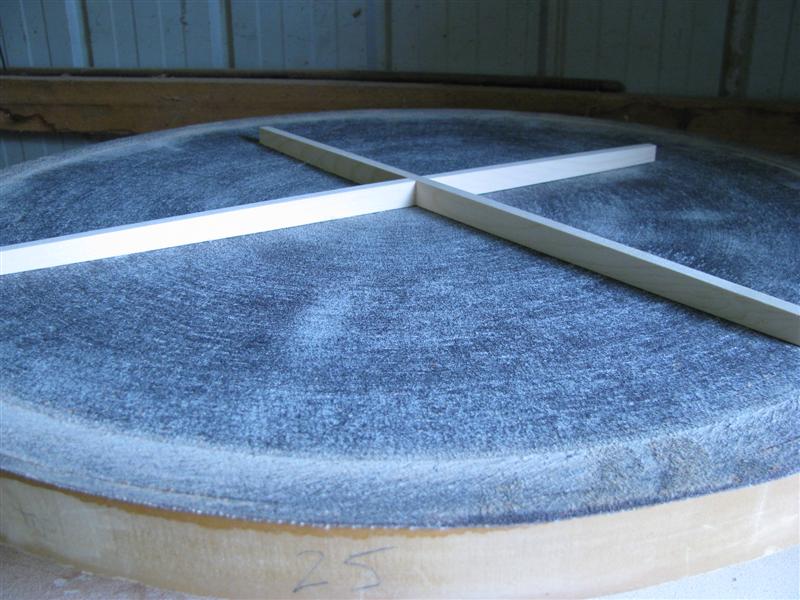

Once the braces have been routed I'll run them through the drum sander and sort of "sneak up on 'em" so I get a perfect fit.
The X-braces are the only braces on the top that I radius to 25 feet. They'll also be glued using the 25' radius dish. All of the other braces are flat and are glued against a flat surface. I started doing this after talking with Jack Spira who does similar (or was last year). It helps neck geometery a lot on the upper bout and certainly hasn't hurt the sound of the instruments. In the scheme of things it probably means that I end up with a top of 30' or 35' radius. I've never bothered to measure it because it'll change with humidity and string tension etc.

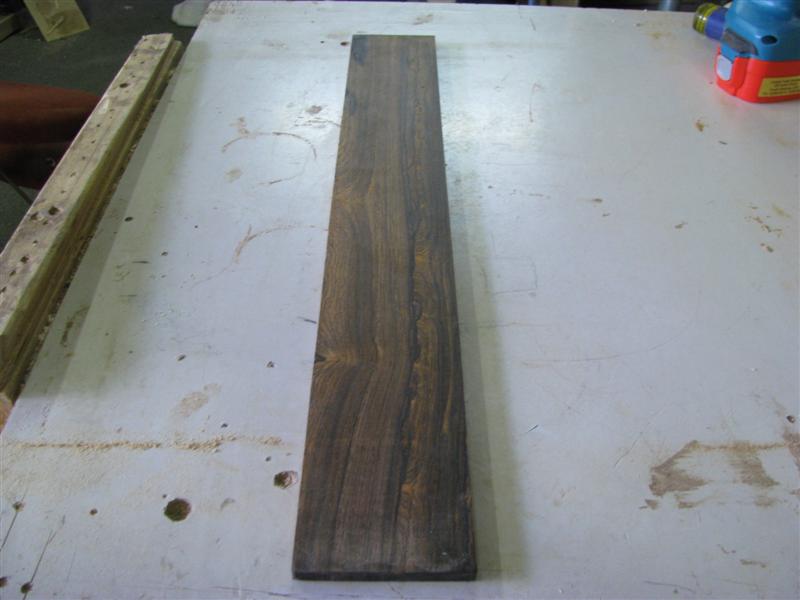

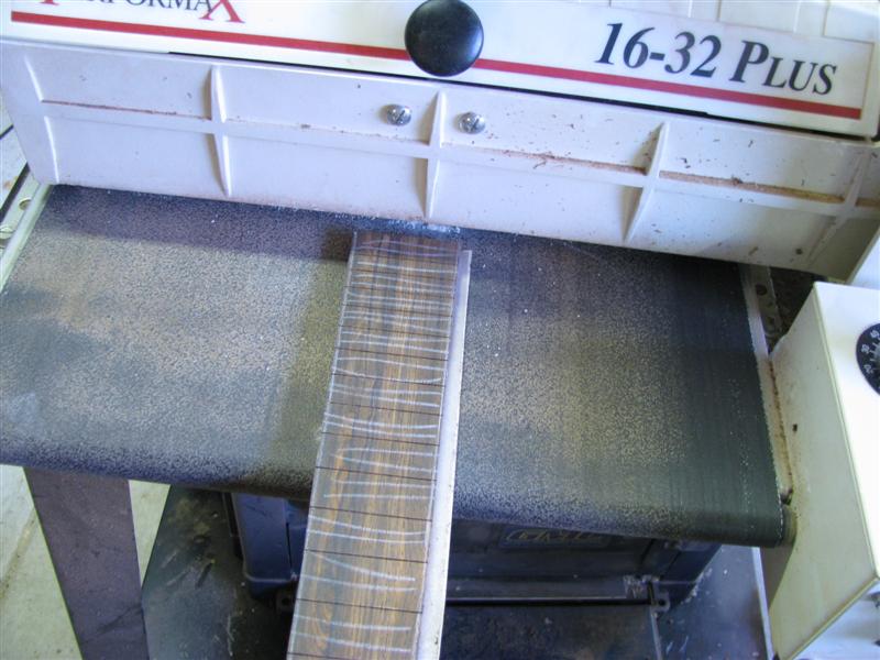

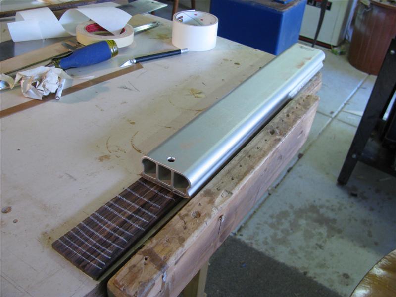

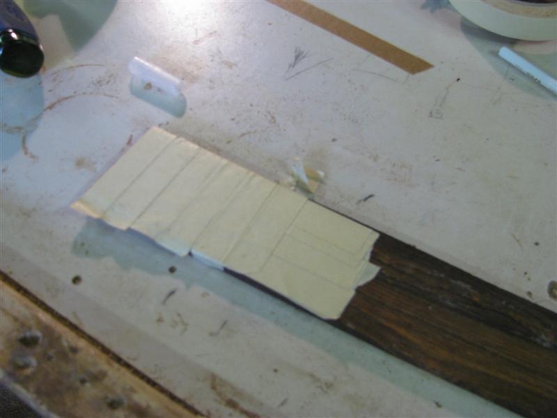

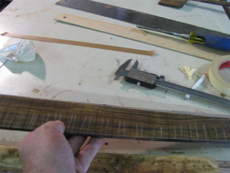

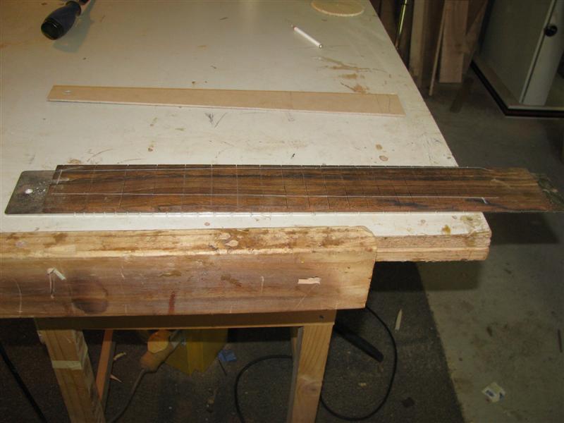

While waiting for the glue to dry I got stuck into the fingerboard, also Cocobolo.
The fingerboard radius is 16" so I'm going to be lazy and try and get some of the sanding done on the drum sander. 8 or 9 layers of tape along one edge should do the trick.
I lik about a 1mm drop off after the 14th fret so I thought I'd try and do this on the belt sander as well. It seemed to work OK but I had to re-radius that area manually.

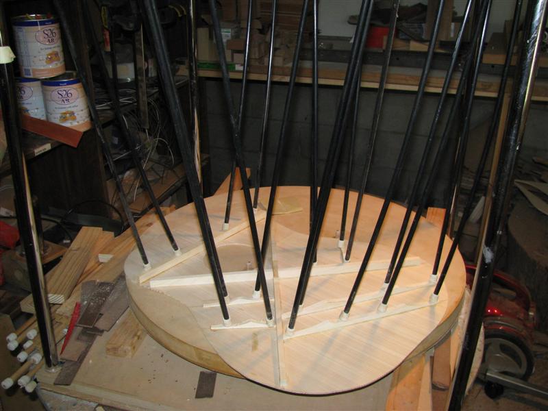

Here we are back at the top glueing the rest of the braces on a flat surface. The bridge plate will be Brazilian Rosewood.

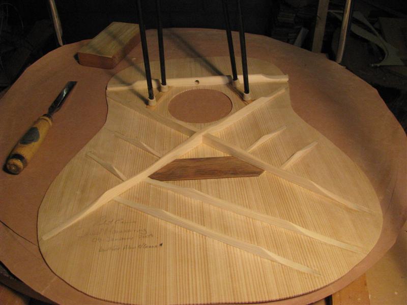

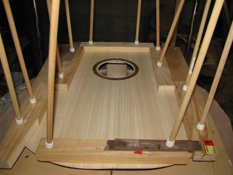

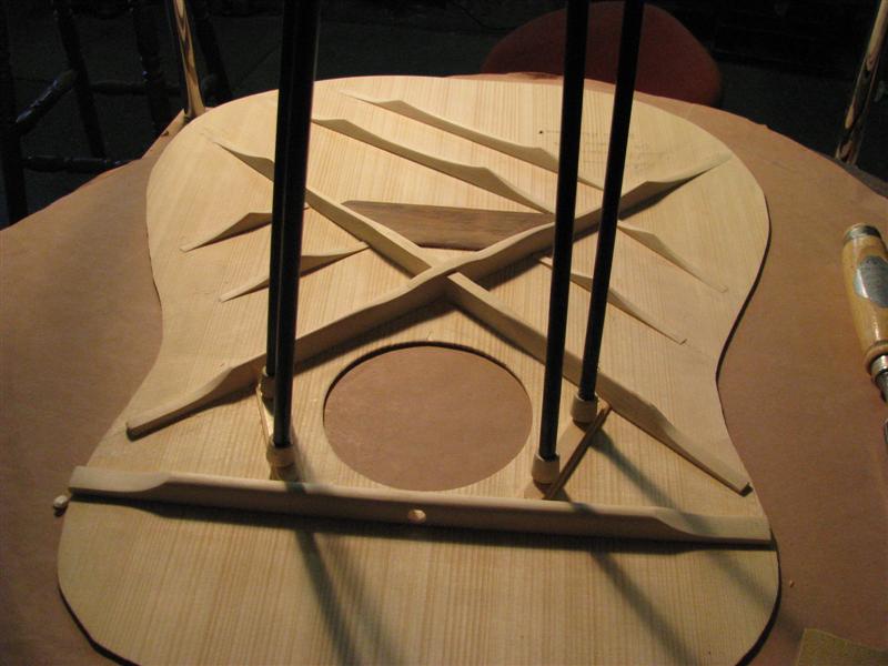

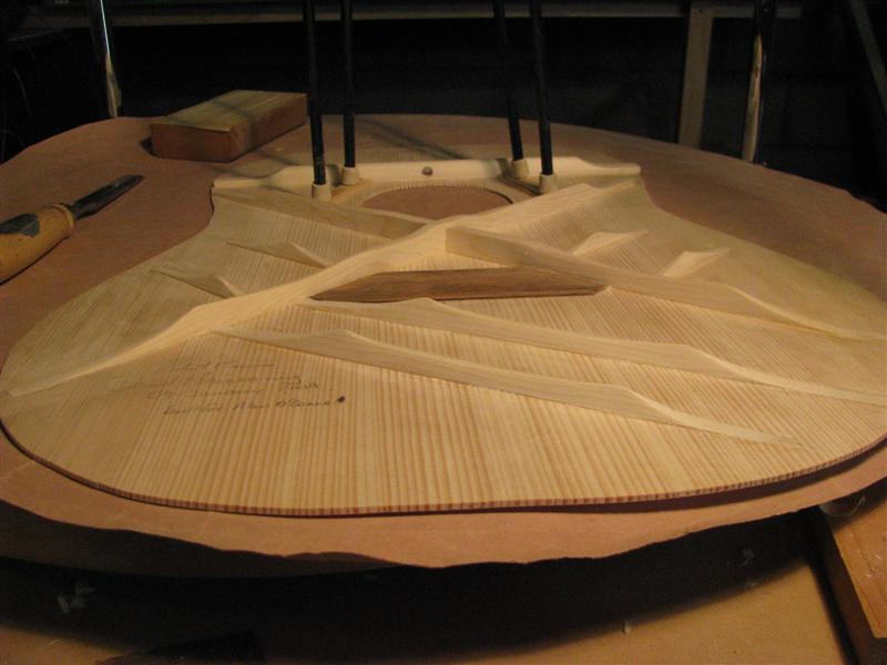

The top got voiced yesterday and I have to say that I love Red Spruce. This particular lot that came from Colonial Tonewoods and RCTonewoods have exceptional sustain and you don't seem to have to work too hard at voicing these tops before they are sustaining nicely.
This top is quite heavy. With the braces on and carved it's 305 grams. As I've stated previously I've weighed all of the Adi tops in stock and there's up to 100 grams difference in an uncut top set.
But it is a dready that's being built for medium gauge (13-54) strings so it will need to be fairly beefy. The top has been thinned to 2.7mm.
This one was sounding quite nice without scalloping the X-braces and I was tempted to leave it like that but the scalloping seemd to open up the sound a little more and the sustain increased.
I've left it fairly chunky in the "corridor of uncertainty" where most of the string tension is going to try and twist the bridge and what's under it.
I'm simply looking for a sustaining note all over the top when tapped and particularly so in the lower bout and also paying attention to those areas where the braces intersect.

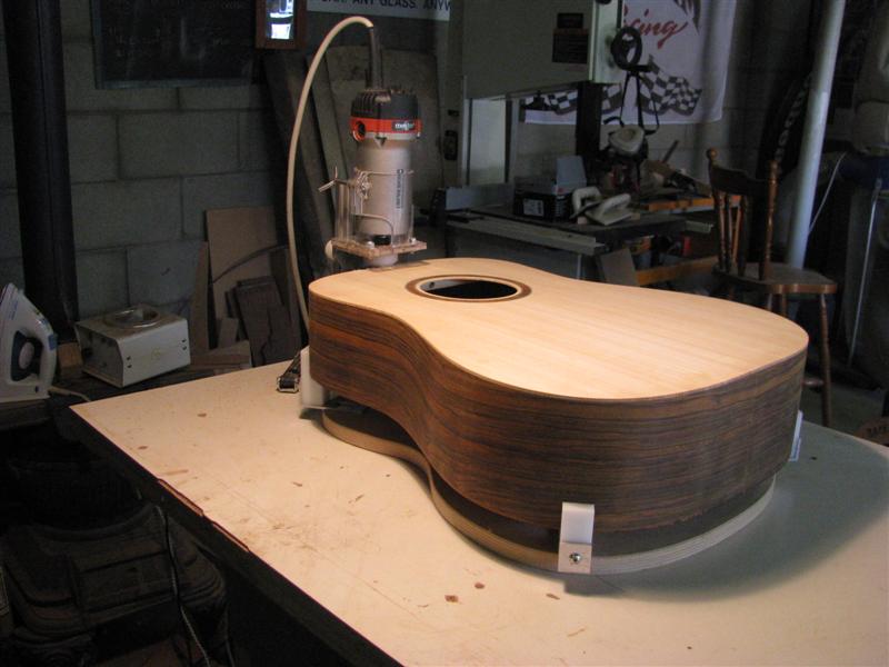

I'm happy with the sound of it so on goes the top with Titebond.
Once it's glued I'll take it out and rout off the top waste with a mini trimmer and a guide bit and then it's side flattening time.

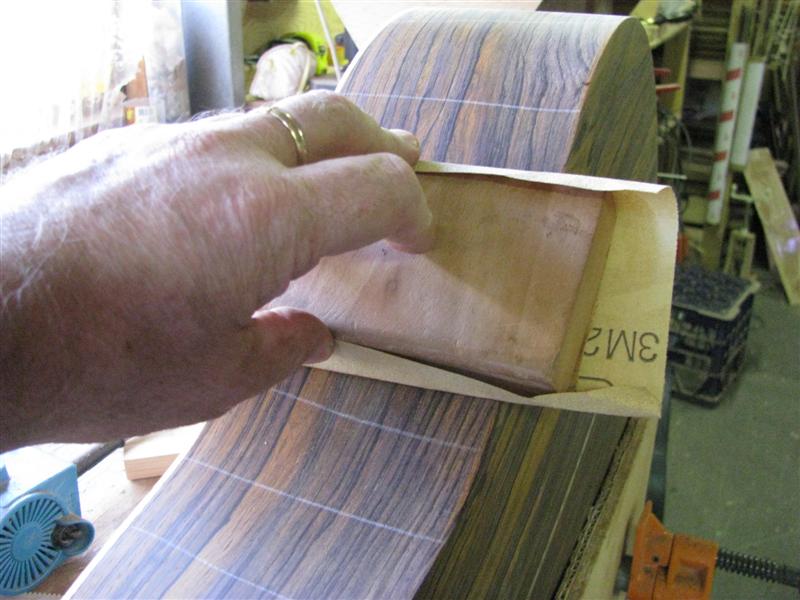

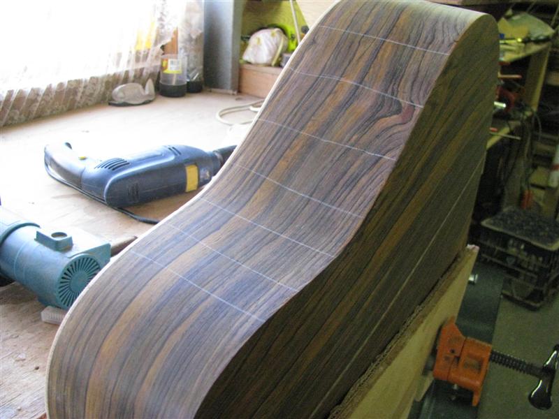

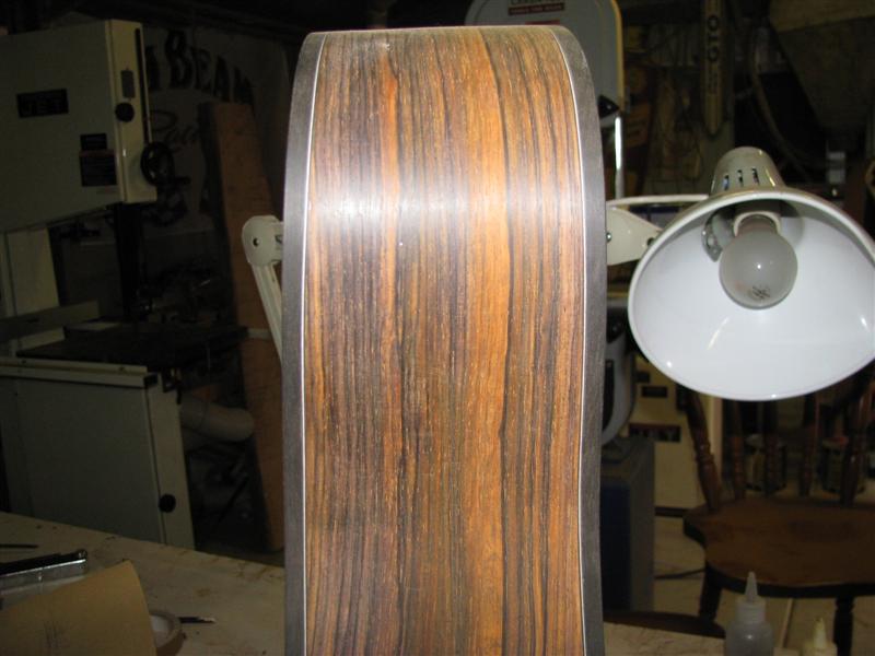

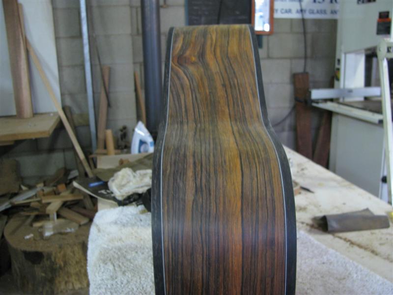

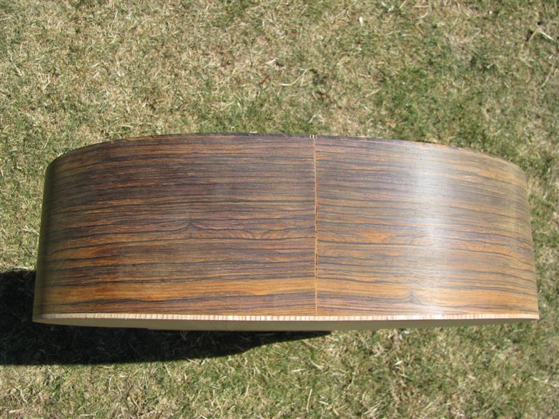

Just about all sides seem to cup a little when you are bending them and this seems to be exacerbated by adding too much water.
I flatten then by hand. It doesn't take too long and the result will be noticeable particularly if you are going to use a high gloss finish.
Mark the sides with a pencil so you can see when the sides are dead flat and use a flat sanding block with 80 or 120 grit sandpaper.

There are so many colours in it. Vivid oranges, purples and all sorts of brown hues. It's really going to pop under finish.
It is very heavy though so it'll be interesting to see what effect it has on the instrument.

I learned a tip from Mario for flattening the sides that worked very well for me. After the overhang is cut off use the largest bearing in your binding router bit set and cut a shallow "pre-binding" channel.
This shallow channel takes the top and back plates out of play when leveling the sides and makes the leveling job go twice as fast. The other benefit is that when you go to cut the final binding channels you are removing less material now with less risk of something untoward.... happening.

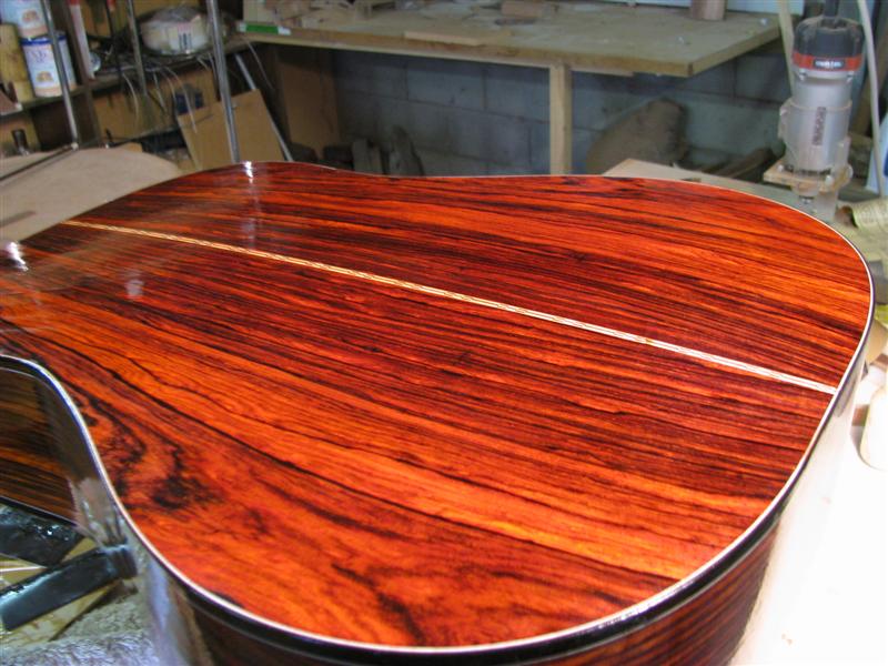

Post by Bob Connor » Tue Feb 03, 2009 9:09 pm
Things have been on the backburner for the last couple of weeks.
I spent a week in Tasmania getting more wood and got back into this last weekend.
The binding channels were cut before I went to Tassie.
I use the StewMac Tru Channel binding jig with the StewMac router bit set.
Two gripes I have about this set up are:
The donut is not quite wide enough if you wantt to cut a wide purfling channel first (herringbone, for instance) and the router bit guide is not quite deep enough if you want to install reasonably deep bindings.
Other than that if you are aware of the limitations it works reasonably well.

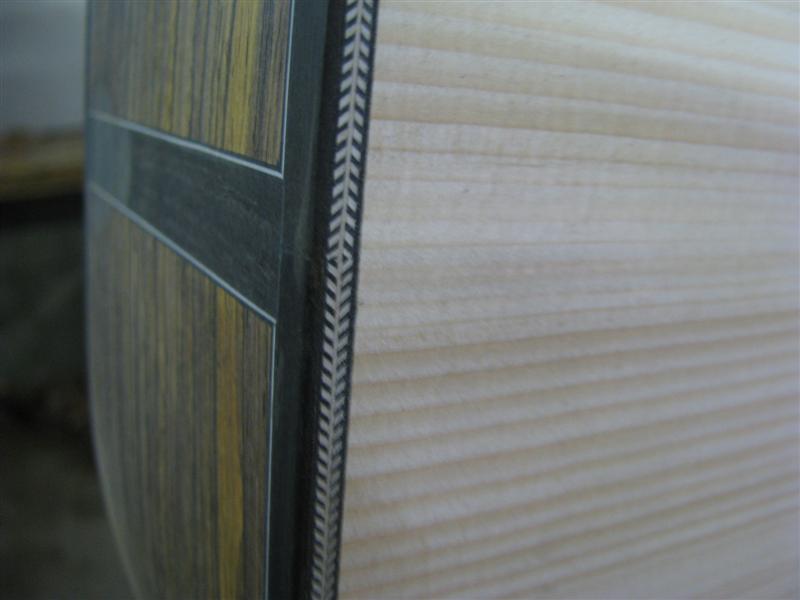

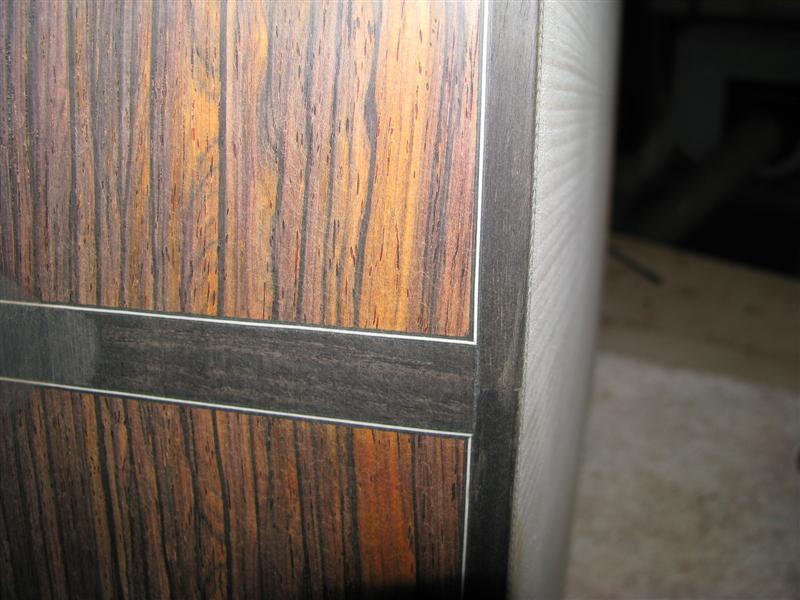

This Dread is getting Ebony bindings with a BWB purfling scheme and Herringbone on the top.
I bend the binding and the side purflings in the bender before installation.
I do the same with the Herringbone and will usually do about 6 at a time just so they will stack together and bend without twisting.
I didn't take any pics of the binding channel cutting because things usually get a bit stressful at this point and the camera is the last thing on my mind. Robbie O'Briens vids do it exactly how I do so we'll use them as a reference.
Here's a few pics of the finished product. One of my favorite parts of building is seeing the guitar in the white. It's here that you can see if your design elements are working harmoniously.
the next step is pore filling for which I use Z-Poxy. After Kim's reaction to this stuff I take a few more precautions which include respirator, gloves, and fan to blow fumes away.
I use an old credit card to mash the z-poxy into the pores on a 45 degree angle and then squeegee it of with the credit card. Then sand back with 220 grit. I'll probably re-apply it 2 or 3 times before I'm satisfied the pores are completely filled. Hesh has done a great tutorial on using Z-poxy over at the OLF. You can find it here
Hesh's Z-Poxy Tutorial
I do it exactly as he describes.
The Z-poxy really pops the grain. this Coco is going to look really nice under finish.
