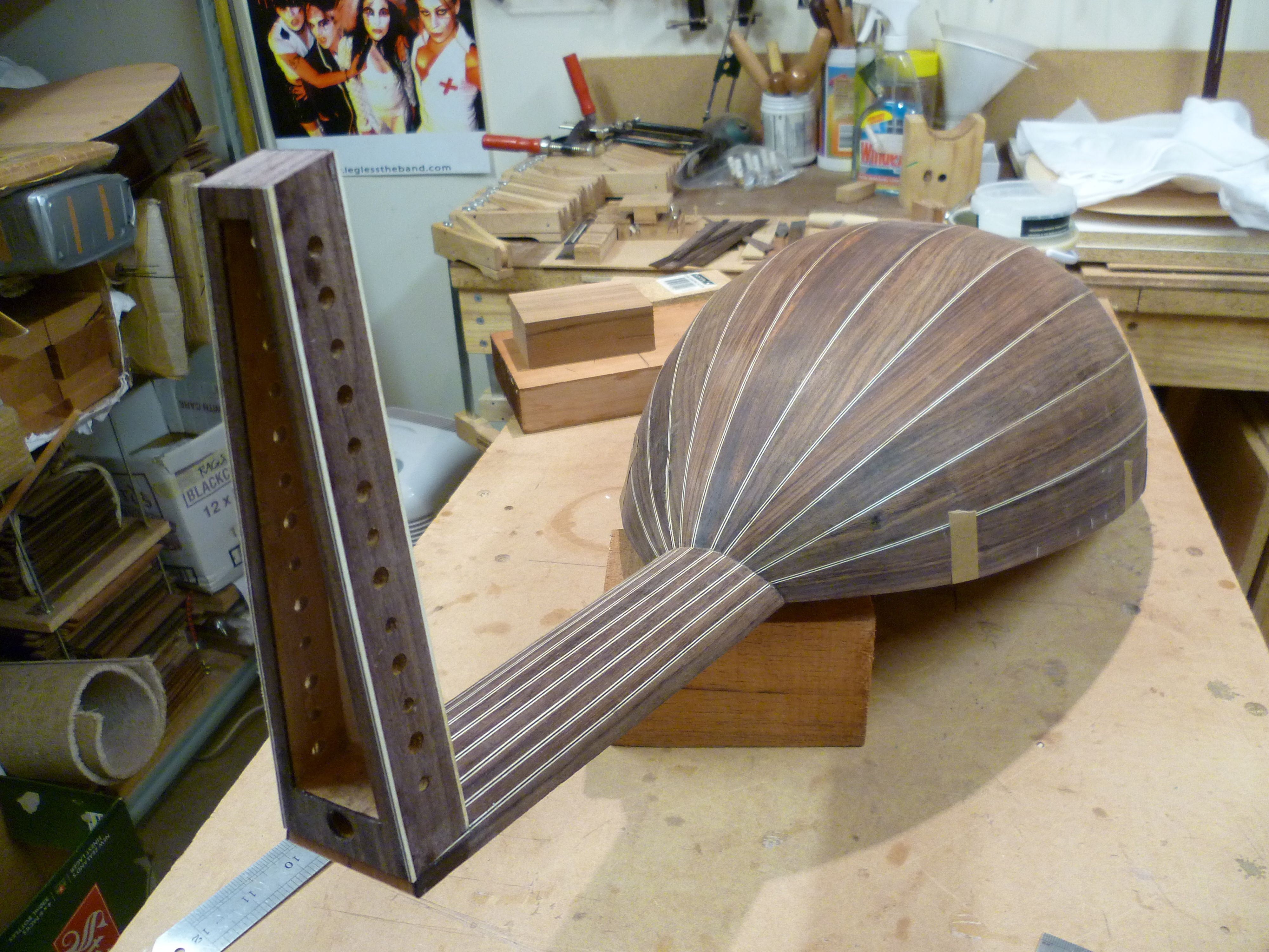

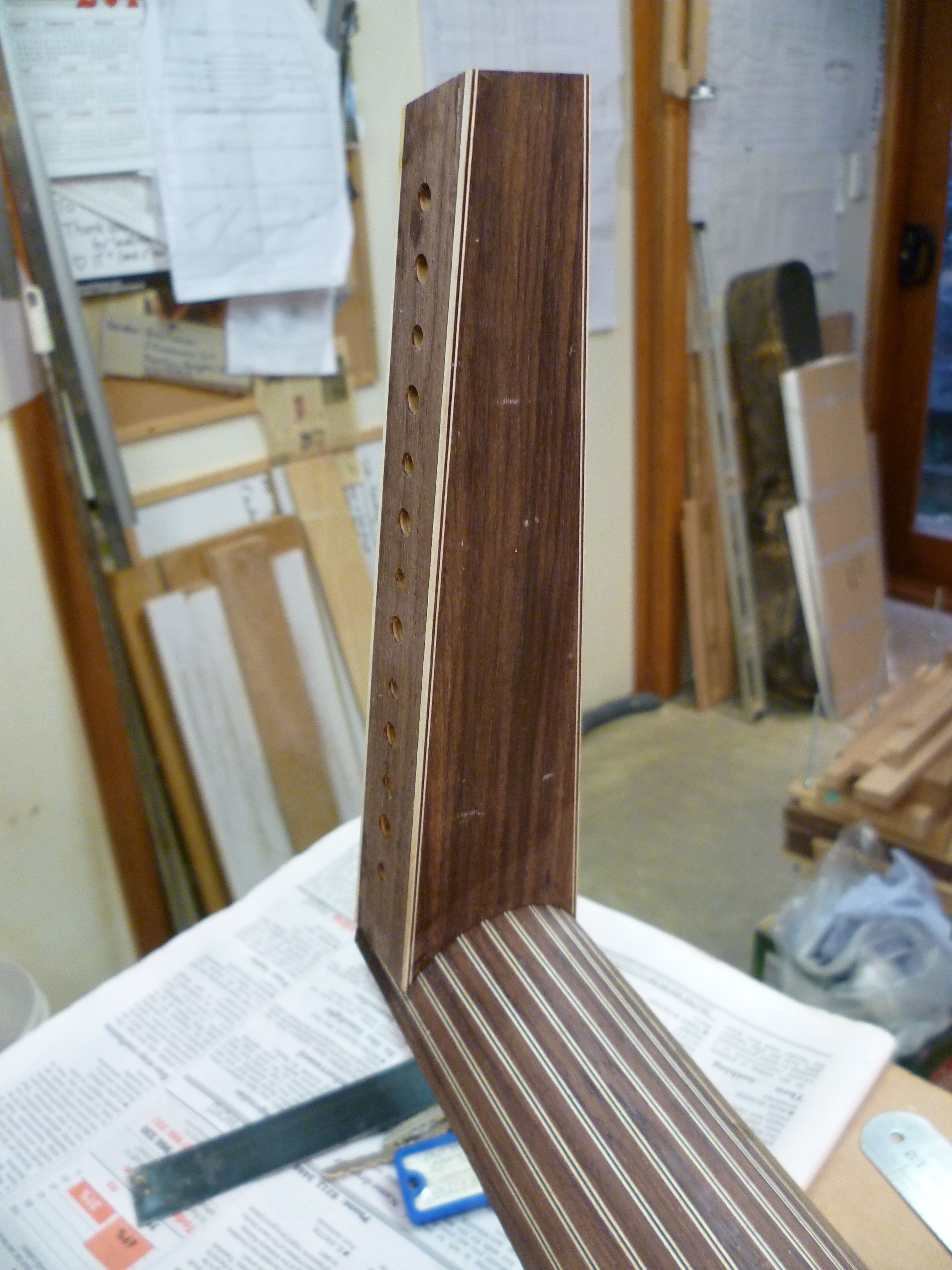

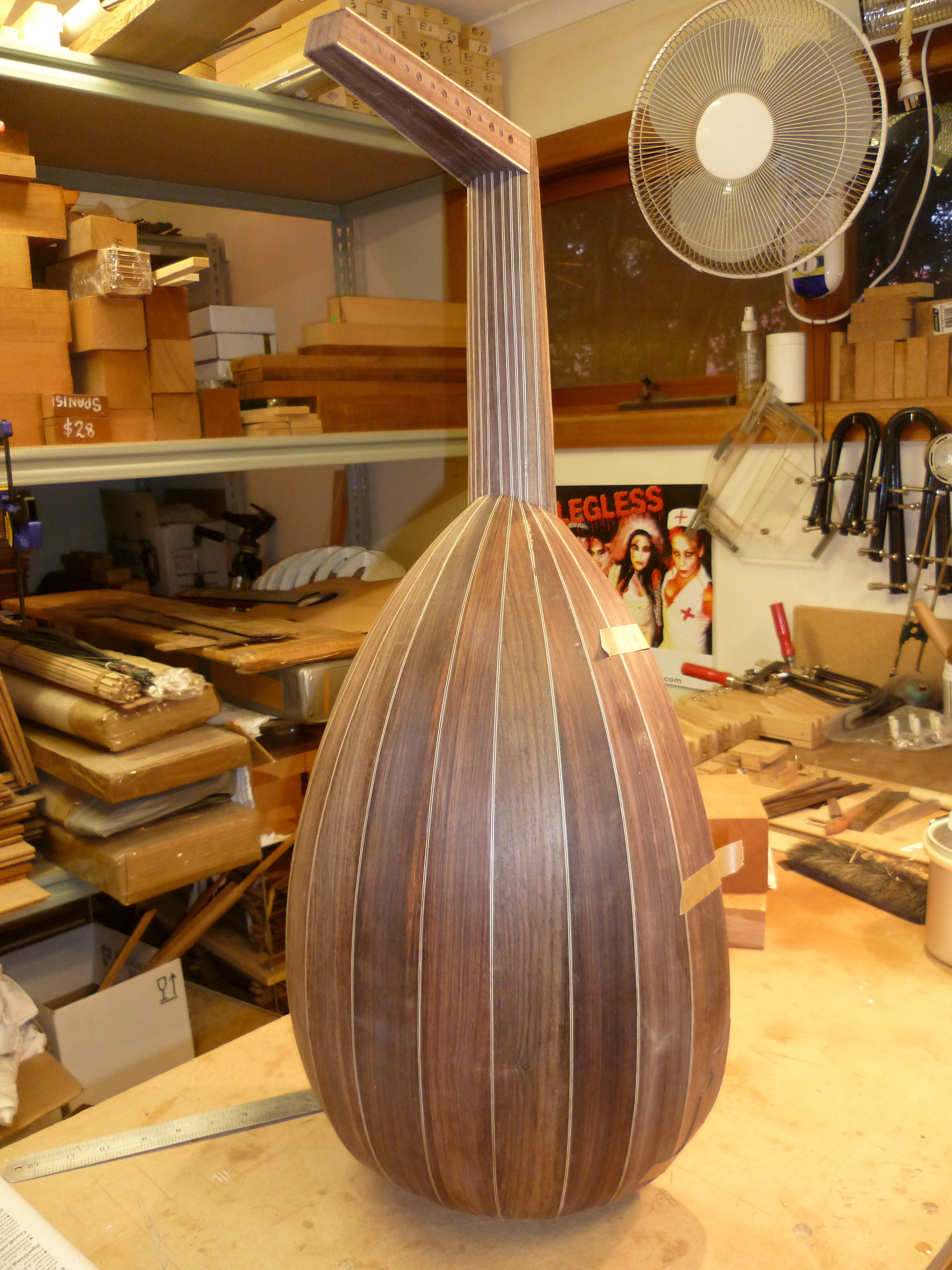

That was the line of reasoning applied after consulting every picture I could of backs of pegboxes.Allen wrote:I like the way that just a couple of purfling lines continue on to the peg box. All of them would be away too much, and none would look unfinished.
Lute Progress -
Re: Lute Progress -
Re: Lute Progress -
Tis looking puurdy my good sir, for sooth. I'd sort of pictured that all the purfs continuing up would be the way to go but just the outer ones have proved me wrong, breaks the pattern up nicely. I take it the screw hole gets a plug in it or do you just plate the screw in 24 carat gold?
& the offer to spin up some pegs still stand if required.
Re: Lute Progress -
Hi Nick,Nick wrote:Tis looking puurdy my good sir, for sooth. I'd sort of pictured that all the purfs continuing up would be the way to go but just the outer ones have proved me wrong, breaks the pattern up nicely. I take it the screw hole gets a plug in it or do you just plate the screw in 24 carat gold?& the offer to spin up some pegs still stand if required.
Yes the screw hole gets a plug...the hole was drilled with a countersink/drill bit. The primary function of the screw is to apply clamping pressure along the axis of the neck....I used it purely because I couldn't be bothered setting up a complicated clamping caul to enable application of along axis clamping pressure using conventional clamps.
Cheers Martin

Re: Lute Progress -
The lute is looking fantastic Martin - tasteful and well executed.
They do have a very appealing form the old 'bowl backed' instruments; something of craftsmanship.
Not sure what the plan calls for but... The screw looks countersunk enough that you could always consider using a little rare earth magnet on the plug/cap, glued beneath to hold it in place. That way, removal in future would be easy with a second magnet should it ever be required. Just a thought.
Re: Lute Progress -
The end block into which the hole is drilled into gets beveled so a magnet probably wouldnt sit square in the hole. Plans call for a wooden plug to be glued in and beveled off with the block.
Cheers Martin

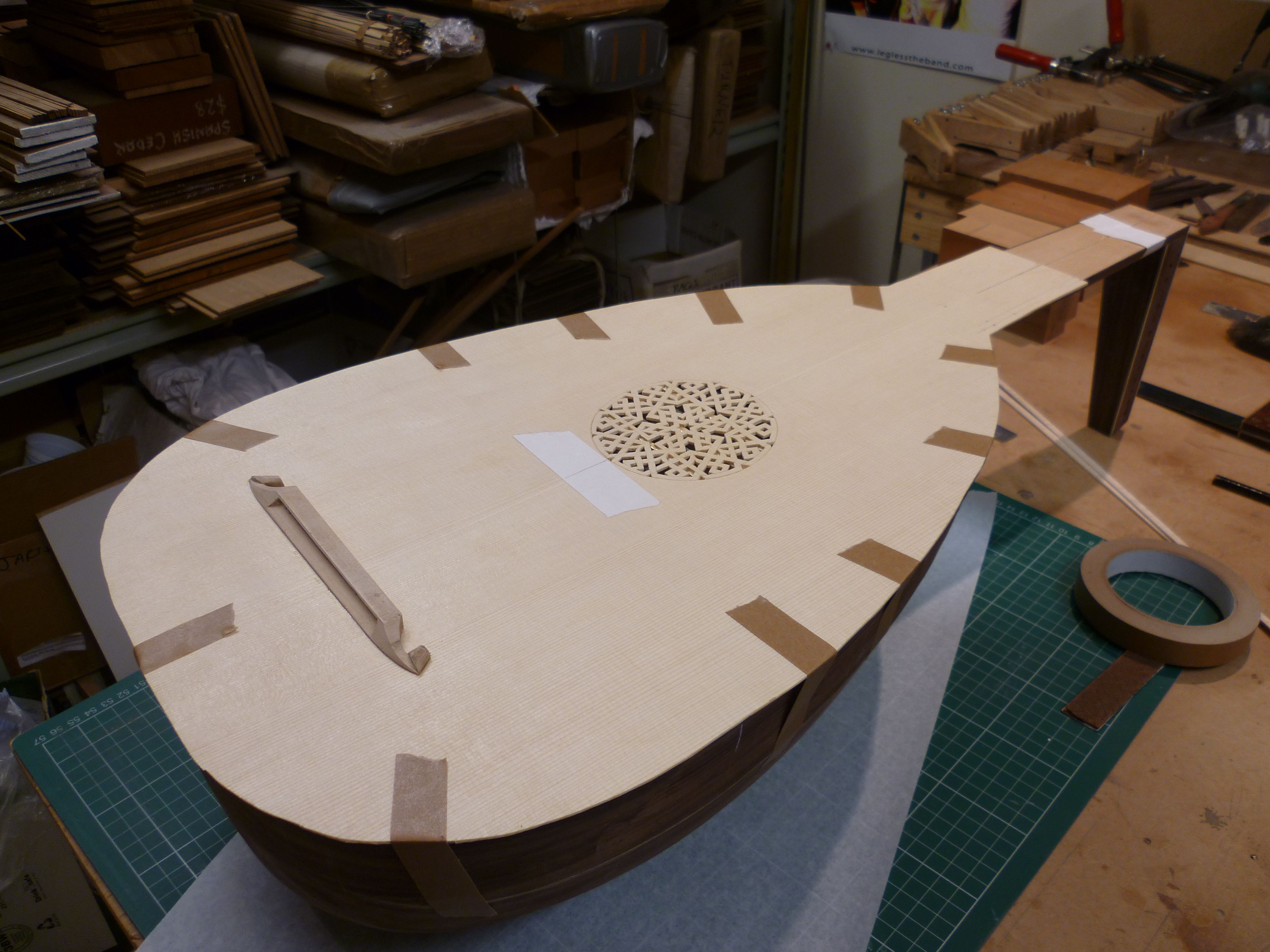

A couple of more pics. I'm exhausted and goings on in Christchurch New Zealand have to take precedence from here so the lute project will be going on hold.
Re: Lute Progress -
It's nearly a lute now and looking spectacular.

Why do you want all them thar holes in the peg-head? Are you trying to reduce weight? Feeling a little neck heavy is it?
F*ck, I'm funny.
Looking good Martin.
F*ck, I'm funny.
Re: Lute Progress -
Actually, I wonder what such a severe angle on the headstock (if that's the right term for a lute) would have on the balance on the instrument? It'd certainly pull the centre of gravity back in towards the body of the player wouldn't it? Hmmm, see what happens when you try to be a flippant smart arse? Gets you thinking...
Anyone tried to build one with a 15 degree angle on the headstock? Now, I'd bet that sucker was neck heavy.
Re: Lute Progress -
26 holes Paul. This lutes a baby....6 double courses and a single chantrelle. Check out the peg boxes on a arch lute.....they have two of boxes to accomodate all the pegs.Paul B wrote:Why do you want all them thar holes in the peg-head? Are you trying to reduce weight? Feeling a little neck heavy is it?
F*ck, I'm funny.
Re: Lute Progress -
Cant give you a straight answer Paul. On archlutes the peg box/neck angle is alot shallower. I'd say its to do with reducing stress on the pegbox/neck joint. With the angle close to 90degrees string pull is on the nut and then from the nut directly along the plane of the pegbox. With a 15 degree angle you'd have the strings tending to pull up the pegbox more. I suspect the integrity of the actual neck/pegbox joint (eg max gluing surface) also has something to do with it as well.Paul B wrote:Actually, I wonder what such a severe angle on the headstock (if that's the right term for a lute) would have on the balance on the instrument? It'd certainly pull the centre of gravity back in towards the body of the player wouldn't it? Hmmm, see what happens when you try to be a flippant smart arse? Gets you thinking...
One more reason for the high pegbox/neck angle could be to bring all tuning pegs closer to the player.
Despite its apparent size in photos te lute is actually quite a small instrument. The scale length is only roughly 600mm on my lute. The instrument is also very light. The ribs are paper thin as is the top and the neck is really the only the substantial piece of solid wood on this instrument and that has a light core with veneer on the outside.

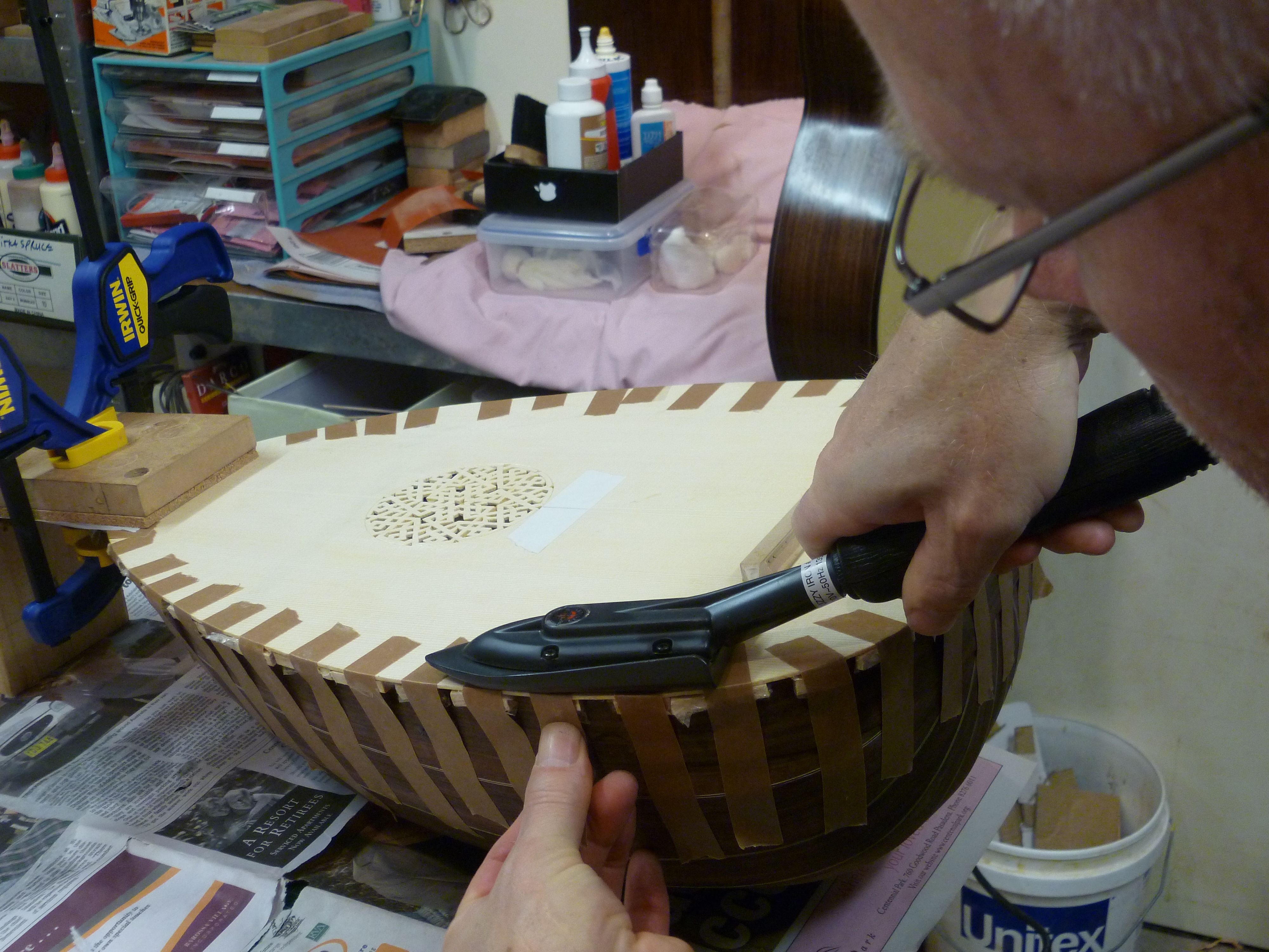

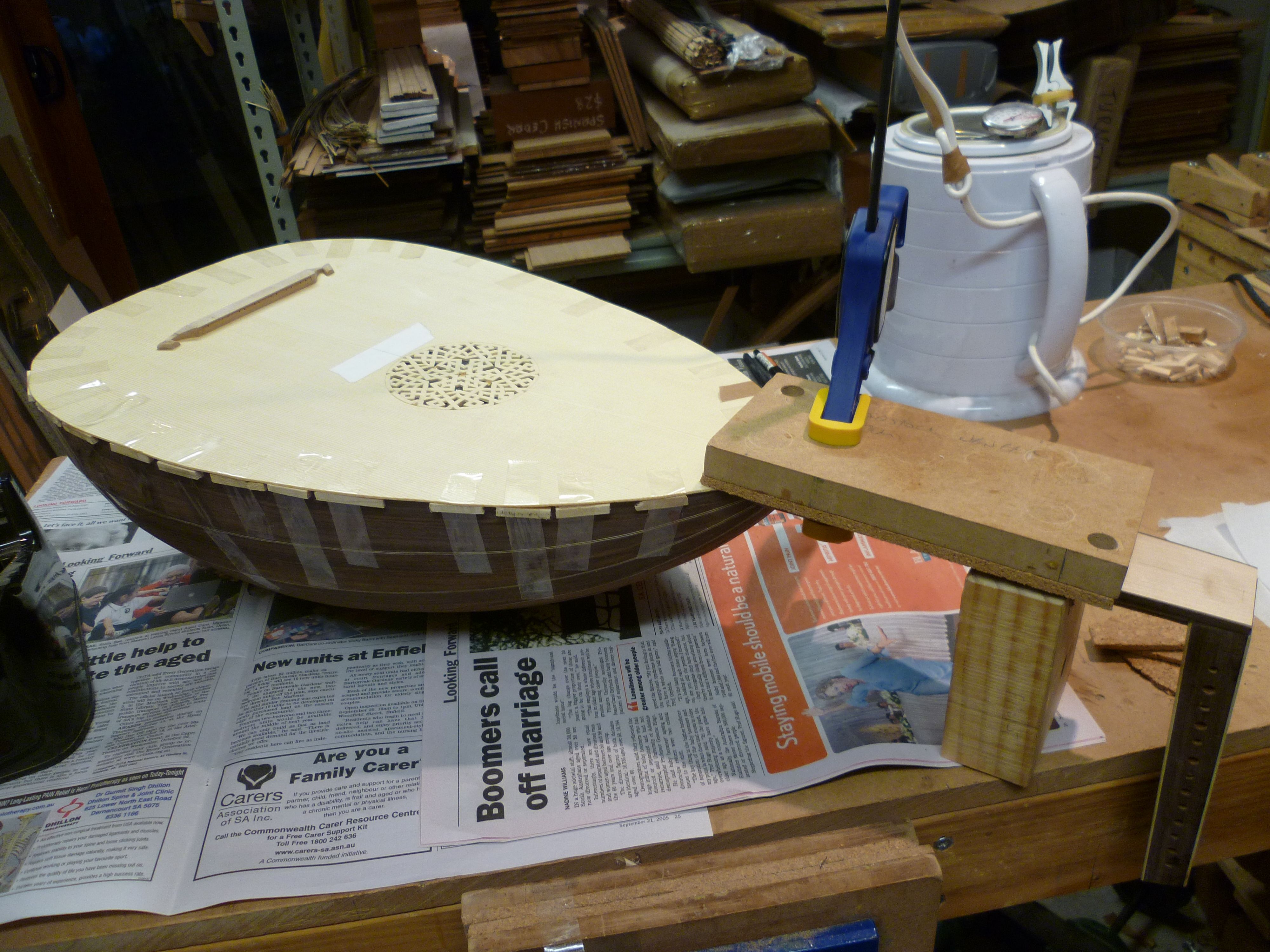

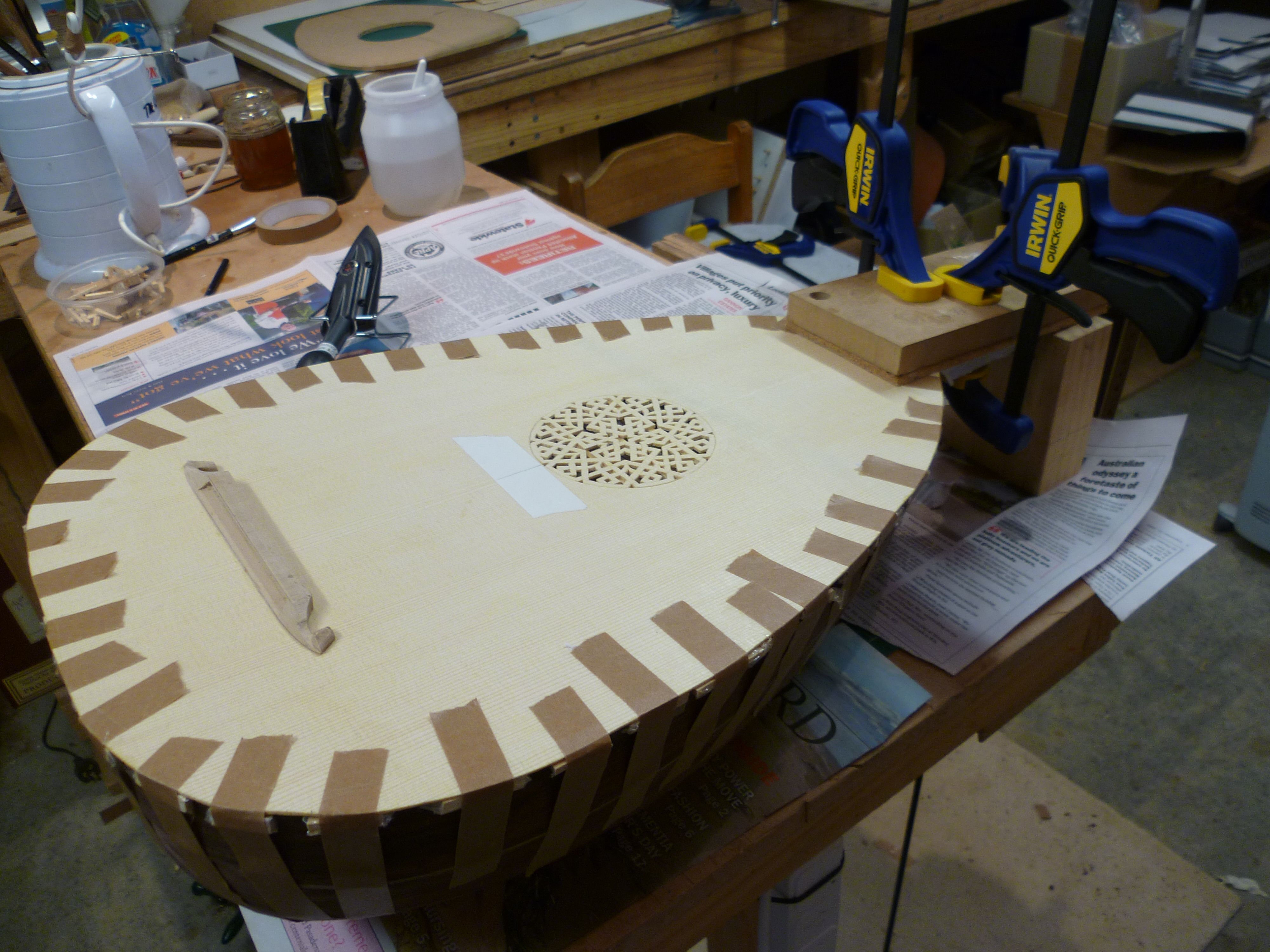

Despite other distractions today I managed to glue up the top. In second pic Im going around making sure the joint is good with a tacking iron.
