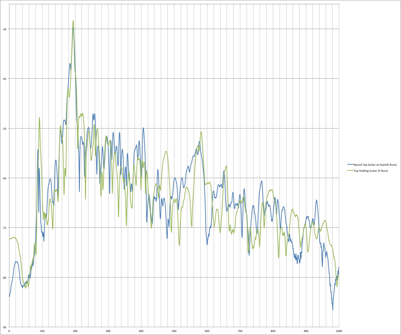

Okay I did a run of tap testing with the guitar held....lower waist on my knee and top edge against my chest. I held neck mid way with my left hand.
Heres a plot of data from guitar sitting on foam blocks and with the instrument held. Mic was around 50-60mm from bridge area.
- Posts: 1647
Re: Falcate braced classical
Martin, try backing the mic off to ~50-60cm. I should have picked that one up last time I asked you! Sorry about that.kiwigeo wrote:Mic was around 50-60mm from bridge area.

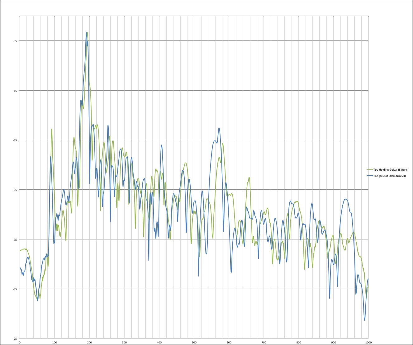

Ok I redid tap tests holding the guitar and with the mic at 50cm from soundhole. Peaks are still essentially the same but frequencies have dropped a few Hz. The interesting little peak at around 20Hz is interesting. I clamped G clamps to the headstock and gripped the neck to suppress vibration of same but it didnt have much effect on the peak. Ditto for the extra monopoles between T(1,1)1 and T(1,1)2 peaks. Plot shows data recorded holding guitar in normal fashion and with mic 50-60mm from bridge and 50cm from soundhole.

Hey Martin, i was getting jaggy plots like yours at first and it turned out to be double tapping on a micro level. I started using the corner of the rubber so on contact it did not slap and my plots started looking like the book. Also light taps with a light touch so the hammer bounces right off. That might make the plot easier to read. More important for plate thicknessing.

Dom,Dominic wrote:Hey Martin, i was getting jaggy plots like yours at first and it turned out to be double tapping on a micro level. I started using the corner of the rubber so on contact it did not slap and my plots started looking like the book. Also light taps with a light touch so the hammer bounces right off. That might make the plot easier to read. More important for plate thicknessing.
Thanks for the suggestions.
I've paid close attention to my tapping. I try and keep striking pressure the same and I bounce the eraser off the board once. I let the hammer fall from horizontal to the board rather than letting my arm muscles provide the effort. Am using one corner of the rubber as well.
