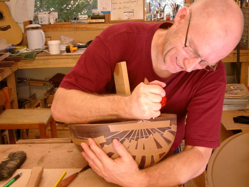

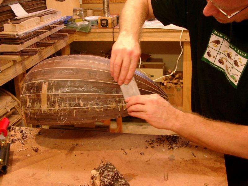

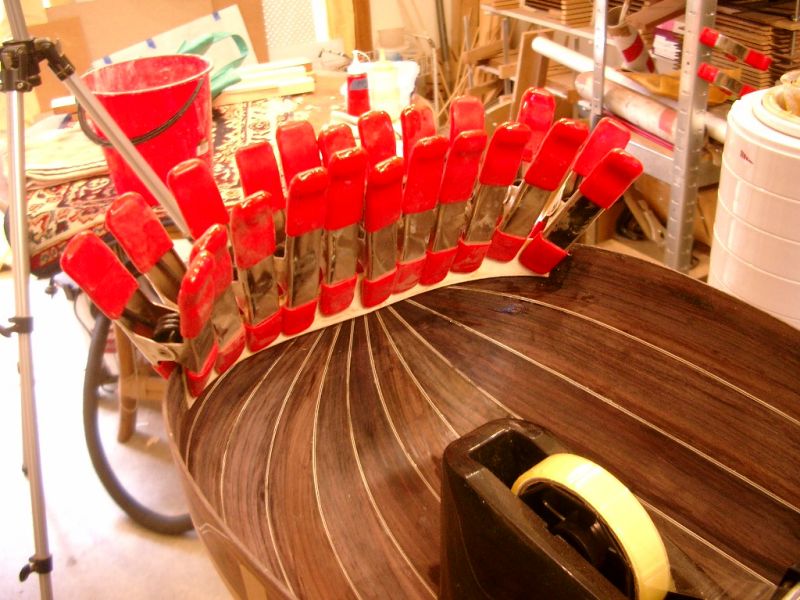

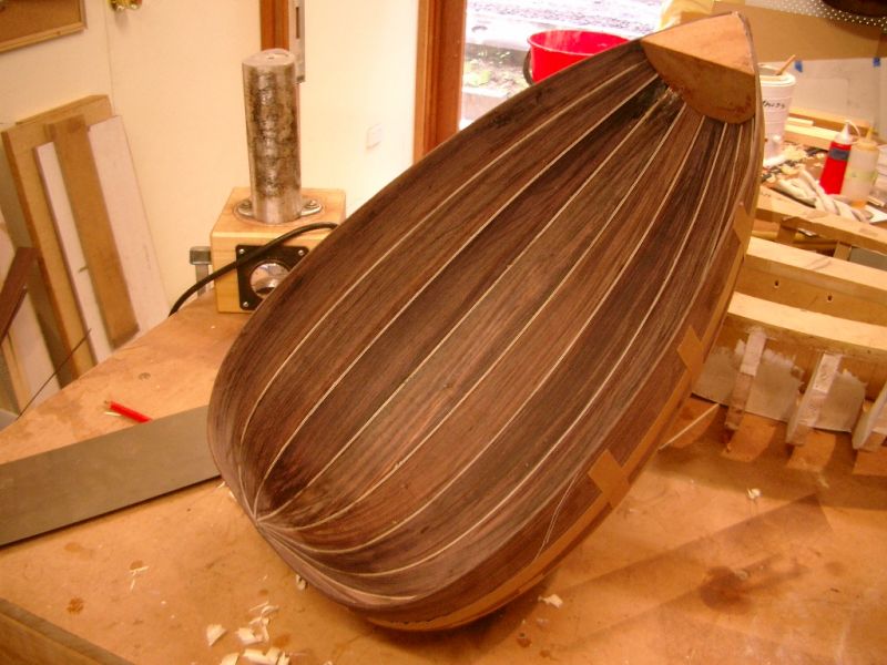

Crap weather here in Adelaide so I spent the weekend hiding in my climate controlled workshop. Managed to get the body of the lute off the mould, got the inside of same cleaned up and got the endliner bent up and glued in.

Looking fantastic Martin. Was it difficult to get it free from the mold? And how about cleaning up the inside. When I built my canoe, the inside was a complete PITA to smooth up. Enough so that I don't ever want to do another.

Getting the body free of the mould was a moment of nervousness. Luckily id smeared enough Ubeaut paste wax on the mould before starting rib glue up and my artists pallet knife was just the thing to get down between the mould and the ribs and free up a few spots where the ribs had become glued to the mould. Next time Ill follow Lundberg's suggestion to run the pallet knife under each rib after its glued in.
Cleaning up the inside starts with a dish sponge with a scourer surface on one side. With a bit of hot water and the sponge most of the excess glue gets removed. Whats left comes of with a cabinet scraper which I worked into a suitable curve on the bench grinder.

Mmmmmmmmmm melted cheese! Looking really good at the moment Martin and that moment of separation would be pucker inducing I can well imagine! Did you have to renew the edge of your scraper much after removing the glue from the outside?

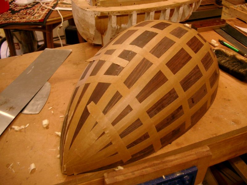

That looks great - much neater than mine at the tailblock end. Well done. What does Van Edwards recommend to use for the reinforcement strips on the inside joins?

van Andrews recommends 120gm/m2 acid free rag paper. Not sure what Ill use. I notice you used silk and I assume this was reccomended by Colin. Will be checking out some artist supply shops next week to see what paper theyve got available.

Nick O wrote: Did you have to renew the edge of your scraper much after removing the glue from the outside?
Nick, glue buildup on the outside of the body isnt as bad as on the inside. I work with a fleet of 6 scrapers so Im always working with a sharp one.
Post by Nick » Sun Aug 16, 2009 7:10 pm
kiwigeo wrote:Nick, glue buildup on the outside of the body isnt as bad as on the inside. I work with a fleet of 6 scrapers so Im always working with a sharp one.
Good thinking that man 8)

It took me three attempts to get the end liner right....had two tries at bending the bldi thing on Saturday and gave up. Switched on the bending iron this morning and went off for a cup of tea. Came back and looked at the smoldering iron and then turned it off and went off up to the village for a coffee. Decided over coffee that a lute wasnt going to get the better of me and came home and got the thing bent up in 40 minutes and glued in 30 minutes later.

There is not tail block on this lute. Alot of lutes dont appear to have tail blocks.....I believe its because it would intefer with acoustics of the top. Its the same reason linings arent common on lutes.
Soap could be used on the mould I guess...I just had the paste wax handy. There is nothing that gets glued to the inside surface of the lute body so its not a huge issue.
