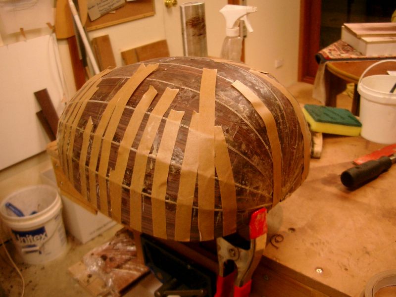

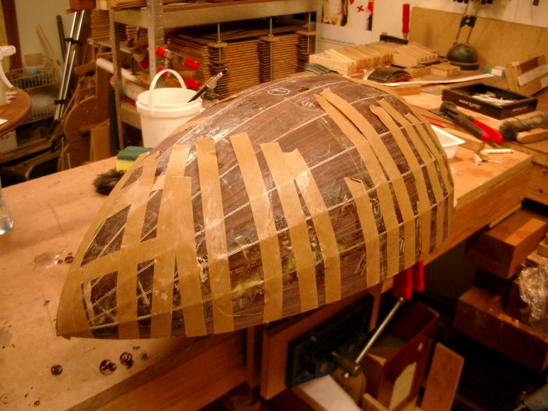

Post by kiwigeo » Tue Aug 11, 2009 8:34 pm
Back from work and fighting a cold but I managed to get a few hours in the shop yesterday and today and have got all the ribs glued in. It all looks a mess of hide glue and binding tape but tomorrow the outside of the bowl will get a clean up before it comes off the mould.

Post by Dennis Leahy » Wed Aug 12, 2009 12:23 am
Way to go, Martin! That has got to feel good getting all those ribs to form a bowl back. Well done!

Post by WaddyT » Wed Aug 12, 2009 2:09 am
Great progress Martin! If you do another half, you'll have a slightly misshapen football! American style football! :D

Post by Lillian » Wed Aug 12, 2009 11:50 am
An armadillo is born!
Martin, it looks great, even before its cleaned up. Its coming together very nicely.
