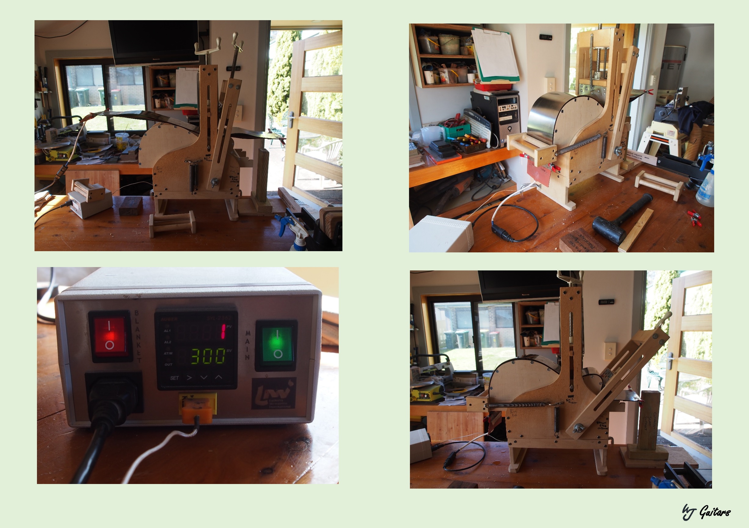

I am planning to bend Macassar Ebony sides on my Fox bending machine using metal slates and heater blanket. The sides thickness is 2mm and for the cutaway side zone is thinned to 1.9mm. I normally spray water and paper wrap the sides. My question is what temperature should I use: 300 degrees F ? 330F ? or may be 360F ?.
My Bending Procedures:
Generally, I bend sides around 300 degrees F for eg. Blackwood and Rosewoods with no problems. I start bending from the waist when the blanket is around 230F to 240F and the waist ram is wound down to have a 9mm space. I then follow on bending the low bout to the tail and when the temperature is getting close to 300 degrees I complete the bend to the upper bout and neck end. I then wind the waist ram down to the metal slate and drop the temperature to cook at 260 F for 15 minutes. I remove the bended side from the bending machine when it cools to room temperature.

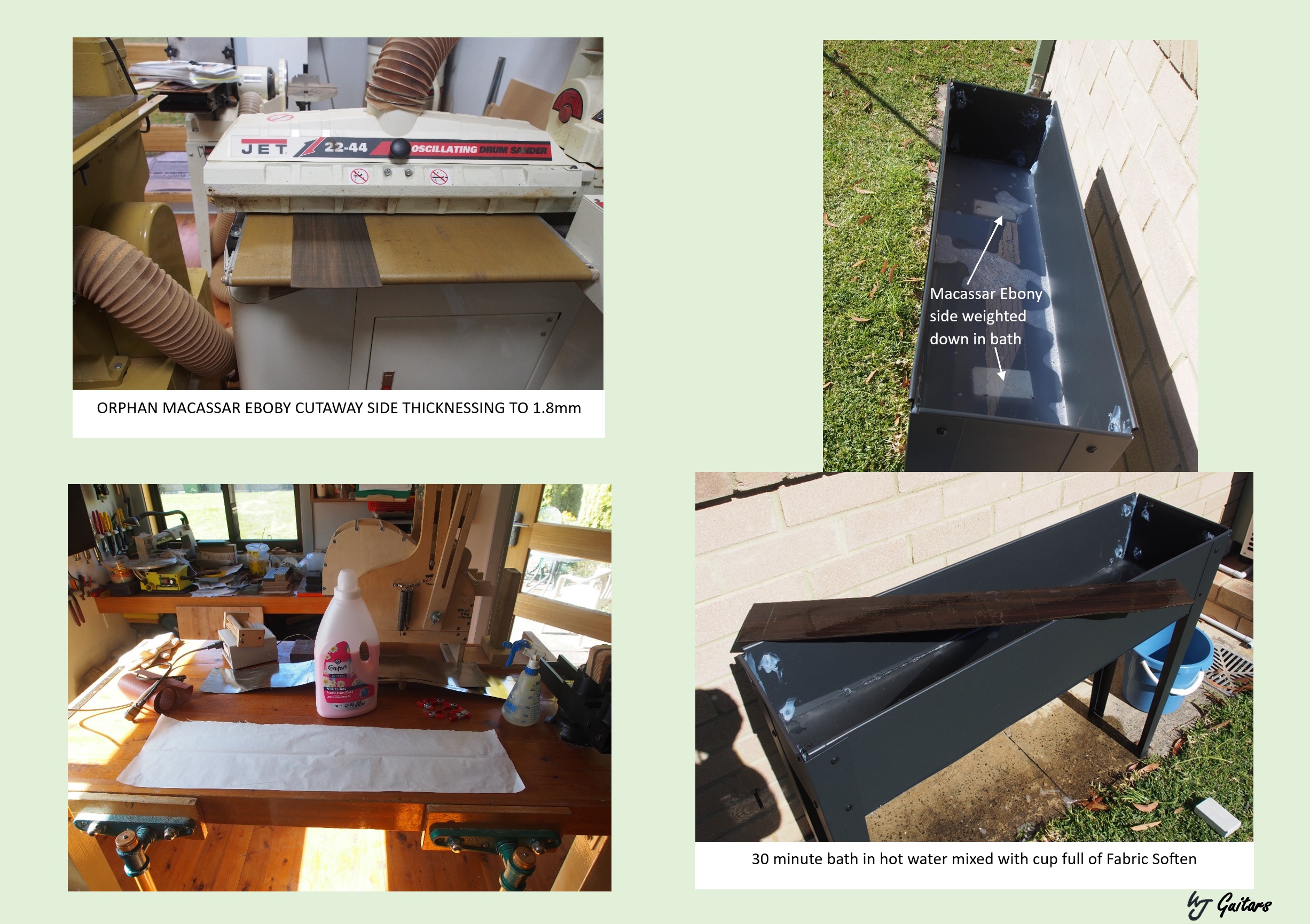

But what I can offer that would be useful here is to soak the sides in a hot water with a cup of fabric softener for half an hour. Enough water to cover them, then weigh the side down so it doesn't float about. Wrap in baking paper and bend as normal.
For ebony, I'd be taking the whole side down to 1.8mm. And it must be sanded to 1.8mm, not planed.
Thanks Nigel for the information. I have been able to source orphan Macassar Ebony sides and I will use your method with a test run first.

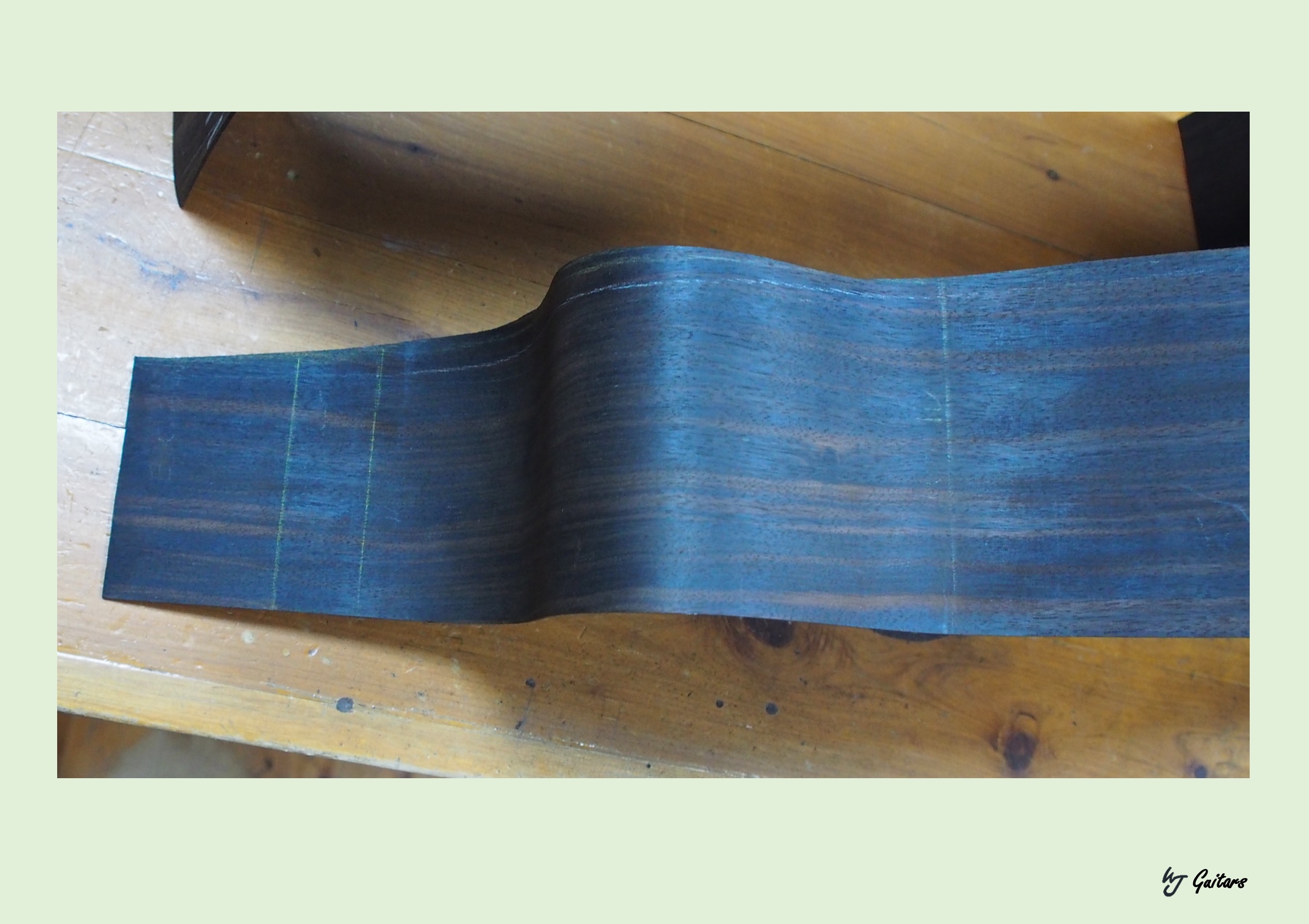

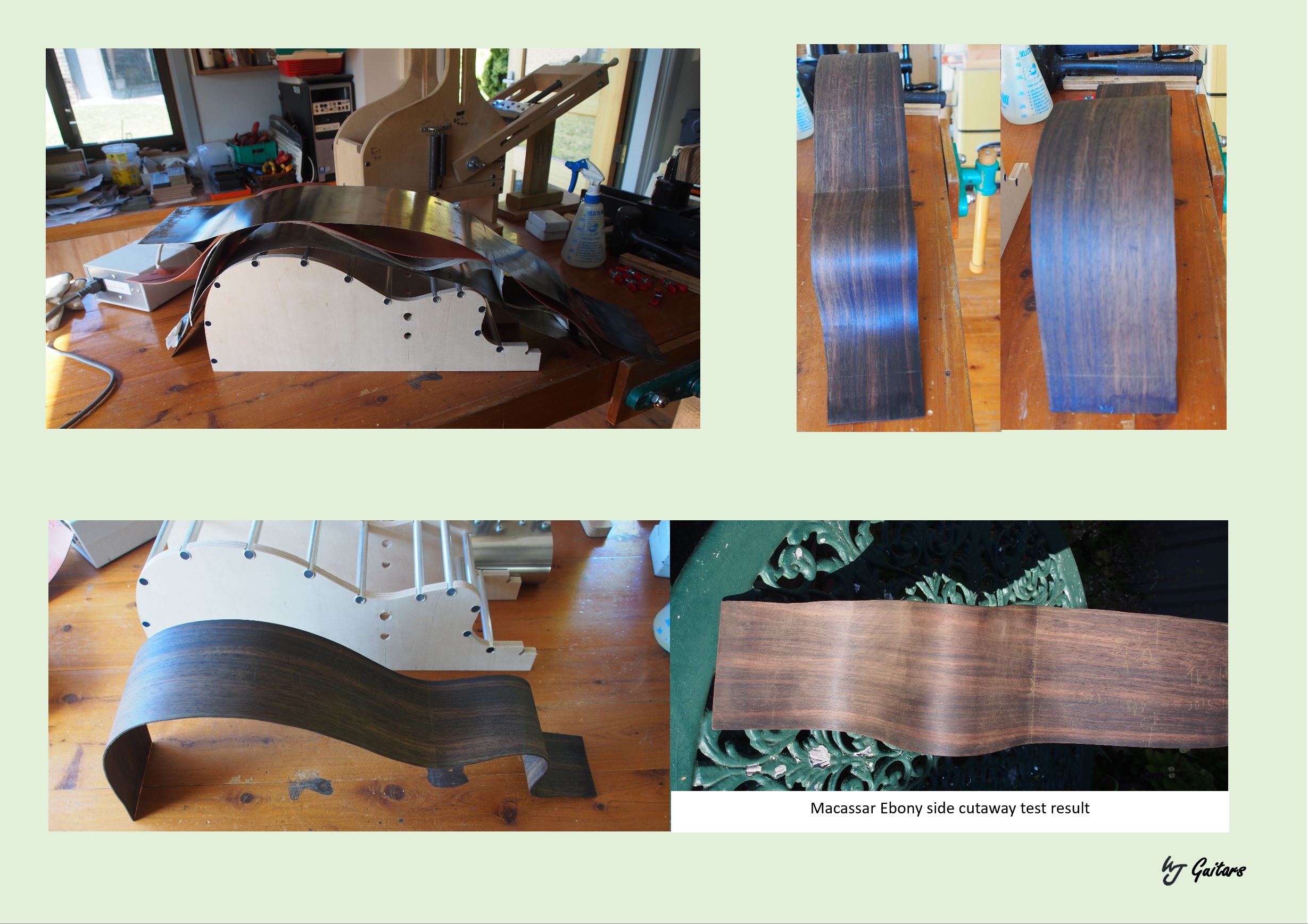

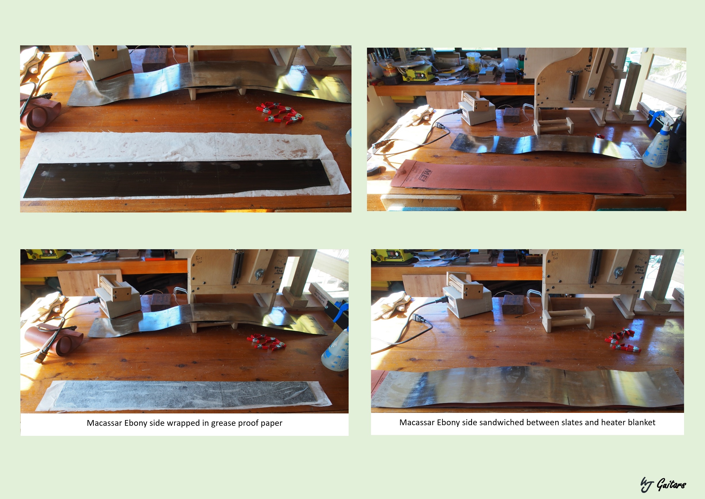

After receiving an orphan Macassar Ebony side I have now been able to made a test cutaway side bend. I followed Nigel and Wayne's instructions and all went well. See photos below. I now am more confident to bend the Macassar Ebony set sides for the Parlor guitar build.
Posts: 10878
Re: Bending Macassar Ebony sides at what temperature?
Post by kiwigeo » Tue Aug 05, 2025 8:21 pm
Looks like that all went well. Now you just have to find a customer who wants half a guitar :mrgreen:

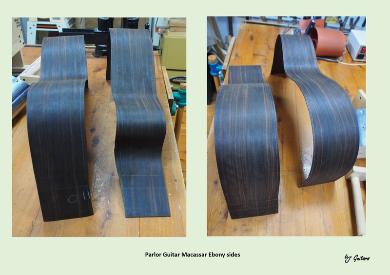

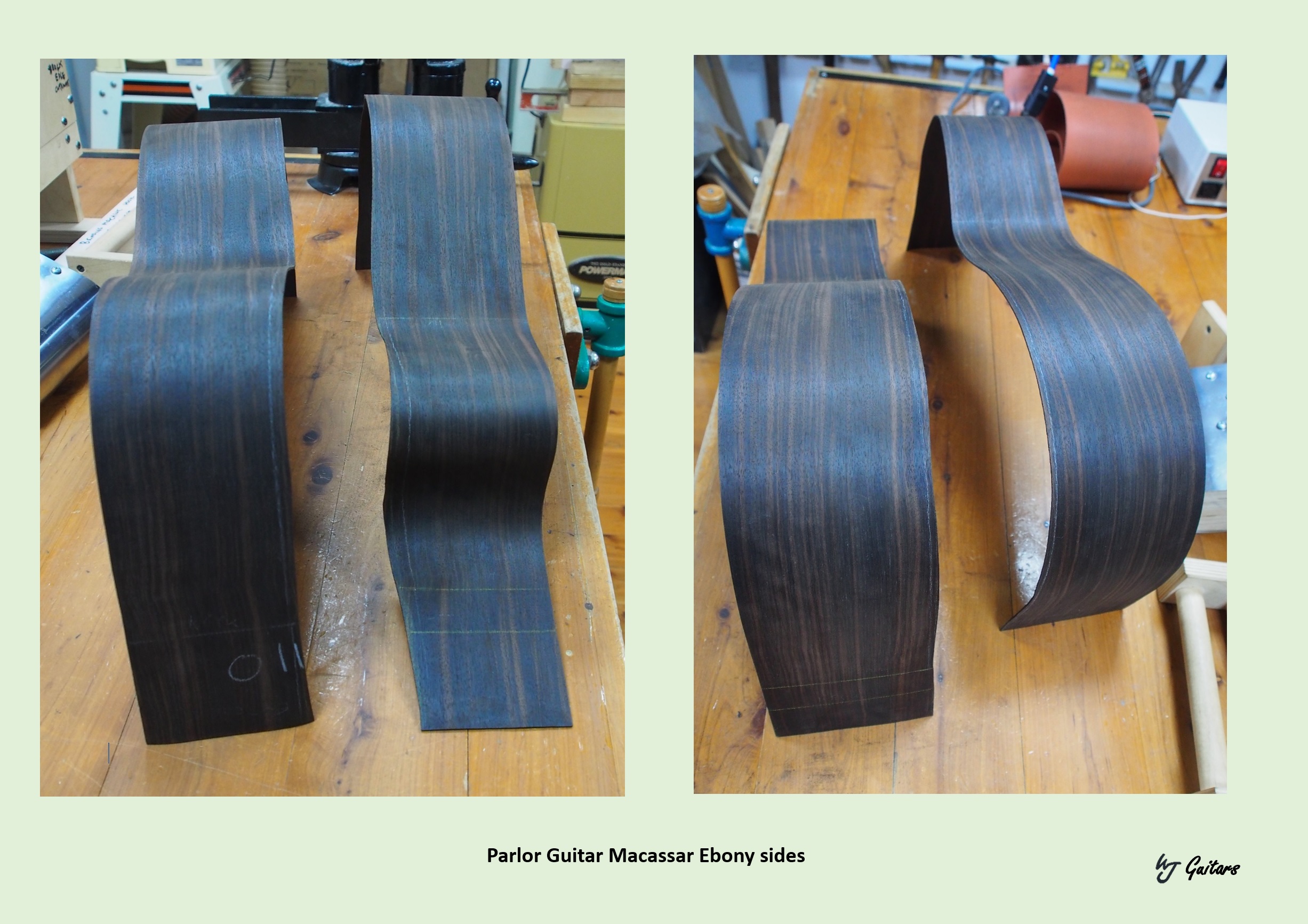

I have now completed bending the Macassar Ebony sides set for the Parlor Guitar builds with no issues. See photos.
Yes all went well and half a guitar on the way!? Imagine the possibilities.
