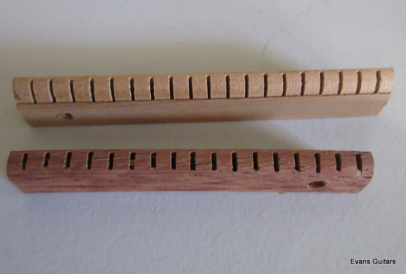

Hi Alan, I only used the laminated side option due to making a blooper on one of the sets of sides, so, as not to waste them, I used one set as a lamination. I would sooner stiffen the sides using both a “boxed” Kerfed binding, as shown here, and heavier side reinforcement. The kerfing shown adds a lot of stiffness to the sides.

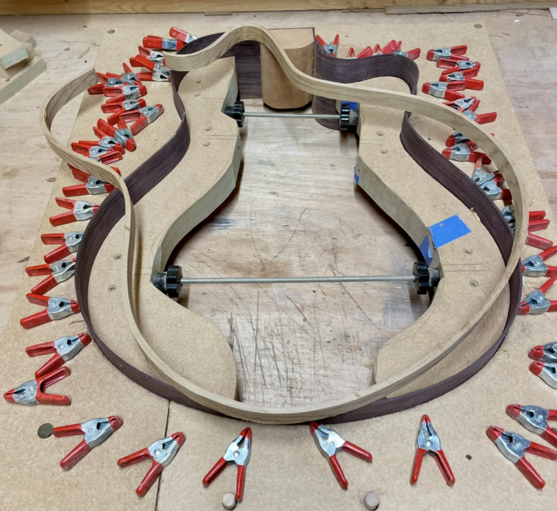

This is my lining, super stiff when glued in place.
