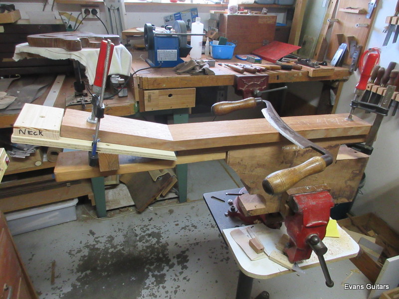

Post by Taffy Evans » Sat Jul 12, 2025 2:13 pm
Hi, I use or have used all of the above, and most times, a combination of tools are used. The only knife I have used is the one in the photo. It would be what I use the most along with the japenese rasps.
Neck shaping.725.JPG (146.31 KiB) Viewed 31 times

That’s a heckuva knife, Taff! Martin, I feel the same way about shapers. It’s the ‘turbine spinning up’ noise when you switch them on that makes me nervous.
