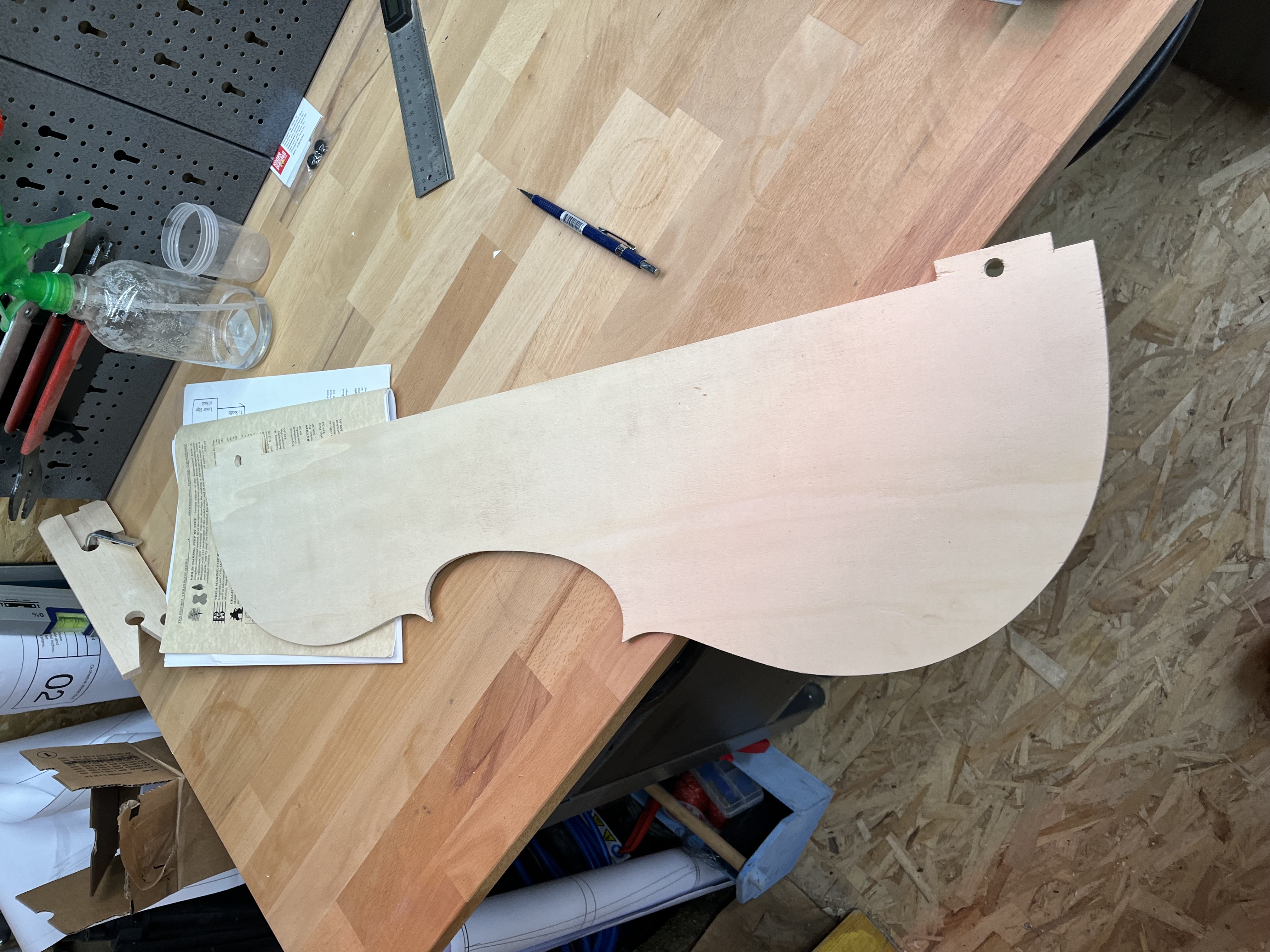

creating templates and the inner mold
the inner mold
thicknessing the ribs down to 1,7 using the safety planer
bending the first c-bout
first center bout installed..

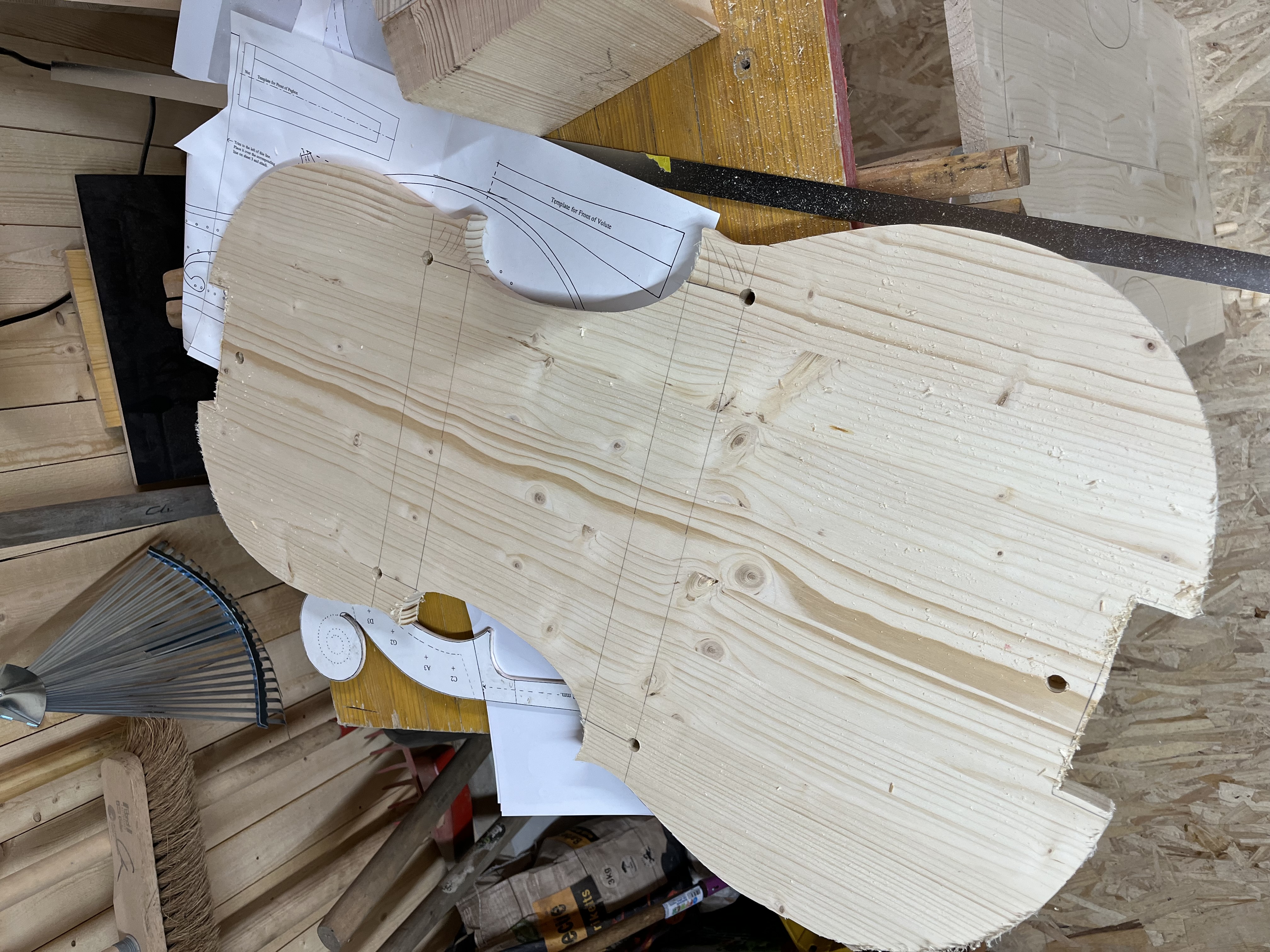

...small update from my work on the top,
also I added some fotos of the raw wood before starting my work
