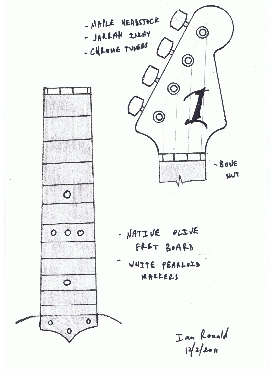

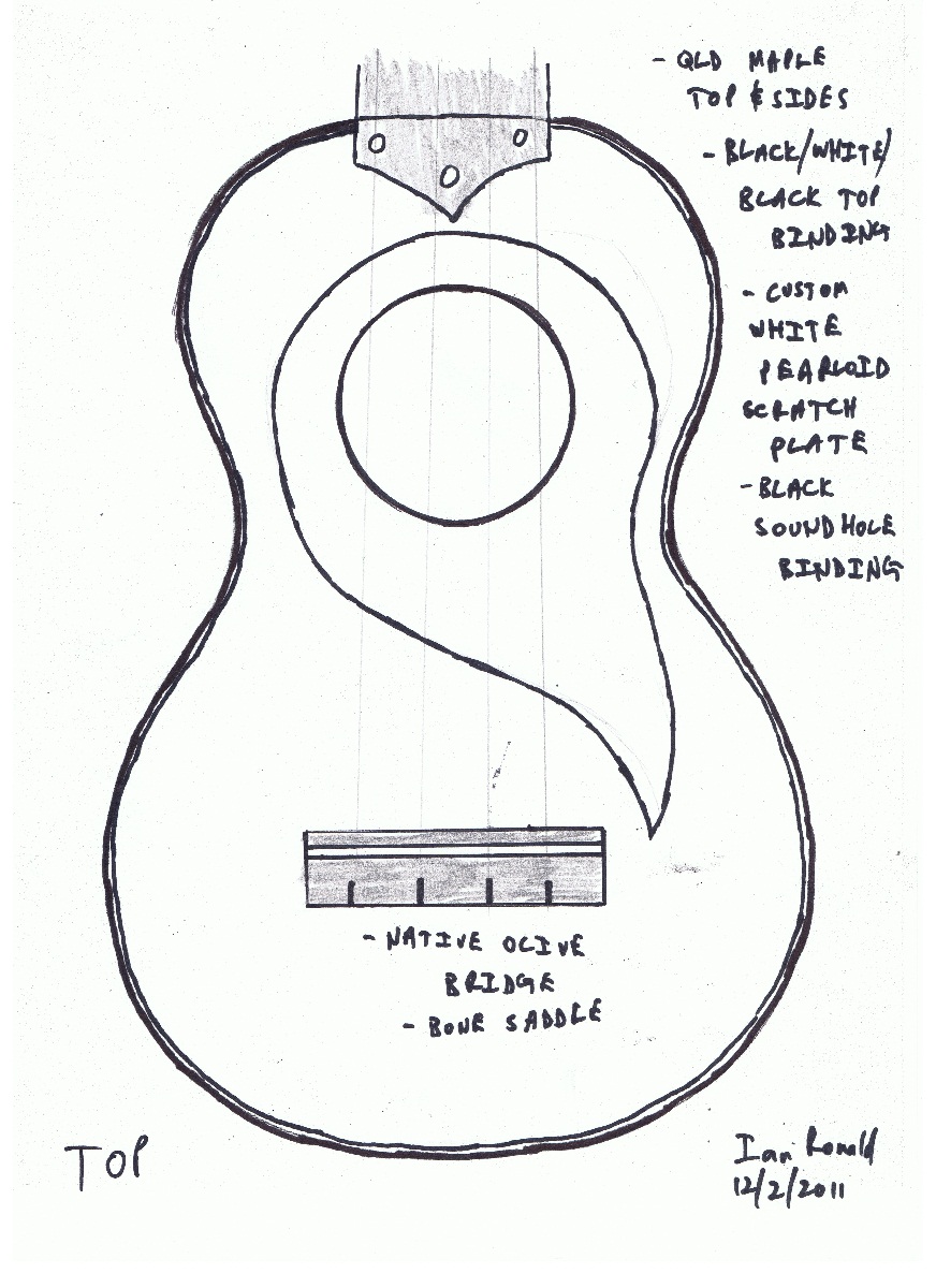

Here are the design drawings. The brief I had was "Make it rock & roll but traditional"
I kept it to mostly natural timber finishes (there's some stained veneering on the back) with some rock motifs, such as the custom scratchplate/pickguard and the "Strat-style" headstock.
Keen for any feedback!

With that sort of design I might consider going with a pinned bridge. That tie bridge looks a little out of place to my eye with the tele headstock.

Yes - I think you might be right!Allen wrote:With that sort of design I might consider going with a pinned bridge. That tie bridge looks a little out of place to my eye with the tele headstock.
Good call...

Now, this may be a stupid question, but how critical is the curved back on a soprano ukulele? All the plans I have found so far seem to have a radius on the back, but many of the actual ukuleles I have looked at have a flat back. Given that I plan to veneer over the back of this uke, a flat back would be much easier to work with...
Am I seting myself up for trouble?

Absolutely critical mate.
No, really. You can build it any way you like. The backs are so small that even a 15' radius really doesn't show up as much when the instrument is together. I would still be putting some radius in there as it's insurance on keeping the back in one piece when the humidity drops and everything shrinks on you. But if you are doing a bunch of marquetry it might end up being a bit like plywood and would hold together no mater what.

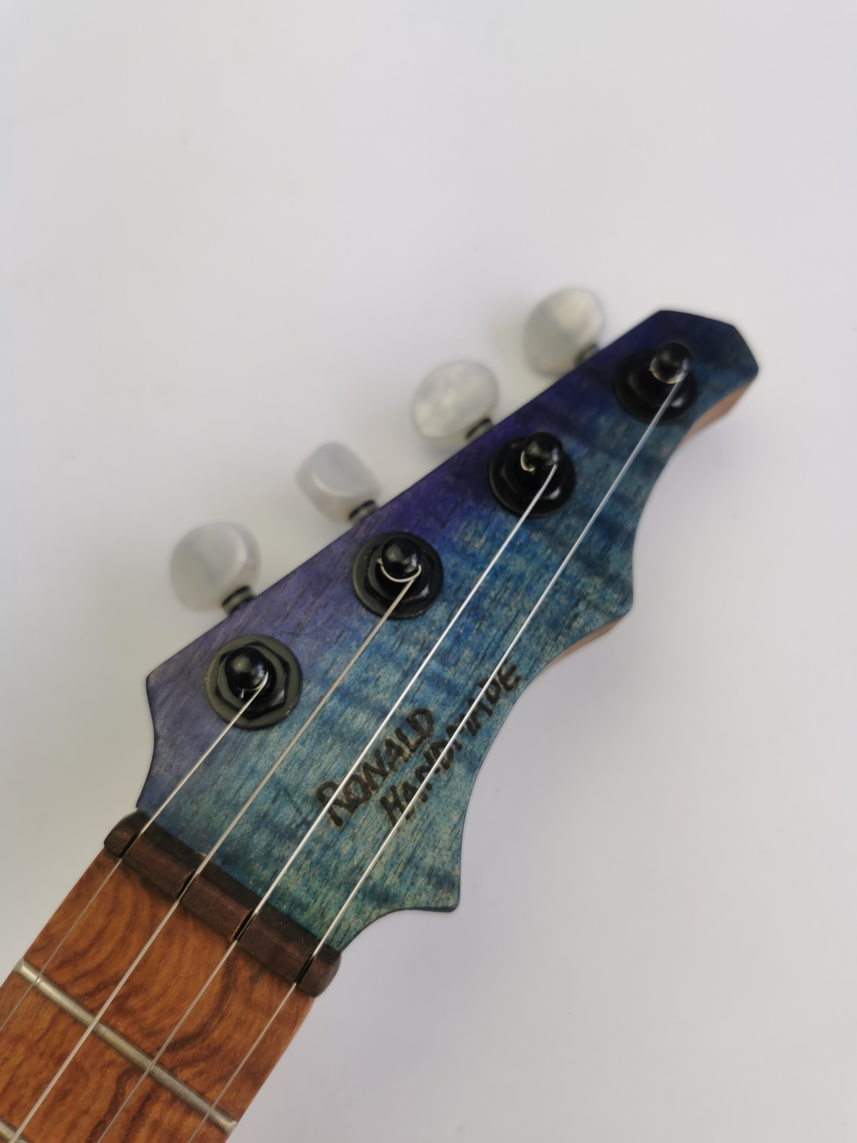

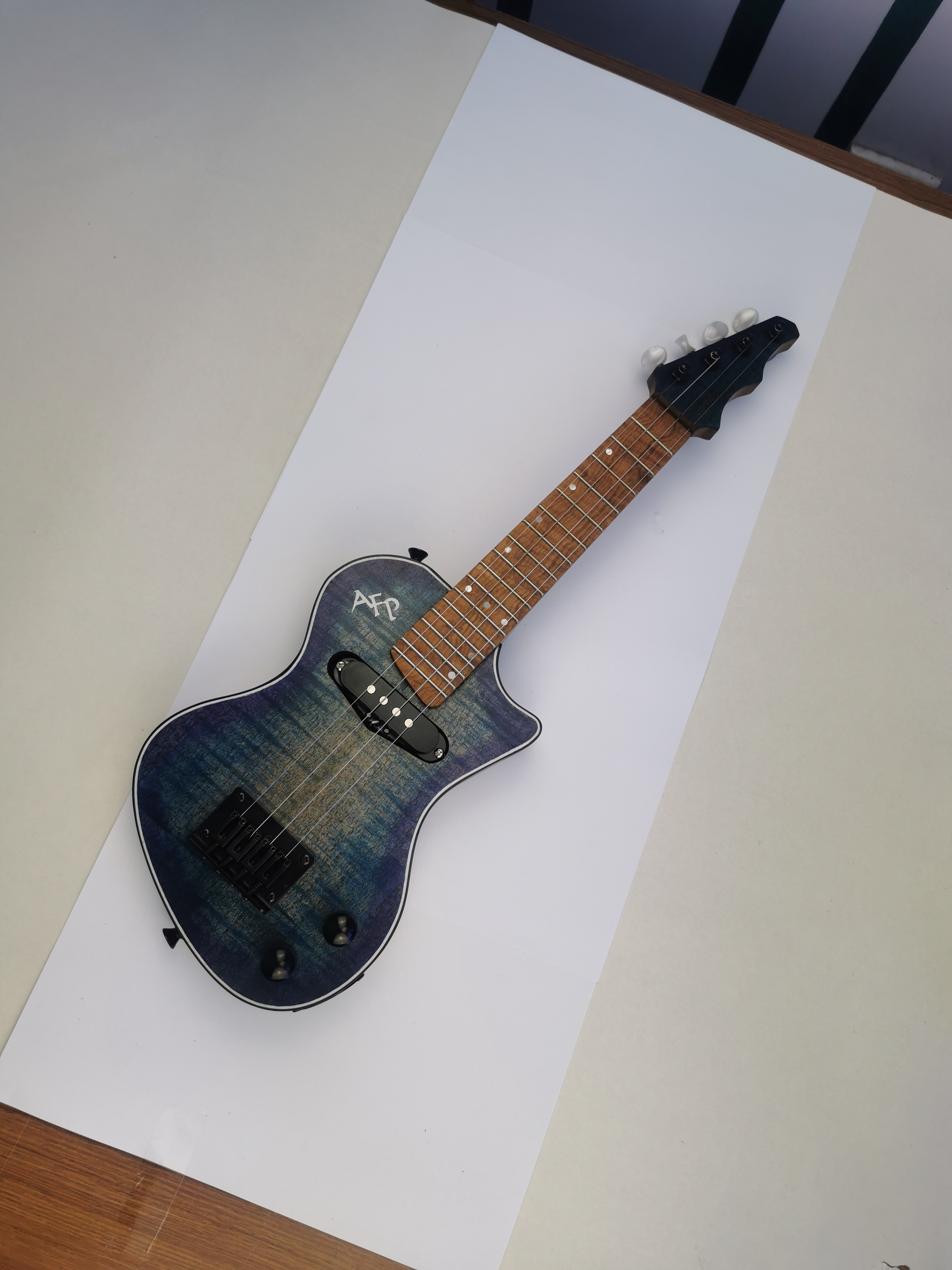

So...
Almost 13 years to the day after promising this ukulele, I delivered an instrument in February of this year. It was almost entirely different to what I had originally planned, and was, in fact, a solid body electric uke instead. Thankfully, she loved it, and was quite understanding about the delay!
More detailed specs in another post viewtopic.php?f=25&t=9735
