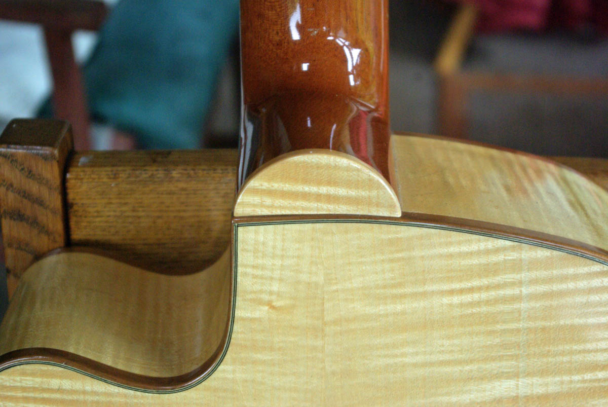

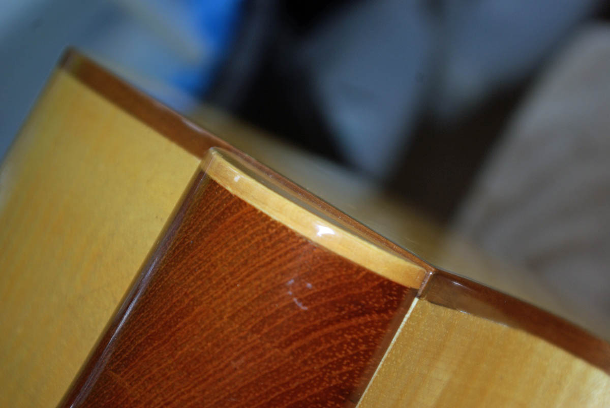

Post by Dave M » Thu Aug 08, 2024 8:38 pm
Like this:
bernm
Posts: 63
Joined: Wed Jun 11, 2008 8:44 am
Re: Classical Build - Toscano Guitars Intensive
Post by bernm » Thu Aug 08, 2024 9:07 pm
Like this:
That looks great! Thanks for sharing - I'll keep that in mind for the future.
